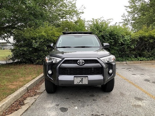

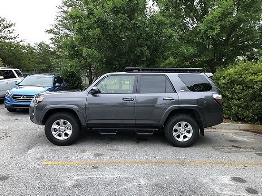

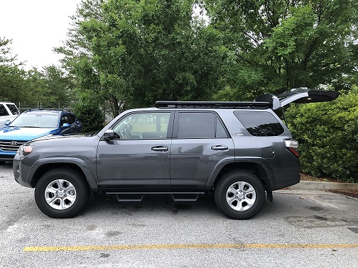

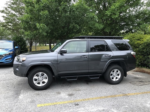

Finally got it installed. Pic is too big to upload. I will have to do it from my pc tomorrow. Installed per directions and the rear door does not open. Turned the platform around and the rear door opens perfectly. 4 points of contact. I will have to drill the platform to take advantage of the middle mount.
Here are the pics. You can't tell the clearance when the rear door is open, but it's about a half inch.
