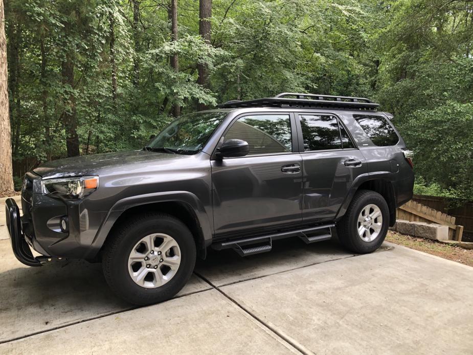

I took your advice. I like them. They are functional AND they look good. Thanks for the recommendation. Now I’m just waiting for the lift kit to come in and then I’ll be done...maybe

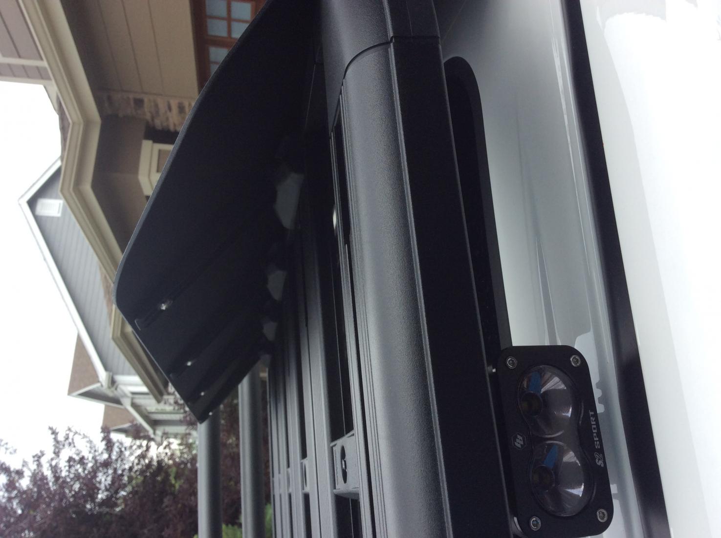

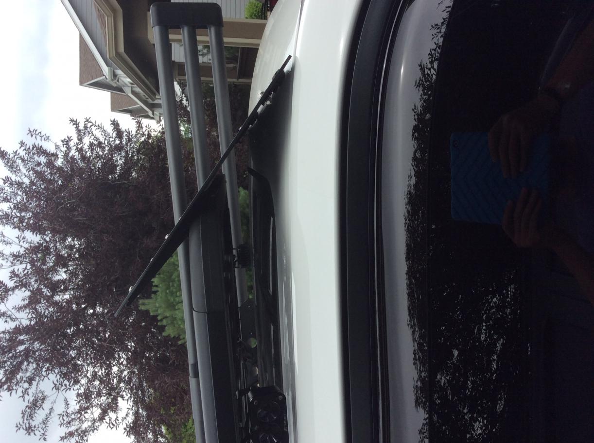

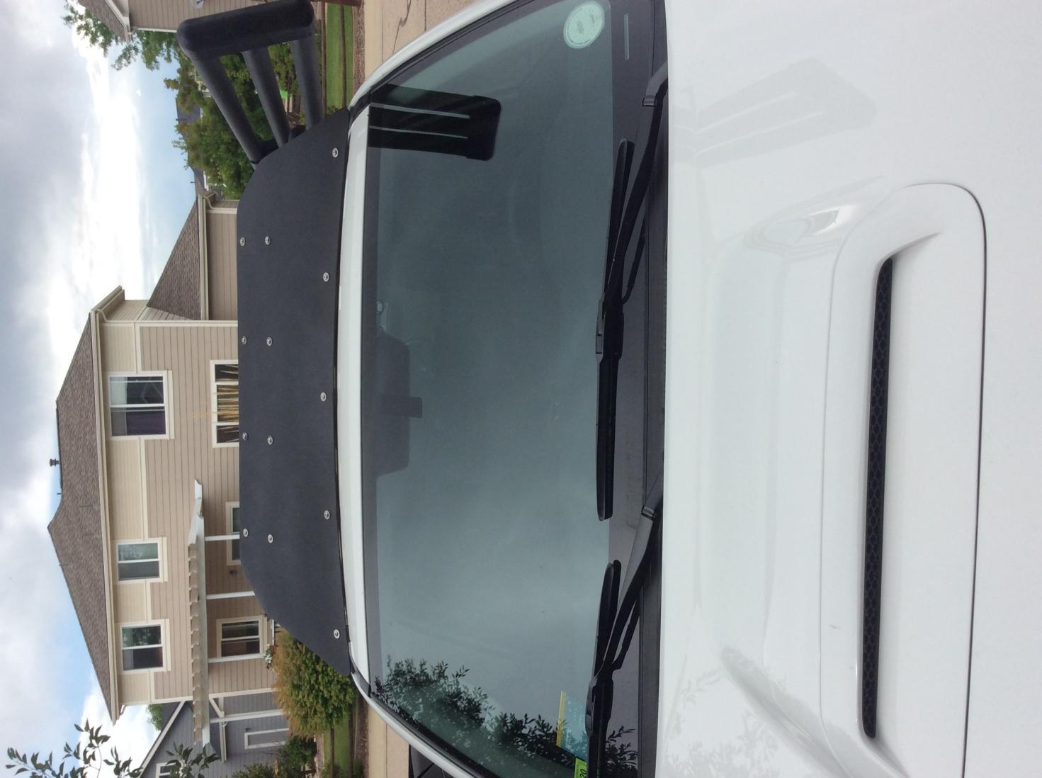

I am wrapping up my custom fairing. I used most of the hardware and parts supplied for the Rhino version (which was a terrible design) and flipped them to the top. Designed a 1/8th in aluminum fairing and had it water jet cut, then bedliner. I have a SS hardware sent out to PCbolts for black powder coating.
Wind noise is drastically reduced, very close to no rack levels. Highway speeds with the sunroof open are no longer an issue. Once I get my RTT I will post more photos showing how it will divert the air over it.

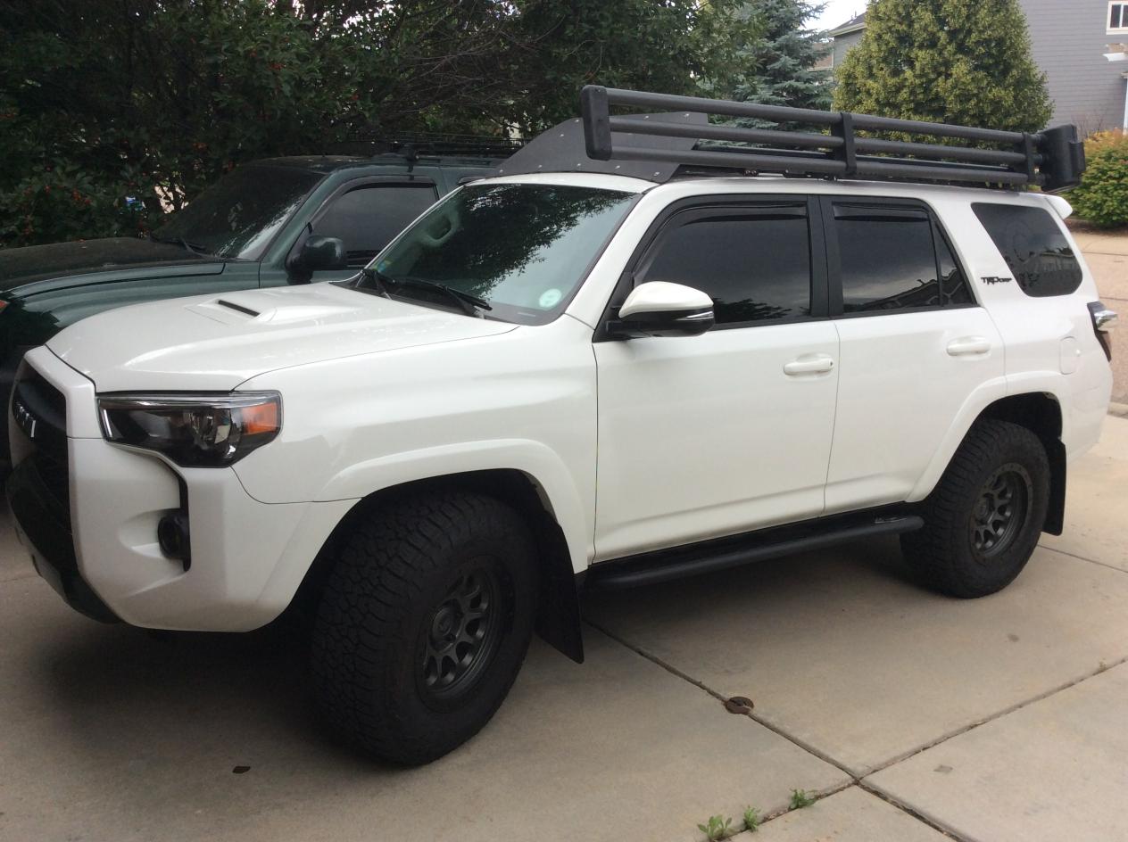

Here is my Rhino-Rack Pioneer Platform. I went with 3/4 length as a no drill compromise for extra storage but still gives me the use of my sunroof. The rack does not interfere with either the rear shark antenna or the sunroof opening. Pics are bare and then loaded for a recent Overlanding trip. No change in MPG or wind noise over the standard roof rack.

I really like this rack. It does not interfere with the sunroof in either the opening or the tilt positions. I have not measured but there is still an inch or two of clearance with the tilt function. There is more wind noise with the sunroof open but I do not notice much of any difference when the sunroof is closed. Fully loaded and even when I walk on the rack it does not flex or defect in any way with the added weight. The rack is strong and meets my needs of the RTT and additional fuel and water storage on longer trips.
