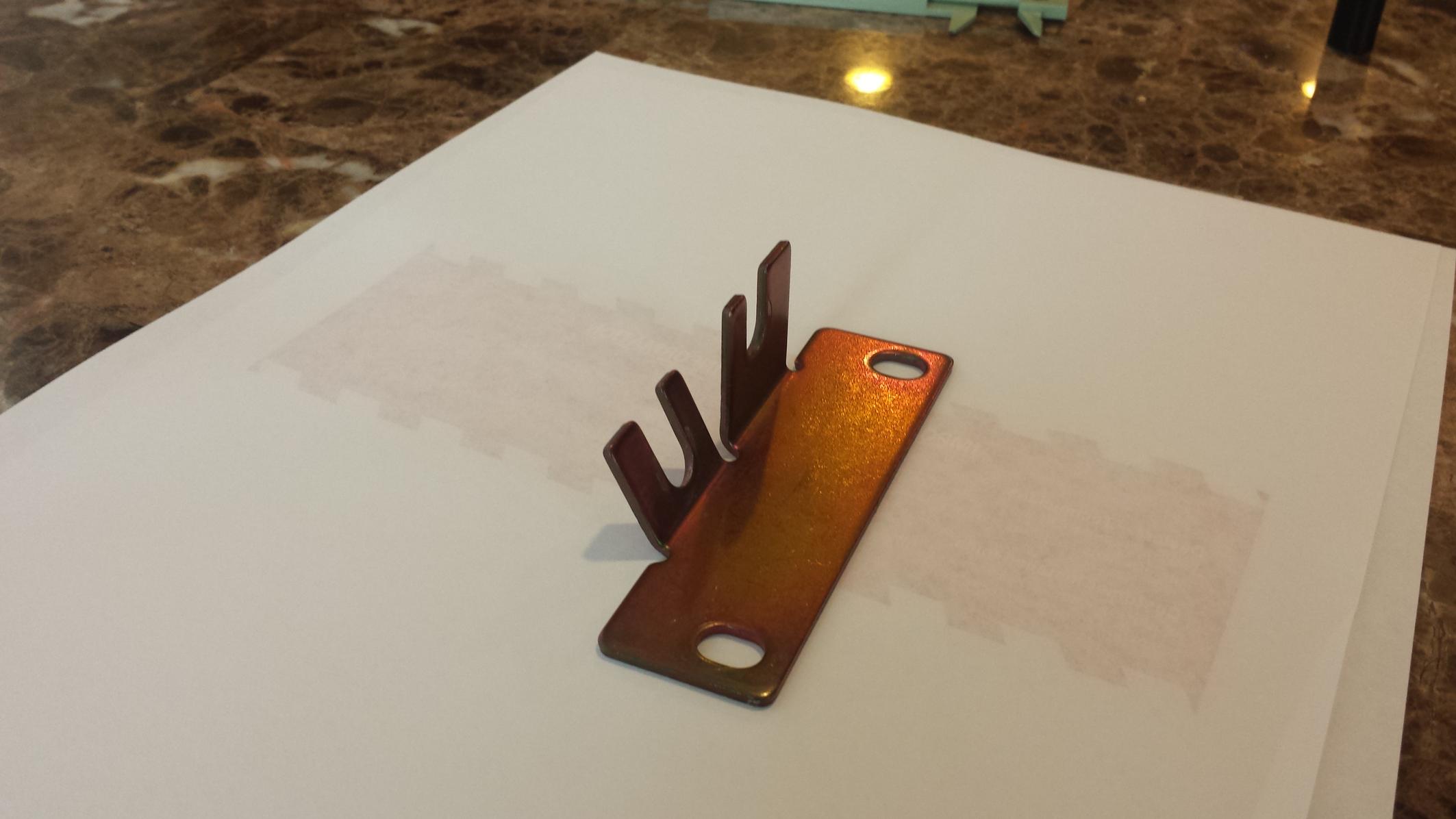

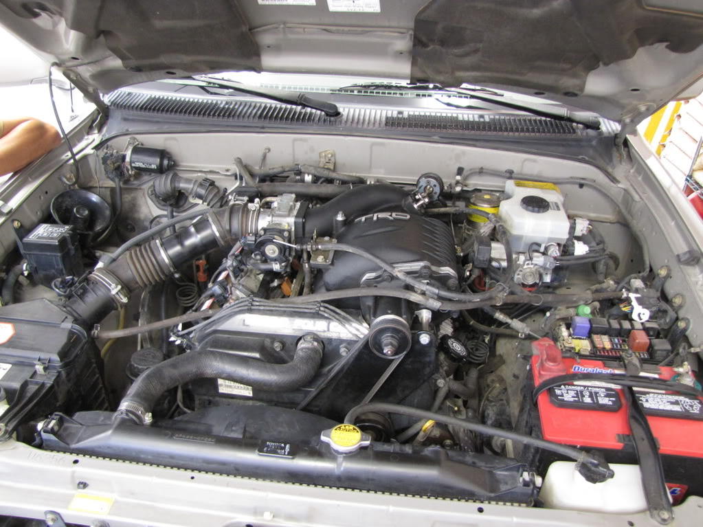

supercharger throttle bracket
Hey Ripcord
I have a question about your old build if you don't mind. I'm installing my supercharger 2002 and have the bracket with the two prongs on it.
attachment.php
It looks like you did too.
attachment.php
Did you bend the bracket to make it fit?
What did you bend it with?
Did it take any heat to get it to bend?
Thanks in advance

Pliers. I recommend trying to find the single spot bracket if you can, I don't know where to find it though.
