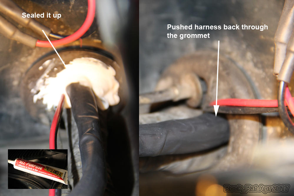

OK so I spent about an hour repairing my leak. Had it all done before breakfast. A couple things first.
  1. BAD decision to use braided wire loom inside the engine bay where it's going to be exposed to the elements or potentially enter your rig.
  2. Awesome forum to help me get back in line. [MENTION=99565]kolelt[/MENTION] - bravo

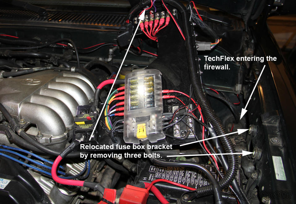

  3. I love my fuse box mount. It took three bolts and one zip tie to re-locate it out of the way. Freaking awesome since this was the first time I had to move it. It passed the test.

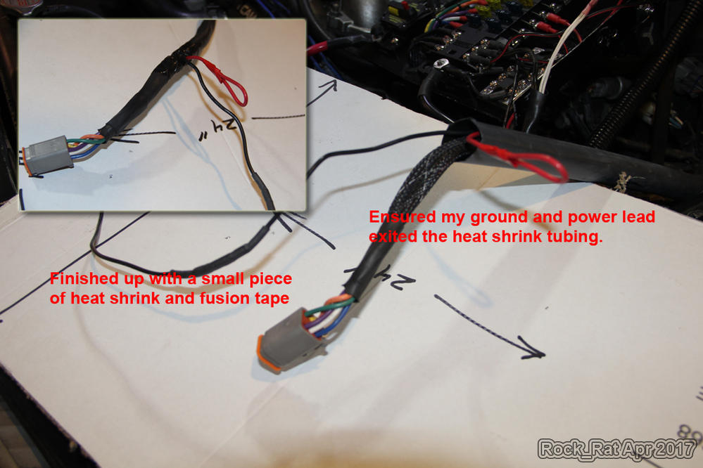

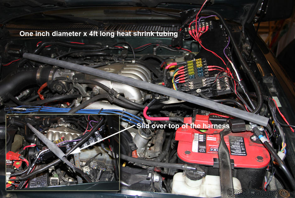

OK so my leak is repaired now. I opted to go with a 1" diameter x 4 foot piece of sealed heat shrink tubing.

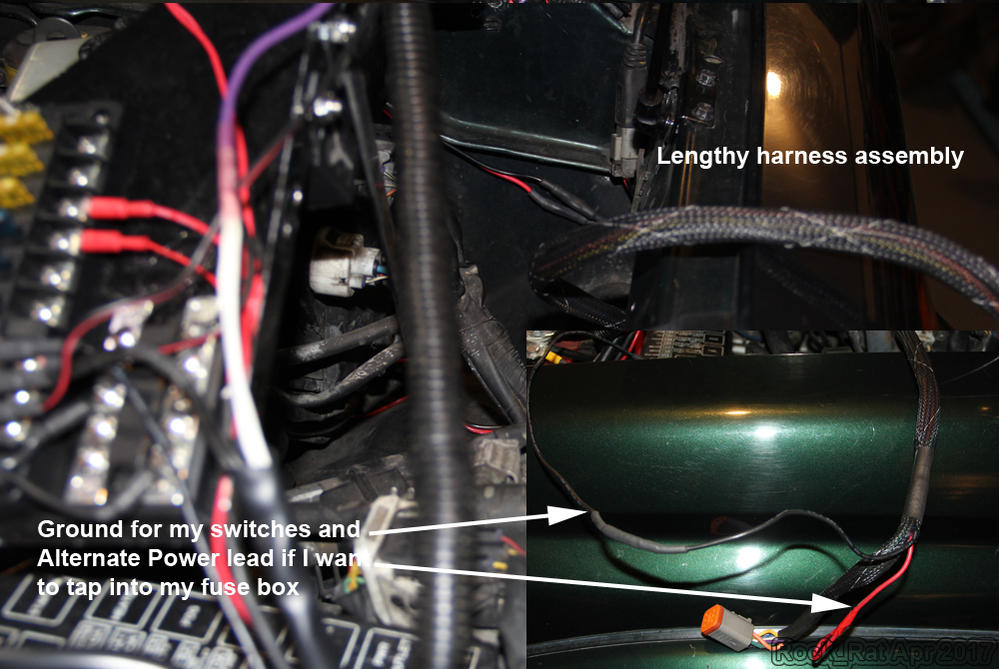

  1. I made my harness long enough to give me different options in the engine bay so all I did is disconnect the Deutsch connector and pull some extra through the firewall.
  2. Slid the heat shrink tubing over the assembly ensuring my negative wire for my switches and my alternate power lead were exposed.
  3. Once complete, I pulled the harness back through the firewall, finished off the top half of the harness with a another piece of heat shrink and fusion tape.
  4. Finally, I used some "All-Purpose Adhesive Caulk-in-One" around the grommet. (It's what I had laying around the house - may replace later on if it doesn't hold up)
Thanks to [MENTION=99565]kolelt[/MENTION] for his timely input to my initial post! I Owe you! :hatsoff:

Good job bud. Glad I could help. I know how annoying it is to find water in your truck lol. Glad it all worked out :)
