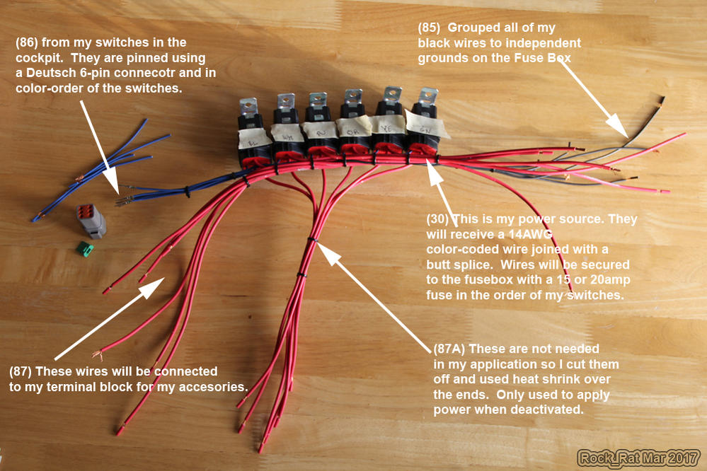

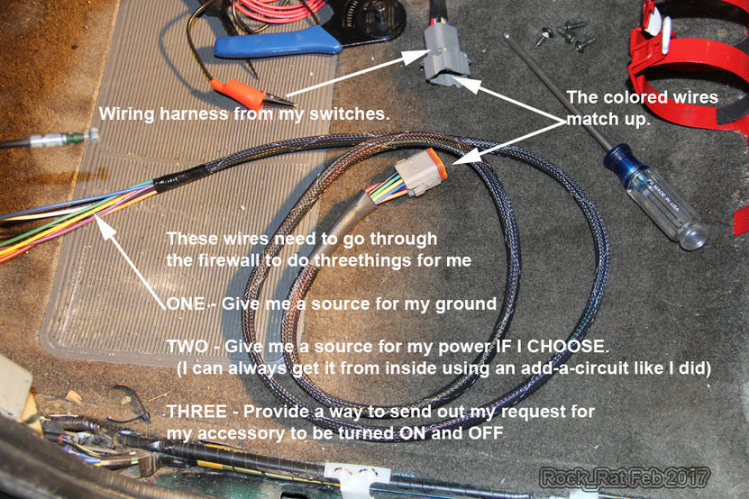

Ok so you know I built a harness for my switches that run from inside the cockpit area out to the firewall. Here's a few pointers:
Splice in a hot wire and a ground wire into your red and black wire ion your connector. Those two wires can stay inside the cockpit area and be used as needed to power up your light switches.
Once you have your harness pulled through the firewall it's time to work on your secondary power supply system to power up your various accessories. I'm going to post up a few more photos but then I need to quit for the night.
IMPORTANT NOTE: Although I changed them for the video, it's best to wire your fuse block and your terminal block in the positions of your switch. My Blue wire should be in position six and the purple wire in position four. Does it really matter? No. If you have OCD - Yes. Might as well do it right the first time.

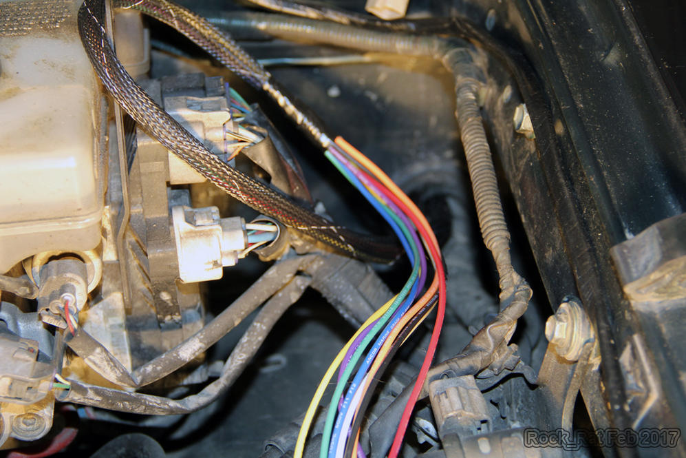

IMPORTANT: This is an after-fact-note LESSON LEARNED! DO NOT USE BRAIDED WIRE LOOM INSIDE THE ENGINE BAY THROUGH THE GROMMET. YOU WILL EXPERIENCE A LEAK INSIDE YOUR RIG. Please see the repair I made in the following post. Leak Repair This would be the correct way to install your harness. Water coming off your windshield will follow the path of least resistance down your wires and through the firewall.

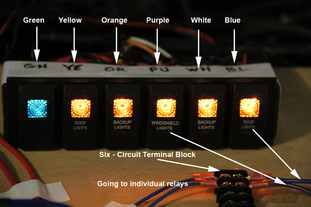

Notice how each switch is labelled for this tutorial only. I'm going to be using the Purple and the Blue wires - switches four and six from left to right. For this tutorial I made two wires with pins for my harness. I'm also using a terminal block for six circuits. It's rated for 20AMP's and will suit my needs just perfectly. Most terminal blocks are on the other side of the firewall. The light blue wires connected to the opposite side of the terminal block go to the relay. This is where all the magic happens. We'll talk about relays and terminal blocks later.
You've seen this picture previously. Keep in mind I still need power and ground for those cool looking daisy chains. I also need to send my switch request somewhere.

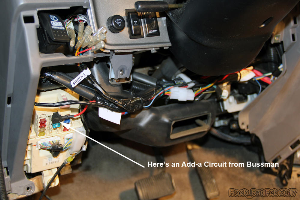

Final picture is a photo of the add-a-circuit. Basically there's an additional wired fuse that taps off the same slot for the accessory circuit breaker but has an independent wire and breaker.

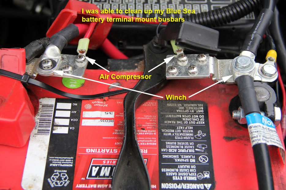

I ran my ground for my switches to the Blue Sea Terminal Mount Busbars and power for the switches was tied into my JB fuse inside the cockpit. My accessories (all two of them) were powered through two 40A Hella Relays via a 15A fuse mounted inside my driver's fender, and ran both lights off of a Blue Sea 20A Terminal Block.

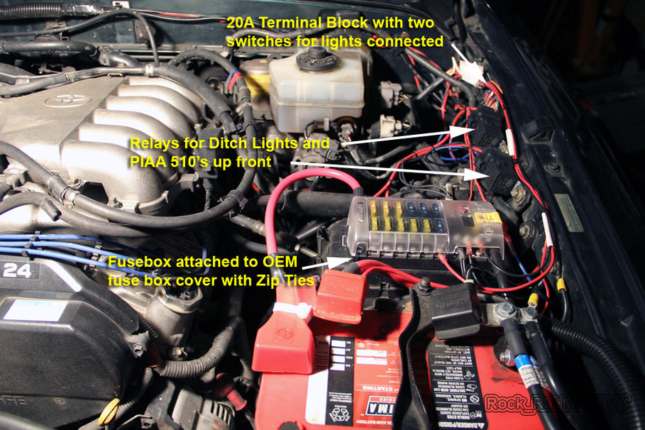

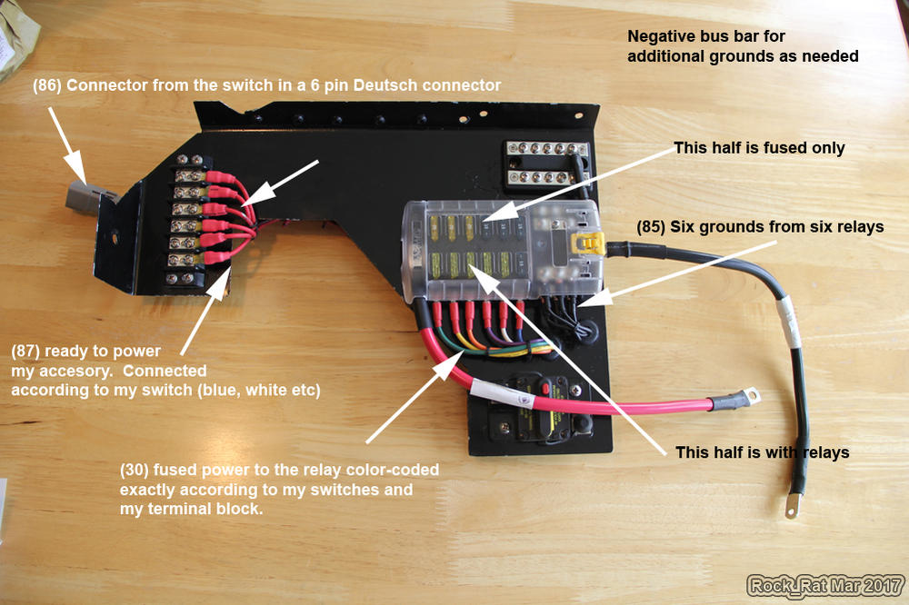

I spent a lot of hours researching the way I wanted to use my available space inside the engine bay and gleaned some great ideas from [MENTION=135677]michaeljtomey[/MENTION] [MENTION=7992]Ripcord[/MENTION] and there was another individual in Tacoma world who used Lexan. (I failed miserably at the Lexan attempt! It was perfect until the heat gun got a hold of it.)
So anyway, here's my "Secondary Power Distribution Assembly."
My own Thoughts as I approached this Project
  • I wanted to freely access my OEM fuse box cover and reduce the number of wires running off my battery terminal bus bars.
  • I wanted to keep all high voltage components inside the engine bay on that side of the firewall. Relays, Fuse Block, Bus Bars, and terminal blocks.
  • If I use a Bus bar I only wanted to use it for my ground wires.
  • I didn’t want to loosen up myriads of screws and remove wires if I had to perform any maintenance. I wanted to use the Deutsch connectors where possible and secure as much as possible to the mounting bracket. I have 18 wires I never have to disconnect. I do not have to cut and splice.
  • It must be SAFE, clean, and have a professional appearance
  • It had to handle additional accessories without ANY modifications. So when I get that 40” or 28” light all I need to do is cut the wires, splice in a color-coded wire and install.

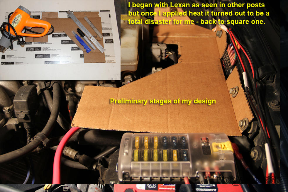

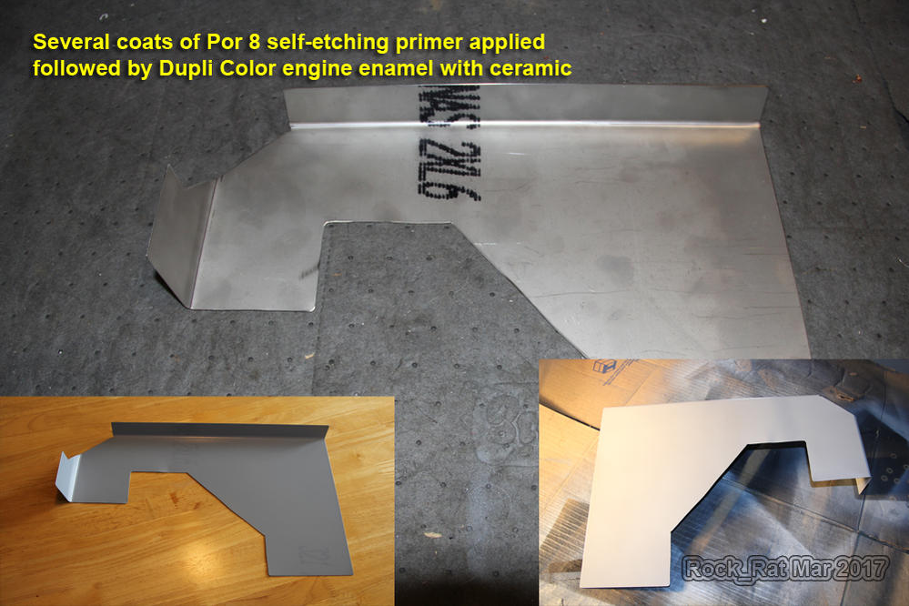

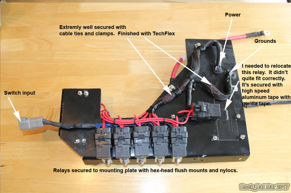

Everything was effective, safe and I'm sure I could have gone forever with the existing setup. I did attach my fuse block to the OEM cover using small zip ties for safety. I've seen folks use hardware there but I didn't want to risk the potential of having a nut come off and shorting my electrical system. I'll replace the cover later on. It was time to upgrade and clean things up a bit.

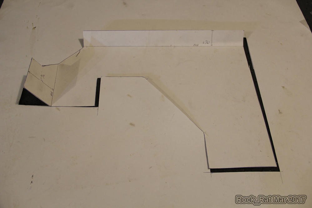

Using cardboard, I played around with a potential template. Once I was satisfied I went and bought a piece of Lexan and spent hours cutting it out. It was gorgeous...until the heat gun! It looked like a glass blower on drugs got a hold of it. Frustrated it hit the trash - no photo.
After fine tuning the cardboard and playing around with the components and looking at all the google images I could I finally settled on this pattern utilizing the existing hardware.
So I brought it to work and grabbed a piece of stainless steel, cut and made the bend. I had top keep the bend to just under 90° to go with the contour of the fender. Using multiple layers of self etching primer by POR 8 and Black Dupli-Color Engine enamel with ceramic I was finished. I still didn't drill any holes yet.
Next I was determined to tuck my relays away somewhere in the drivers fender area. After much consideration I realized that if I bent the mounting tabs up and picked up some very small flush hex-heads with nylocs I could actually mount them on the bracket underneath. First came the grouping of all the wires on the relays. The wires and relays needed to correspond with my color-coded wiring for easy troubleshooting etc...

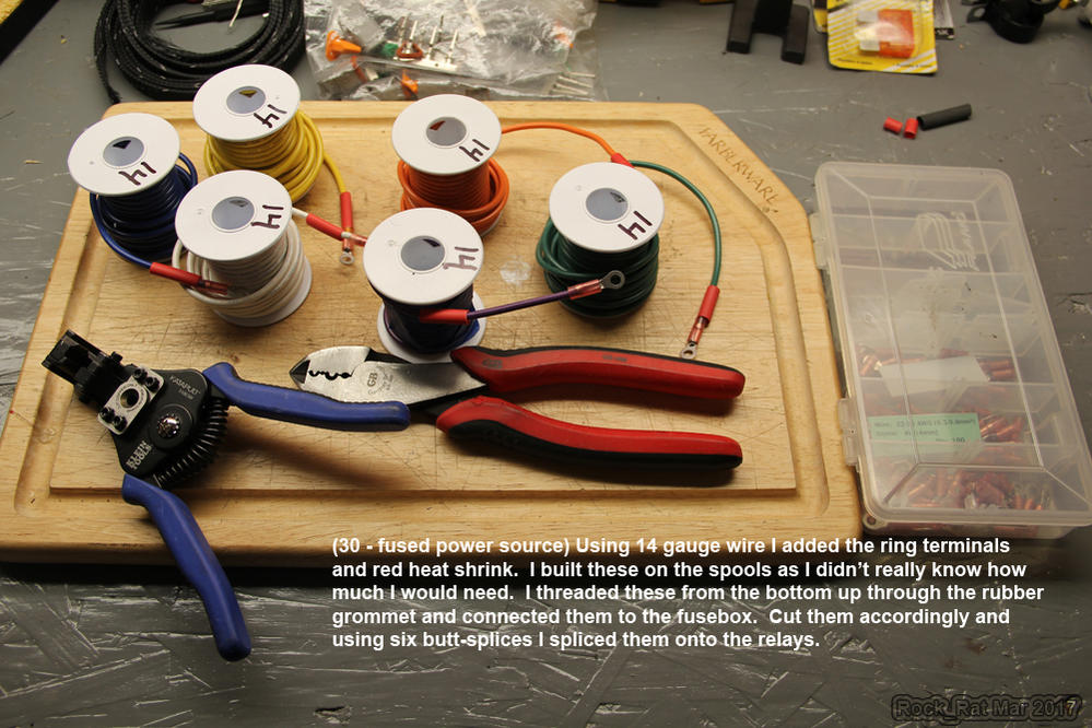

I wasn't sure how long I needed my 14 awg wire to be so I added the ring terminal ends and heat shrink with the wire on the spool. I then threaded the wires up from the bottom through the rubber grommet, connected them to the fuse block and began the process of splicing them into the (30) wires on the relays.
I also decided to utilize independent grounds instead of splicing them all together. If I have a bad relay, it will be much easier to replace in the future. As you can see only half of the fuse block is running through relays. The other half is just fuses for engine bay lighting and other low voltage type lights. I had a dual busbar (pos/neg) but a single ten circuit bus bar would have worked just as well. You can see one additional hole where a sixth relay was originally mounted. I had to move it because it just wouldn't fit very well.
The bottom of the mounting bracket is pretty classy I think. Everything fits extremely well. I did move one relay out of the way and used "speed" tape to secure it to the bracket. The Deutsch connector is the perfect size, relays are very secure. Everything is clamped and extremely tidy. You can see where I cut the 87A wires and used heat shrink over them.

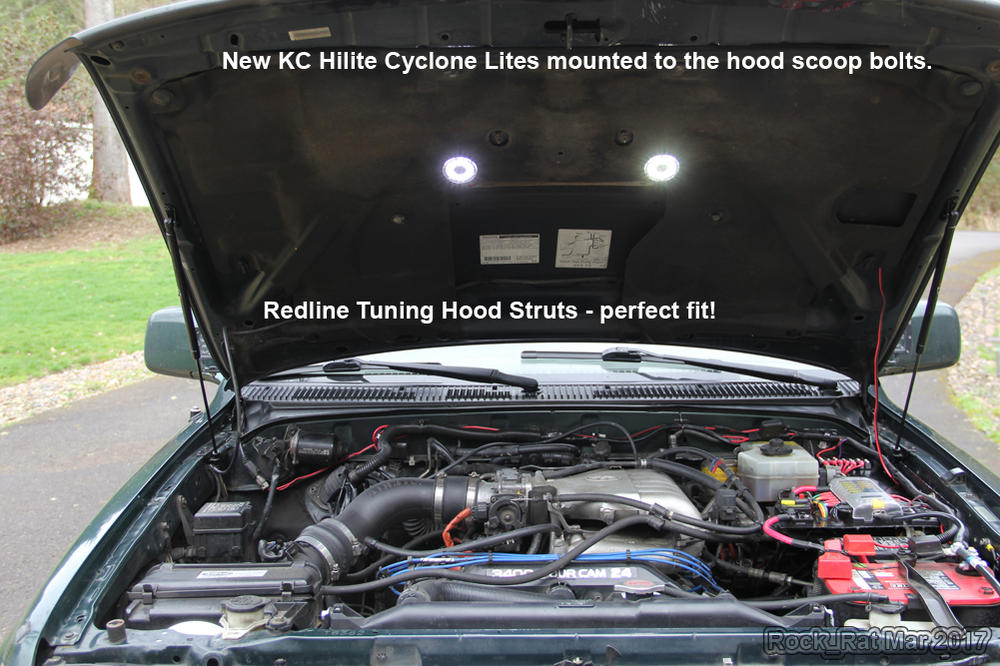

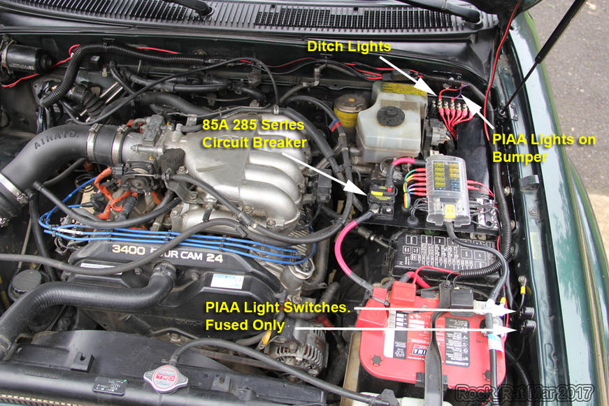

The final photos give you an idea of the room it takes and how much more tidy the engine bay looks.
The only things I have running off my battery are my winch and my air compressor.
During my installation my RedLine Tuning hood struts arrived so I was left with no option. I had to install them first. AWESOME MOD!!! Because of the struts, I needed to cut a small "V" in my mounting bracket. Nothing a dremel couldn't fix.

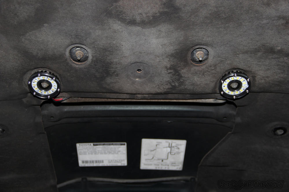

I also picked up two "Cyclone LED Light - Black - PN#1350" for the engine bay. The KC website shows 511 lumens each. They mount PERFECTLY on the hardware used for the hood scoop. At 400 lumens each, they provide plenty of light in the engine bay. I was able to run the wires through the insulation and wire them to a PIAA switch I no longer needed. Another great inexpensive mod. I have no problem with the wire hanging down where it does. My other option is to relocate the switch closer to the firewall.
It's pretty neat to just hit your switch for light under the hood and not having a hood support rod in the way.
Nice tidied up terminal mounts.
The new Fuse Block mount fits perfectly in a 2001. Plenty of room to work around it and I still have the ability to remove it without cutting wires or undoing a bazzilion screws.
Awesome work. From experience. I have the same wire loom like you have. That braided sleeve. And mine to goes trough that grommet. Becareful for a wet carpet under your feet. Water will go down the windshield. Drip "directly" on top of those wires and travel down the wire inside the truck. Because that wire look, even though it's awesome. It doesn't seal around the grommet properly. Because the wire is under it. And the wire loom is open, as in has pores. So it will get onto the wire loom and travel down the wire. Just becareful. I fixed mine with A LOT LF RTV. LIKE A LOT. to seal the wire loom
