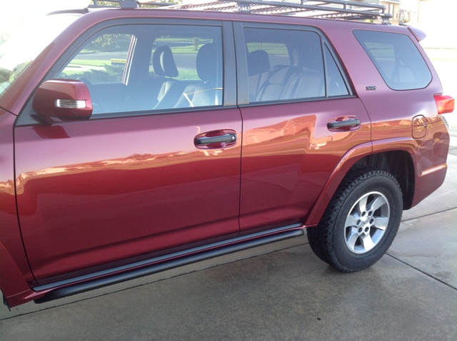

Like mentioned here also, there are some guys doing some pretty clean cut jobs as well.....Here is an example of one of our customers here on the forums.
Nice ride...Uh, that's my ride. Sure no problem - public forum anyways. How about a shout out?
Many changes since this pic but she still looked good - but now even better.

The picture you quoted was a shot of Shawn719's rig where he had cut/modified his SR5/LIMITED rocker trim.
