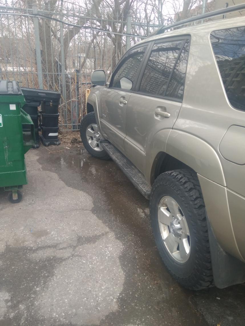

Tire looks flush with fenders, decent looking, I can make some pictures.
