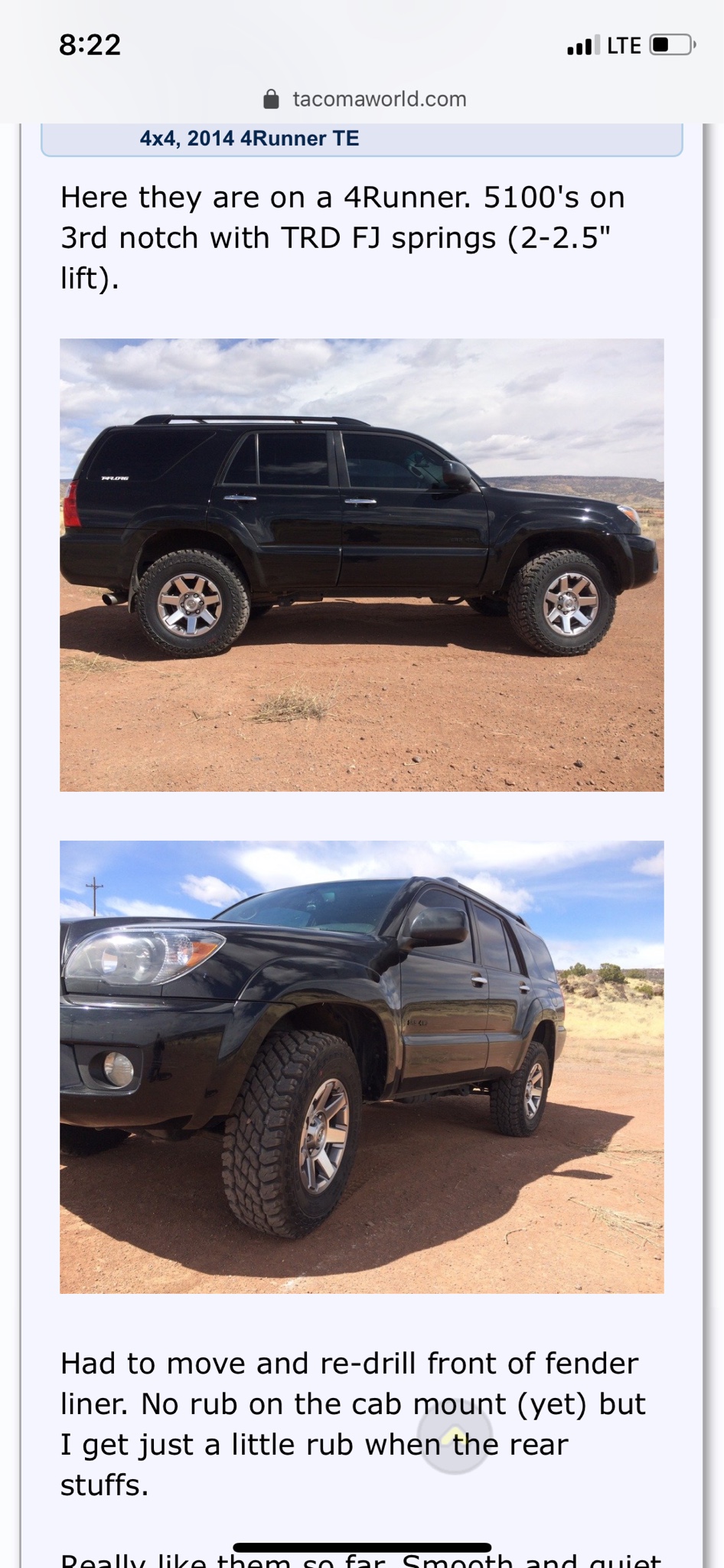

255/80/17 Owners Experience | Page 3 | Tacoma World
Post 46. Someone fit them with 2-2.5 inches of lift

Check out [MENTION=173894]cbelisle[/MENTION]'s build thread here. Appears to have been able to pull off 255 80r17 with just a 2.5 lift.
