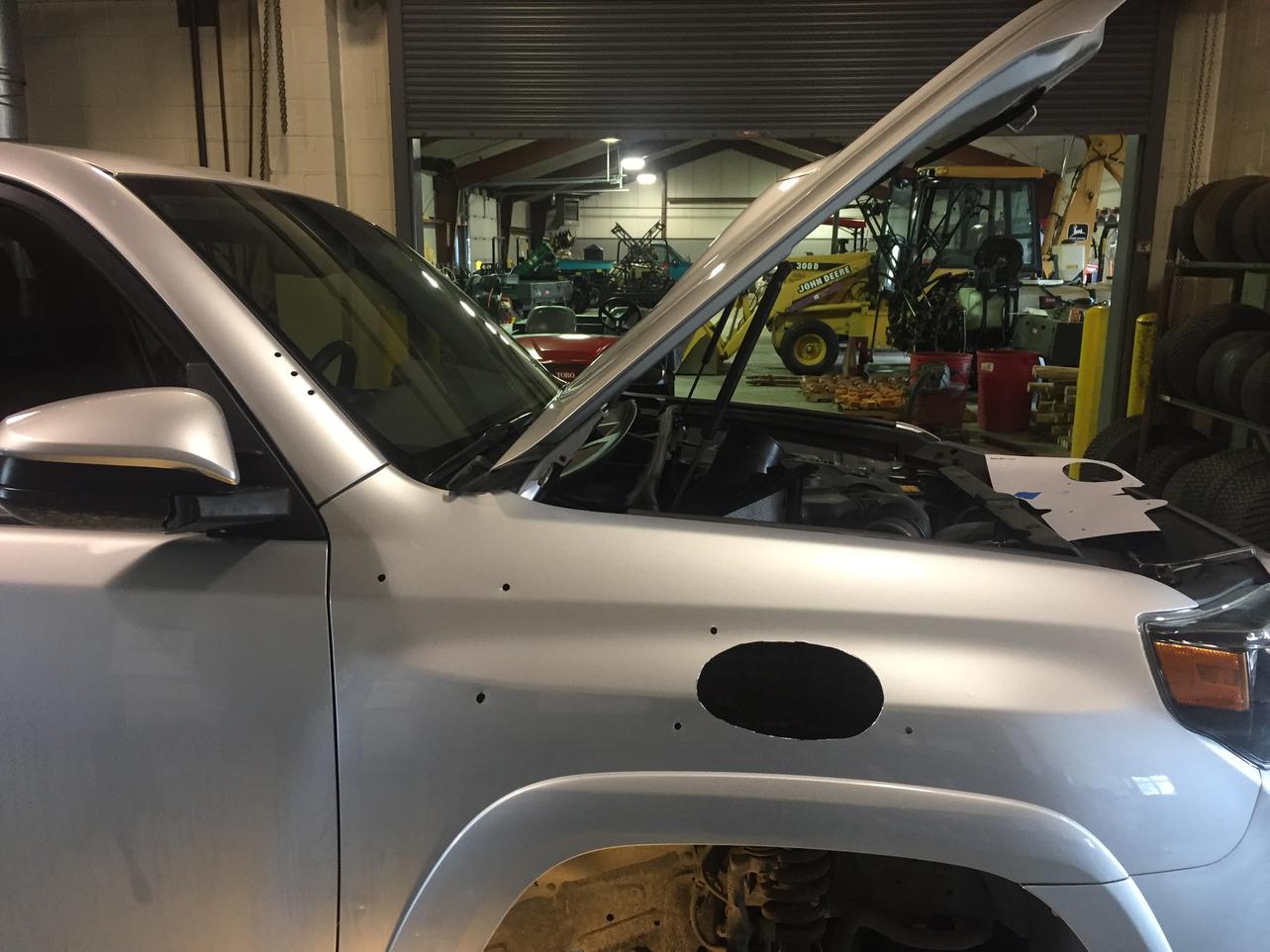

Do the holes look different than your prototype version?

LawnDart, which holes in question for "special" washer?
I think we can just grind them ourself in worst case...
I had 2 prototypes, one had 8 holes + 3 A-Pillar holes, second one had 6, and final one, which is what the final product more or less is has 6 but in slightly different spots because of how the molds required re-placement.
So technically my truck has like 10 holes under the snorkel not including the main intake. The cut washer is to avoid stressing the seam above the fender well bump out.
This is the last prototype I had, which I still need to smash. It has a major crack running along the outside area adjacent to the intake portion. I ran my prototypes pretty ragged.

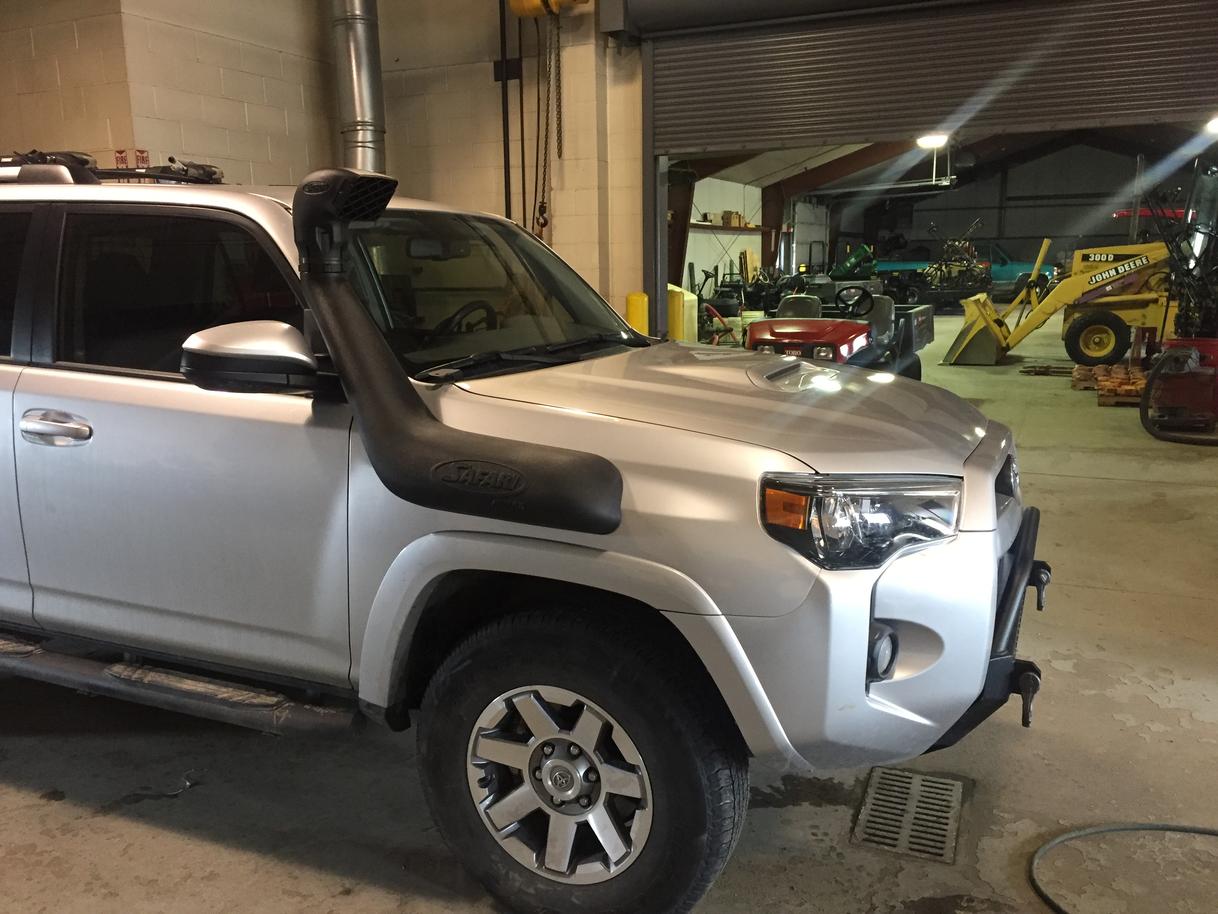

The 5th Gen snorkel sticks out from the body so much more than the one I had on my 100-series. I wonder why.
Because of the design of the fender flare, and the desire to increase airflow into the airbox.
I have used Hilux Snorkel designed for 4 cylinder on my 2005 4Runner and don't remember having an issue with airflow. It looked much slimmer then this one, but I'll better have this then nothing.
P.S. I don't think anyone will bring another Snorkel product to the market for the 5th Gen. Safari already concure it.
