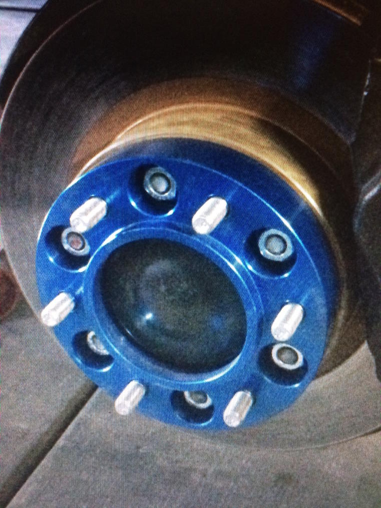

Here are a few instal photos...

From the photos it looks like the nuts might not have enough thread engagement (nuts on OG studs holding spacers on). Can either of you comment on nut/thread engagement?
From what Ive gathered they are extended nuts, unlike spider tracks that set in further due to being shorter nuts.
The instructions state as long as there are 5-7 turns on them they are good, which I got. I also used lock-tight. I do think I'll put rear length studs on there in the future just for the added threads, but as of about 200-300 miles they are good to go.

Excellent -- I figured someone was up when folks in other threads were raising alarms about lack of thread engagement. Didn't make sense that they'd sell a product that was so poorly designed. Thanks for the clarification. I'll be using some blue lock tight and slapping these on in the next couple weeks. Looking forward to it.

Just for added reassurance. Here is a photo of installed spidertrax. You can see that the nuts are shorter, but if you compare the depth of the face of the nut with the depth of the threads showing on the eBay ones it looks really close to the same.
Ill be pulling my front wheels soon to verify torque, so Ill take some better measurements and pull one nut to verify the exact number of turns I got on them.

Are the wheel studs on the spacers shorter than the stock ones?
The stock studs are the issue wit using the spacers in my opinion. Only a few threads get used. But the spacer studs are perfect length.
