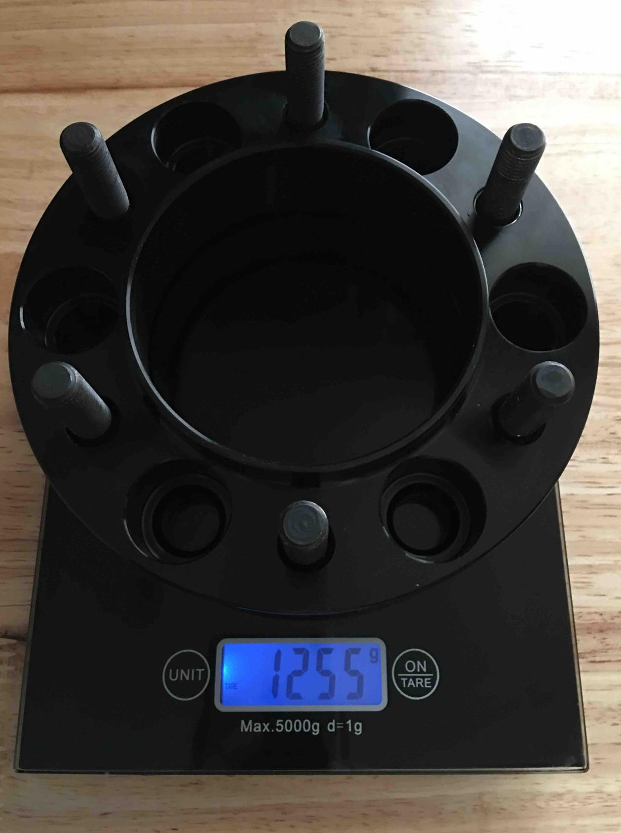

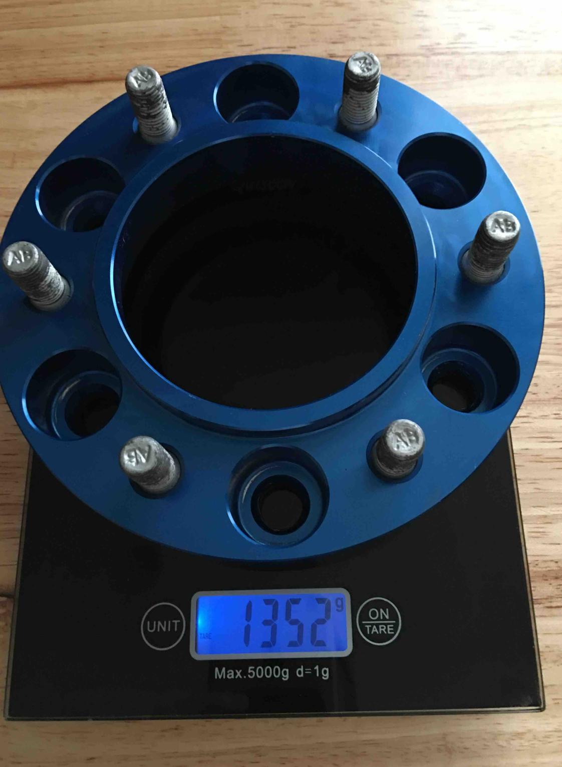

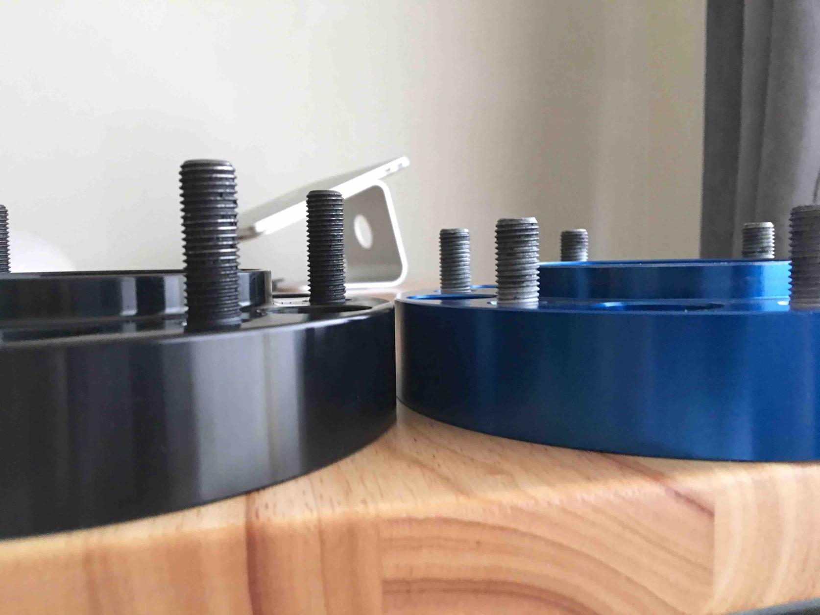

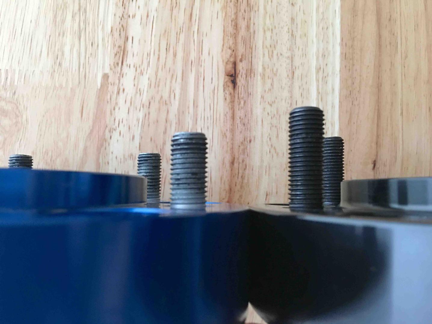

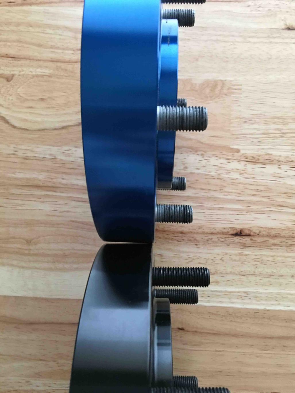

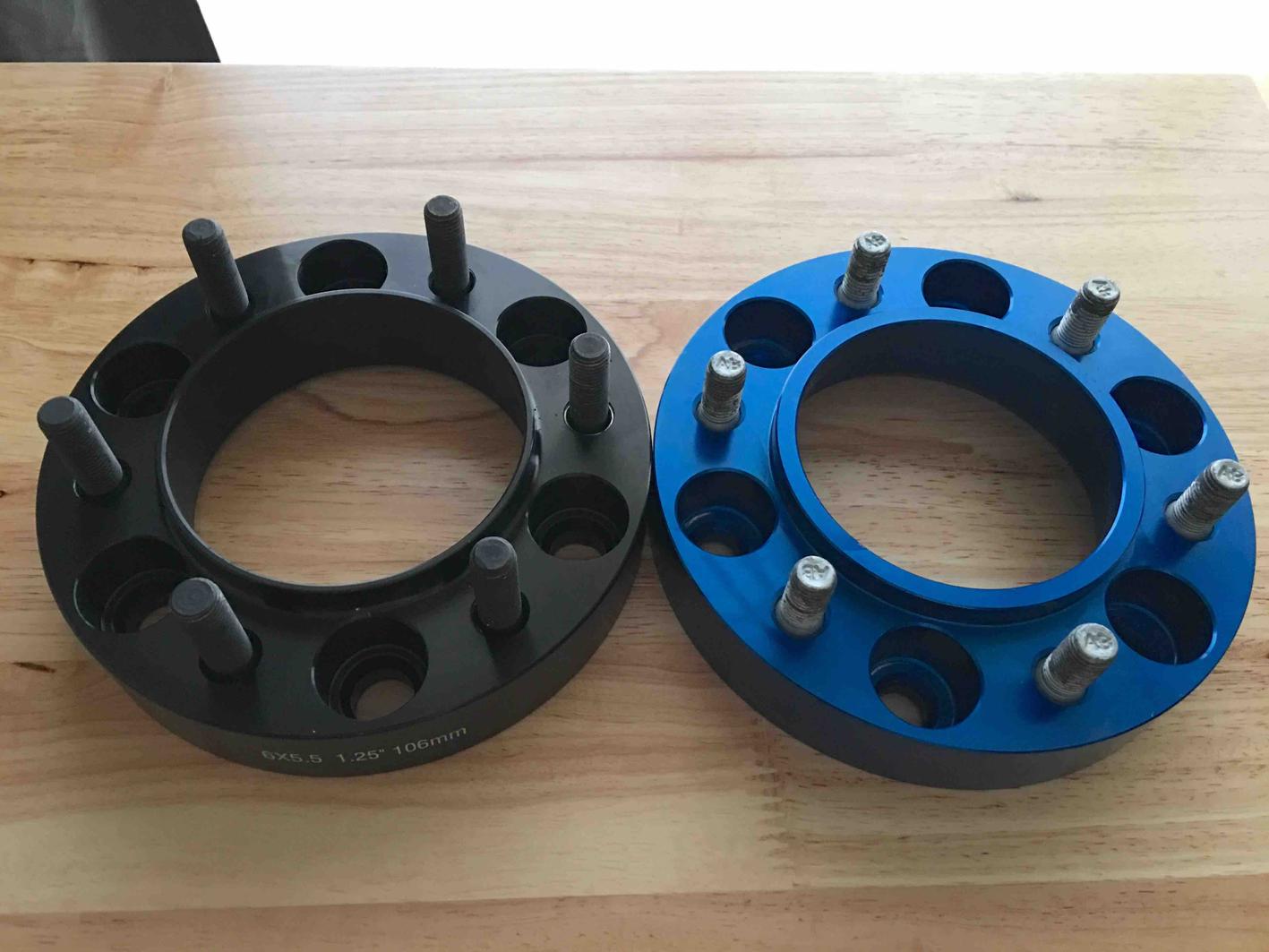

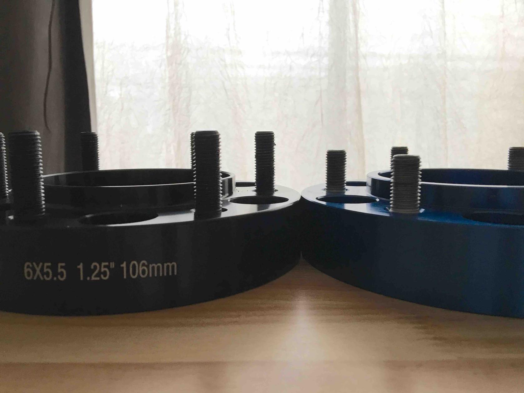

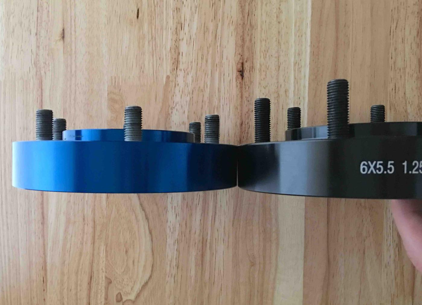

Spidertrax vs Ebay spacers " Unbranded" version:
For those still wondering if these spacers are any good.
I've wheeled the crap out of my rig, tire rotations, an any other type of work involving removing tires or wheel spacers (rotors, wheel bearings, cv boots,etc)
No issues at all, throw some loctite on them an call it the day.
