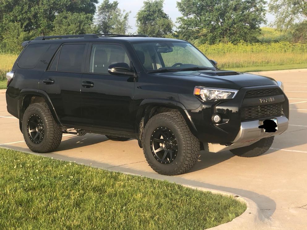

I went with the Icon Rebound in a 17 x 8.5 inch. The lift will be installed soon but it still clears with stock size Falken Wildpeak AT3W's. The wheel offset is 0.

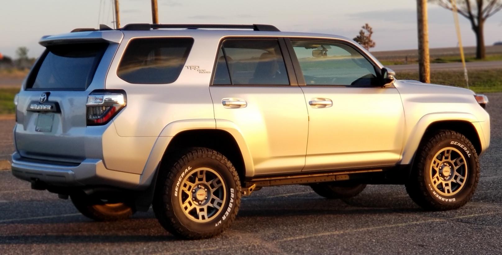

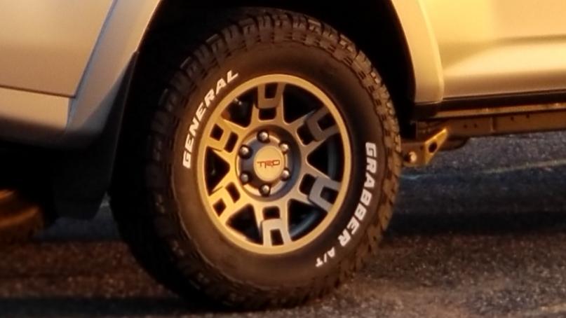

Here are a couple of pics. Have had trouble balancing but that is an unfortunate shortcoming of the 4runner...you can read the threads on that subject. There is flat spotting after drive and park so it takes a couple of miles to smooth out. Here are some ratings on a 1 to 5 scale;
Noise low speed: 2.5
Noise high speed: 1.5
Ride comfort: 4
Side looks: 5 - best on the market to my eyes, white lettering outside
Tread look: 5 looks like it means business

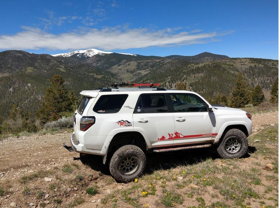

Not sure if the grey/silver SCS Ray10's are not as popular as the black or gunmetal, but mine were in stock and shipped immediately. I love the color personally and have no regrets. Would choose the same color again.

Thanks for the info! So it seems like the biggest plusses of the tire is the looks.
I'm on the fence about it, I keep going back and forth with this or the Cooper 4S.
