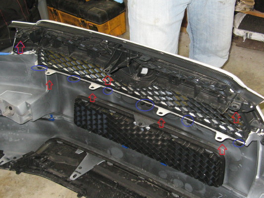

Don't know if this will help you, but this is a pic I took while I had the bumper off.

Another question is how to get those pop rivets from the plastic shroud back on there. You push the center down of the rivets and they come out. How do you get them to lock back in when you put them back?
Pull the whole unit out after you unlock them as you described above. Place the bottom part (Female receiver) back in the hole, then place the center, (Male part), back in the hole of the female reciver, press down, but only until the "top" of the male piece is even with the bottom ring. If you push in any further, you are starting all over again......
