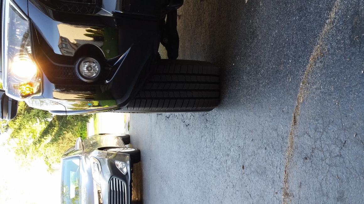

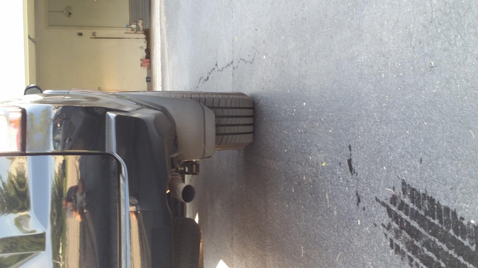

For some reason when I try to post pics they come in upside down. But I'm running a 18x9 fuel lethal wheel with a +1 offset and the spidertrax spacers and I love the way she sits. Also the tire size I have is 305/60

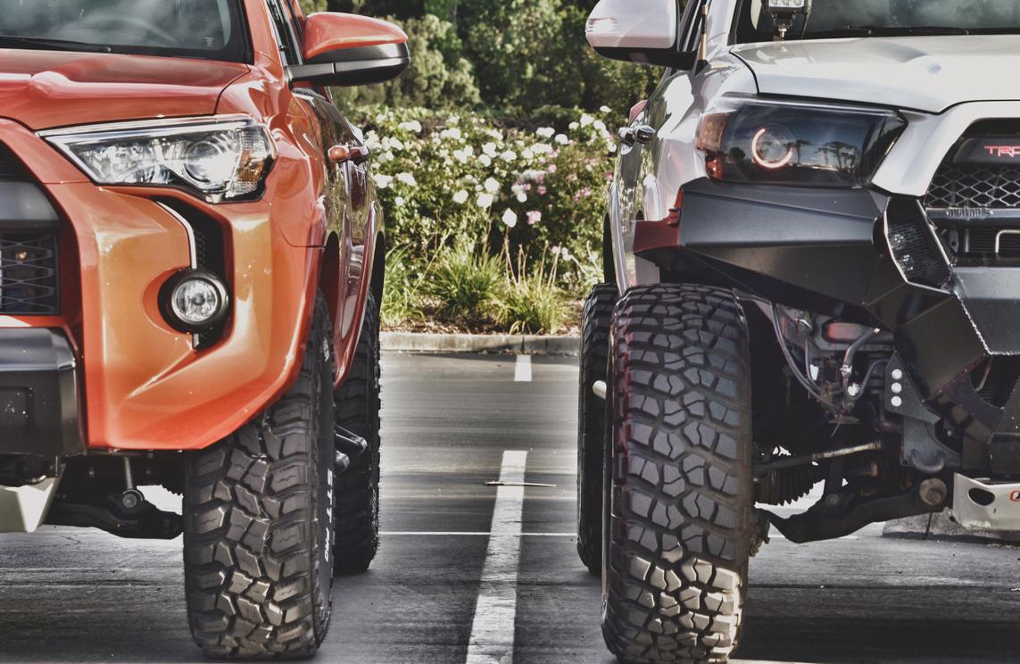

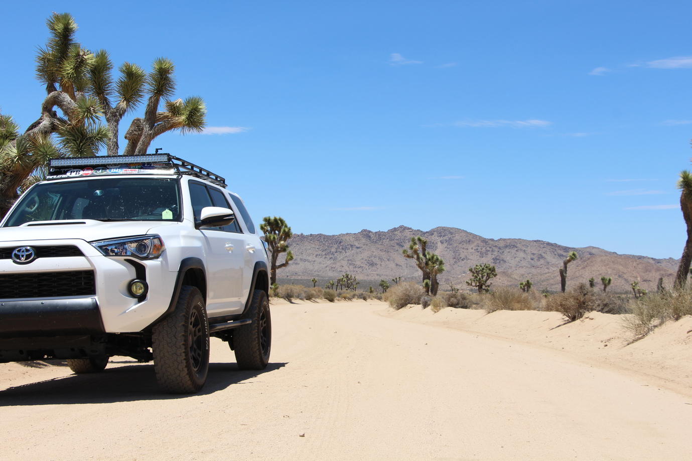

These are the specs of my Countersteers from FN Wheels:
Diameter: 17"
Width: 8"
Bolt pattern (PCD): 6x139.7mm
Offset: -10mm
Backspacing: 4.1"
I'm cheating a bit with my long travel set up which increases the track width 4".

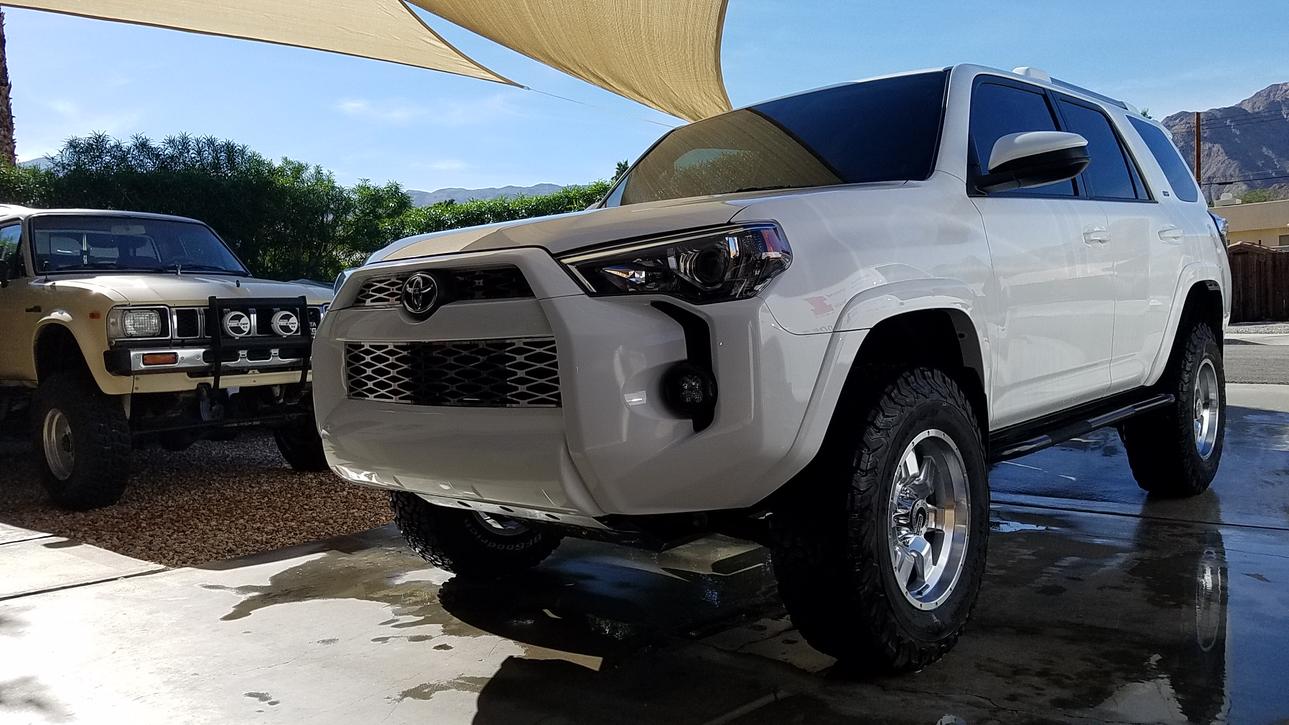

Wheels are 360 forged 20x9" with negative 25 offset.

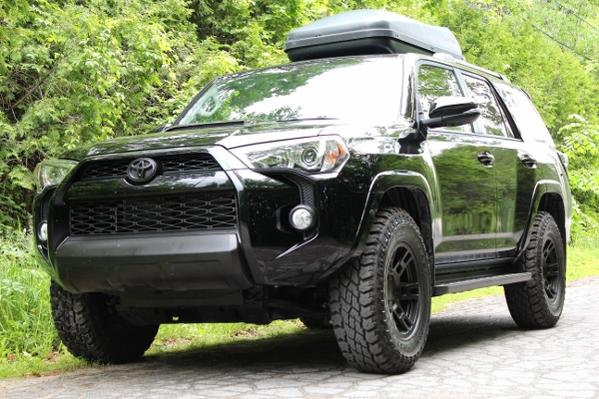

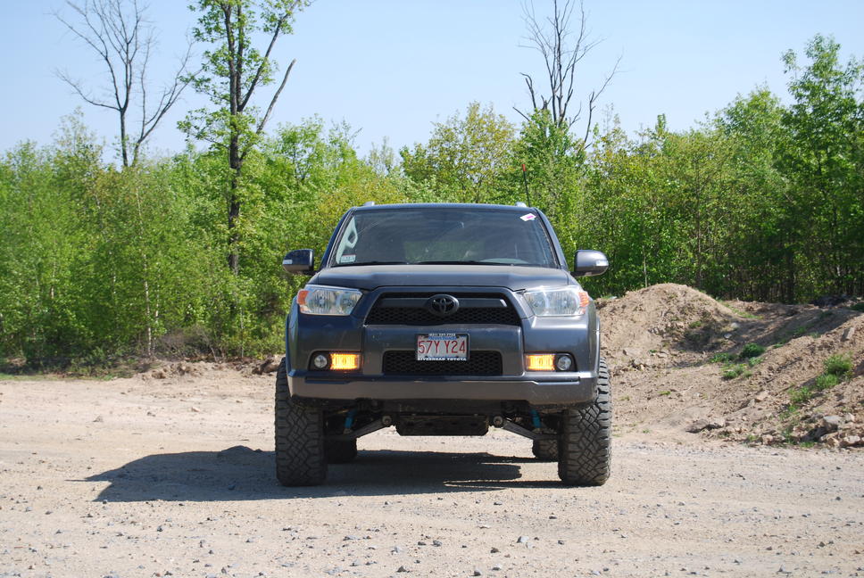

Heres mine. Trd Pro Rims with 1.25 Spider Traxx Spacers.

Thanks. That's a nice 6 spoke wheel. Our trucks can run very negative offset wheels which allow for huge lips and/or concave faces, (I elected for both on my custom set). I would be careful with any zero or positive offset wheels in over 8.5" widths... if you decide to lift the truck, the stance will shrink an inch and your wheels will sit inside the fender. Then you will need to run spacers to get them to sit flush. Spacers on stock rims? No biggie. Spacers on a custom set... Just doesn't sound right does it? My suggestion is to do it right the first time around.
Obviously the other factor to keep in mind is the overall height. 275/55/20 on my truck is 31.9" tall. Following alignment, tires rubbed front fender liner at full clock. Problem solved by cutting a small 3"x3" piece out of the fender liner. No rub on body mount.

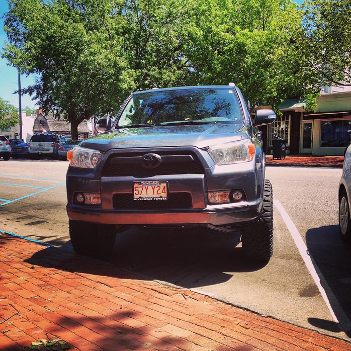

255/80/17 Cooper ST Maxx on Fn Pro wheels:guitar2:

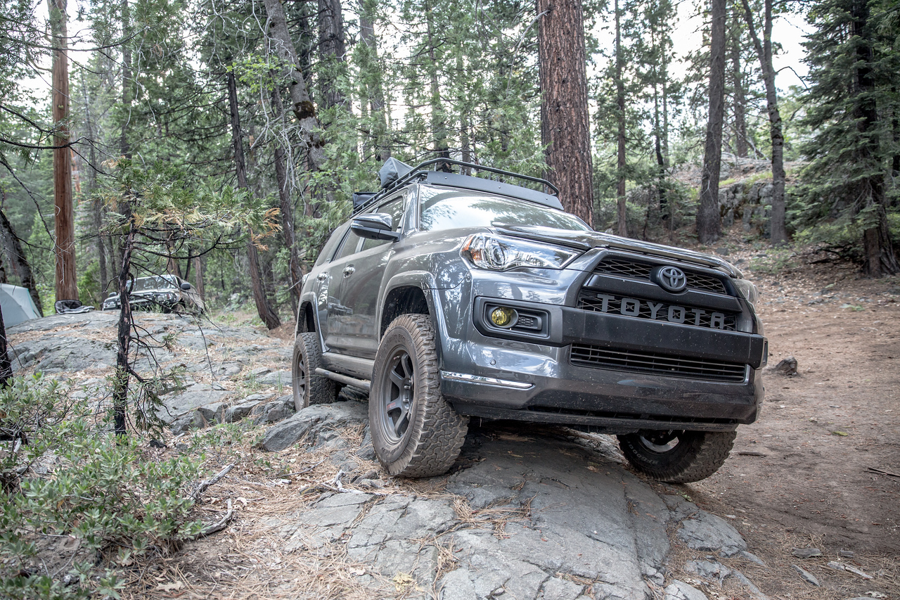

Pro Comp Phantom - Offset: -6mm - Back Spacing: 4.75 in
Slight rubbing on fender liner near front mud flap under compression/turn.

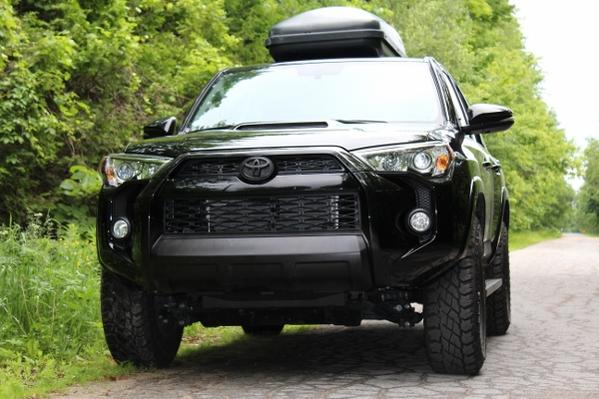

This is 20 x 9.5 with a +10 offset. I didn't want anything past the fender so it sits about 3/4 wider than stock set up.
