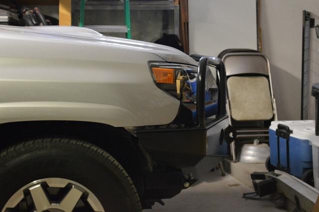

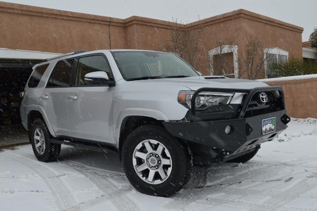

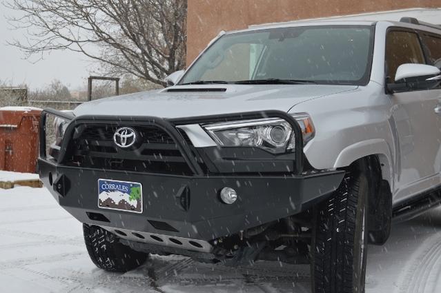

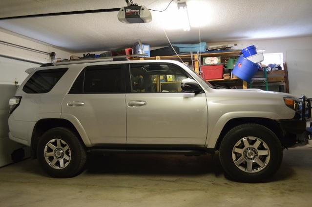

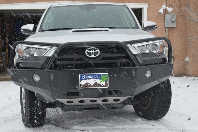

A couple of days ago I announced that I "finally" got my front bumper installed, and not without a little bit of head-scratching thanks to less than stellar illustrations and specific details from the manufacturer---nonetheless, I have no complaints and am impressed with the fit and finish of Shrockworks' product. Here are several pictures, and as I think we all agree, the beauty of the SW bumper is it's minimal impact on the looks of the vehicle, and I'm almost certain that it doesn't have any additional dimensions adding to the overall length of the 4R---but as was pointed out by my Toyota mechanic who did the install, he noticed the effect of the almost 140lbs. hanging off the front end, and how the body sits lower in front.... I guess that's like having that "full-figured" girlfriend may you recall with fondness from when you were in your early 20's...sitting on top of the radiator like your personal hood ornament:girl:
He suggested the adjustable Bilsteins that might get the front end to sit up and even out with the rear (5100's?)-----a "very" mild lift and more M&S type rubber on tap, as soon as the present Bridgestones evolve into drag slicks.

What happened to the grill? Is removing it a requirement of the SW bumper?
I like it, but I agree it will definitely look badass with a lift and tires. I would consider getting one, but I would have to buy it at the same time as my lift kit since the added weight requires different springs, and my budget can't handle the extra cost on top of the lift and tires. Do you plan on getting a winch?

Bad ass looking aside... You're effectively lowering your truck with weight. I would imagine that this adversely affects highway handling. Not to mention the front end will have less clearance when off roading. Look into OME heavy duty springs to negate the sag. IMO heavy armor should be done right after or at the same time of a suspension swap that can handle the weight.
Maybe its because you don't have a lift and good tires and/or because of the accents being black the bumper looks a bit off to me (it might be the fact that the truck looks like it has two black eyes lol )
I saw [MENTION=49966]mikey's2010SR5[/MENTION]'s 5th gen in person and we chatted a bit about Shrockwork's solution to the gaps left by the missing bumper skin; on his 5th gen they always ended up drooping down because the sheet steel was so heavy compared to the mounting points. Is that the same with the 2014+ models? I am surprised that SW didn't try and make them out of aluminum instead to help prevent them from drooping (they really couldn't do much about the design as there's just not much Toyota left them to mount to without the bumper skin, so I can't fault them on the utility of their design.)

i hate the fact that it seem like all 2014- front bumpers are doing away with the stock plastic under the headlights...makes it look weird, but I'm guessing that part of the front clip does that when you remove it so they have to fill it in . would be nice if they designed it to be cut and keep that part...
I edited some, I re read and it came across as me not liking the bumper, I like it, I was just nitpicking because I do that.
The sagging for sure will be fixed with the lift and the whole look of the truck will come together nicely.

First off, beautiful 4runner and House. I read this post and thought(specifically the words in bold) funny, that's the way I feel sometimes. But true, a slight lift will help the front end, not only with the sagging, but also in the handling department(But I am sure you knew that).

On that note, I wonder what it would take for Shrockworks to have some plastic inserts molded in lieu of the current steel trim pieces? Perhaps carbon for the weight reduction:D
Looks good!
But I would prefer to cut the oem bumper so you can retain the oem portion of the bumper below the headlights. Similar to what ARB does and CBI to their rear bumpers for the 5th gen.
Stating the obvious, but there is a huge advantage to not cutting the stock bumper. You can remove it and go back to stock very easily. Sell the bumper....
I think it looks great as is. Maybe color match under the headlights.
Anyway, the bumper is not for looks, it is for function and durability off-road. I would never put one on a truck that I did not plan to wheel the crap out of.
I would suggest a lift ASAP. Go with a heavier spring upfront. Maybe a med if you don't plan on a winch. Heavy if you do. OME or Toytec are reasonable.
