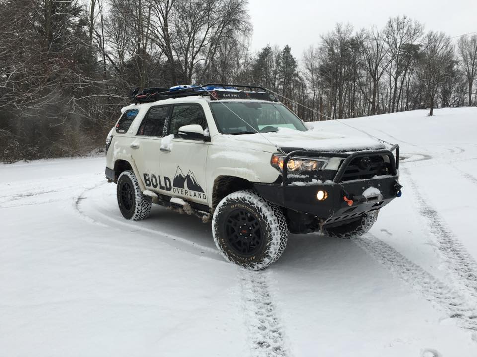

Here is my Shrockworks front bumper on my 2014 Limited. I am extremely pleased with this bumper. I recently added the limb risers to this set up, due to the crazy amount of overgrowth in the East Tennessee Area. In regards to suspension, I did a little research and spoke with my local Toyota dealership, followed a few threads on here and also called Toytec and spoke with them about what would be the best setup for what I could spend at the time. I finally settled on Bilstein 5100s all the way around and added the ToyTec adjustable front Coil overs up front and Superflex HD rear springs. I chose those options because I knew I would be adding more weight down the road and wanted to be prepared. I hope this helps.
This definitely helps! It looks like the vast majority of people are going with Toytec/Icon set up or the medium duty OME coils. I did read on another thread that people discourage using Bils with OME coils.
