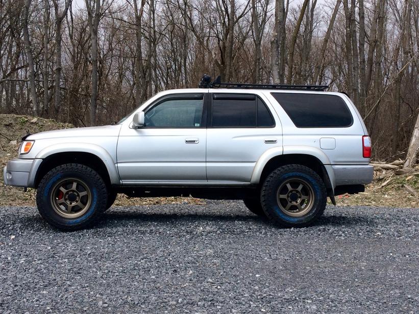

This weekend me and [MENTION=213580]SlvrSupraSub[/MENTION] finally got around to installing the SS1.2 lift.
Here she is working on the front suspension.
Out with the old, in with the new.
All buttoned up
I didn't take any pics of the rear suspension because I was too busy cursing and fighting the rear shocks trying to get the damn nut off the top, but we finally got them.
The SS kit was awesome and included everything we needed. Great instructions and Steve was ALWAYS available via email to answer questions for me, even on the 4th of July. I hated to bug him on a holiday but I really wanted to get it installed. Thanks Steve!!
Here is the finished product.
Look at that drivers smile! :biggrin2: She loves the stance of the new setup - so do I.
And here is [MENTION=213580]SlvrSupraSub[/MENTION] cleaning the tub, just because. :) :usa2:
Overall I'm SUPER happy with the lift and now need to fill those wheel wells with some bigger rubber. I can highly recommend the SS1.2 if you are like me and wanted a complete kit designed to really work together.

I measured 23.75" from center of hub to bottom of fender in the rear.
I really like how it rides. It's not as smooth as my King setup on my Tacoma but I knew that and overall would absolutely buy the SS1.2 kit again.
Me and [MENTION=213580]SlvrSupraSub[/MENTION] finished installing the Curt roof rack this evening. We still have a few things to tidy up (paint, front supports, etc) and need to mount the ARB 2000 awning as well.
We followed this thread (http://www.toyota-4runner.org/3rd-gen-t4rs/224557-inexpensive-full-length-roof-rack-curt-rack.html) for the most part but ended up changing a few things. We added an aluminum L bracket on top of the square tubing and ran bolts horizontally into the Curt rack. It made for an easier install and is REALLY secure.
Here are a few pics of it... I'll add more tomorrow. Overall, we're very happy how it turned out and should be sturdy enough to hold lots of our camping stuff.
L bracket shown here:
