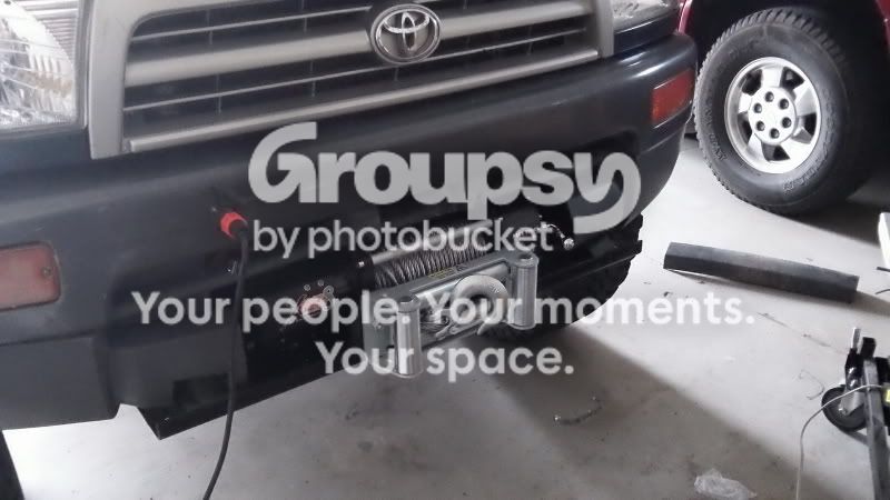

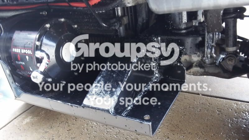

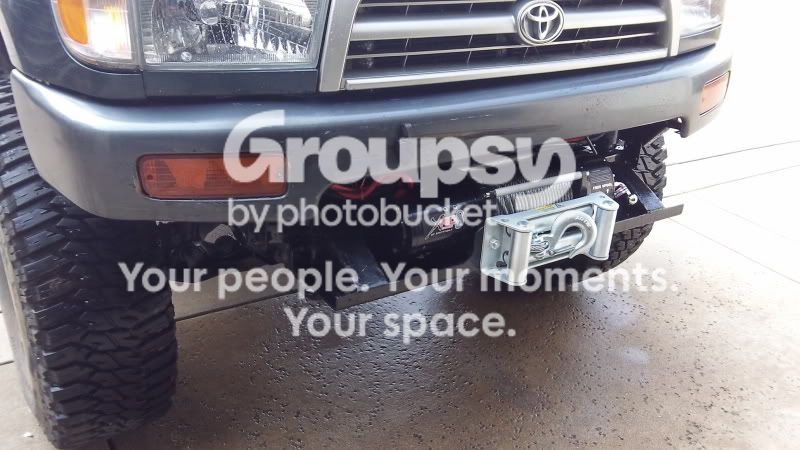

I had the same thought. I didn't want to add a heavy plate bumper . I only wheel once in a while and I didn't want to lug around a bunch of weight.
I even ditched the steel cable and roller fairlead and went with synthetic. Lighter, stronger, safer, easy to handle and it floats.
Hiding the winch also protects the rope from UV rays.
Question? You have a good 2 to 4 inches to the top of you bumper. How come you didn't mount your winch higher. I think it will help with approach angles and front ground clearance.
Neat set up. Awesome job on build.
i mounted it low (bottom of frame) because at the time i wanted the option to be able to take the body lift out. i also dont have any plastic under the bumper
