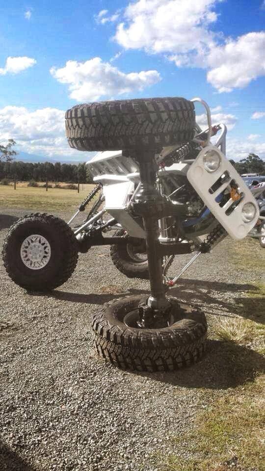

Thats how it should be done. It's like artwork.
No springs and there isn’t even a shock on one side. It’s easy to articulate on a display when nothing is in the way. Show me that same articulation with a shock on both sides and I’ll be more impressed. Wouldn’t surprise me to see actual usable travel at 60-70% of what’s shown in the picture when shocks and springs are added.
It is pretty, I’ll give you that.
FWIW - that truck didn't actually work very well. It was run in an Australian desert racing series. As far as I can tell it was not competitive. I can't find any information on it still being used. TT class allows IRS. No one so far has been successful with it. Doesn't mean they won't be. But they haven't been so far. I don't think they can manage the crown of the roads on desert tracks. Every time you compress you're bottoming out on the crown of the road. Maybe some sort of high speed portal box could help solve that issue?
