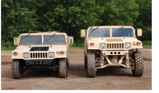

Here are some of the benefits of the TAK-4 and TAK-4i independent suspensions used on our military vehicles.
“Equipping the TAK-4 suspension on HMMWVs provides numerous benefits, including:
–A 70 percent off-road profile capability and 14 inches of independent wheel travel to overcome obstacles and navigate rugged, mountainous environments
–Ground clearance increased to 17 inches to improve mobility and occupant visibility while also helping to counter underbody blasts, such as IEDs, by enabling more stand-off distance
–A 40 percent increase in the vehicle’s maximum speed and a 46 percent improvement in braking
–Restoring a 2,500-pound vehicle payload capacity when the crew is embarked with all current add-on armor installed, which allows for consideration of an under-vehicle armor vee-shaped panel solution to further improve survivability
–Improved ride quality, with a reduction in suspension vibration and harshness for less crew fatigue” (3)
“The new Oshkosh TAK-4i intelligent independent suspension system suspension provides 20-inches of wheel travel ..
TAK-4i intelligent independent suspension system suspension is an ‘intelligent’ independent suspension, providing variable ride height through gas springs.
“In all cases the operating profile of the system is 70% off-road, 30% on-road.” (2)

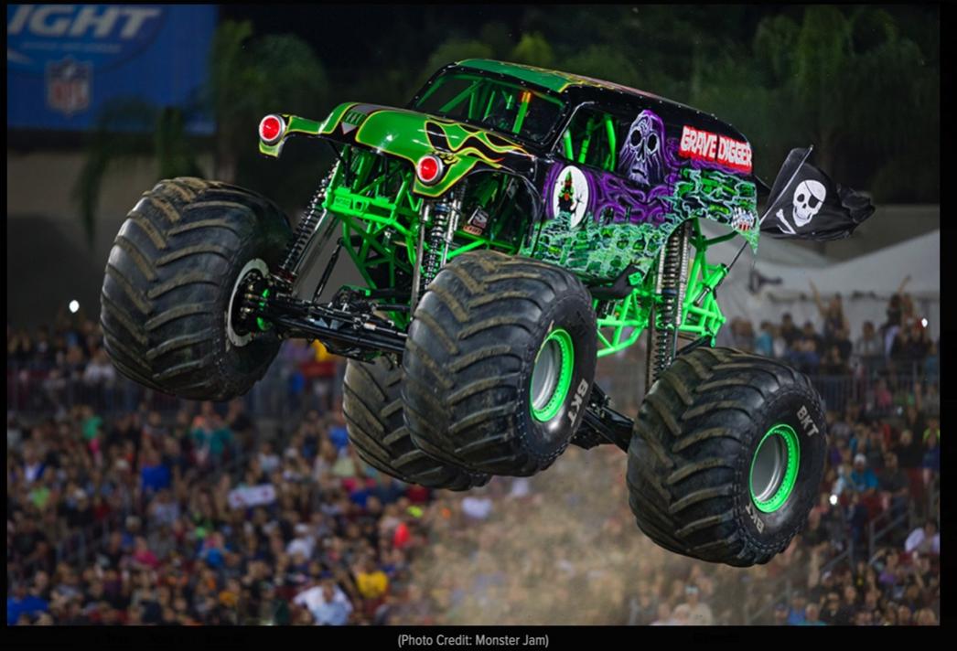

I haven't looked real hard but I haven't seen any Monster Trucks using IFS. Same with the rear ...all SRA
According to these guys "The wheels and tires are sessentially what make your Monster truck"...
So You Want to Build a Monster Truck – RacingJunk News
The Government is notoriously cheap and if they paid for IFS and IRS on their combat vehicles I bet there is some serious justification on it and it would be in some public documents of someone could find it.
They are even upgrading the HUMVEE with TAK-4 it looks like.
