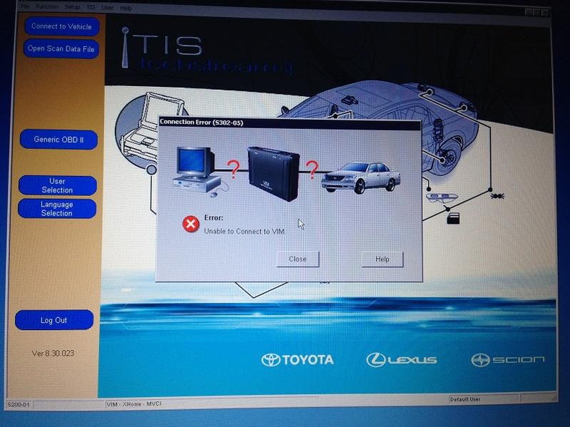

Got one Xhorse MVCI, got error: unable to Connect to VIM , during connect techstream via mvci to Toyota car models as following picture shows:
128088d1408687864-solution-xhorse-mvci-toyota-techstream-unable-connect-vim-img_1697.jpg

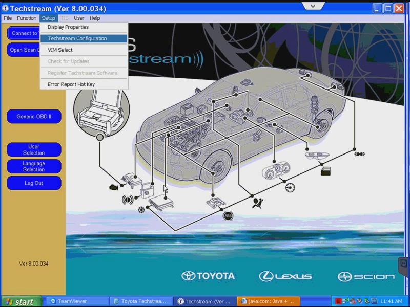

Finally solved as follows:
1. open Techsream software, in the toolbar click "Setup-Techstream conficuration"

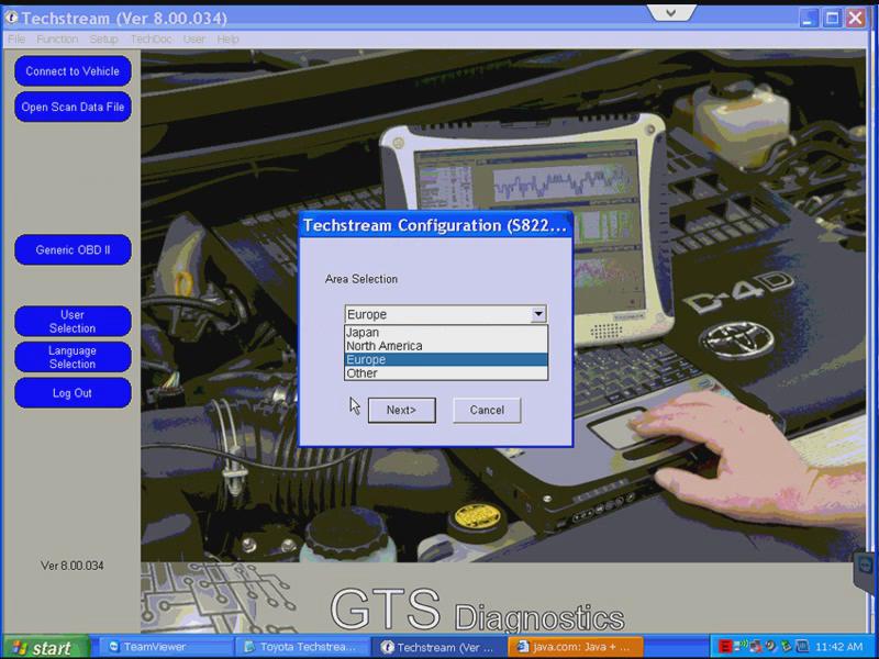

2. Area Selection: select "Europe"
Read third Attached Images

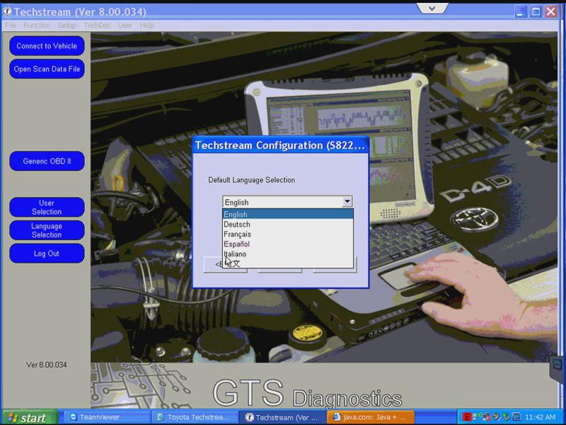

3. Default Language Selection
Read fourth Attached Images

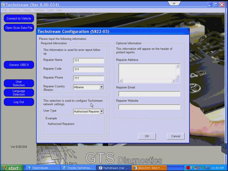

4.Techstream Conficuration: no need input nothing, click OK.
Read fifth Attached Images
