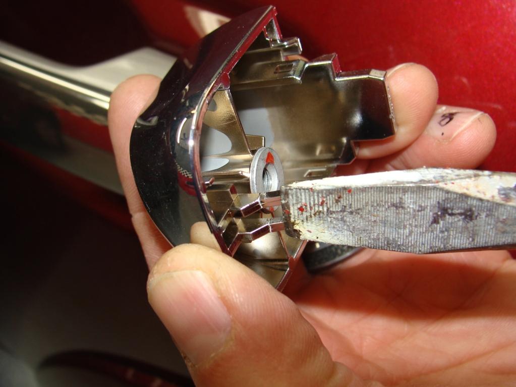

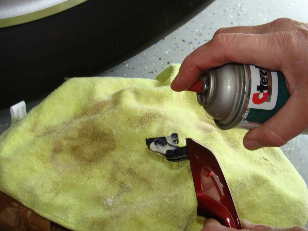

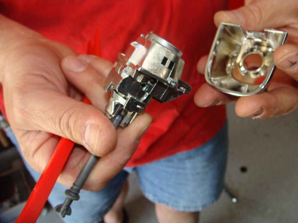

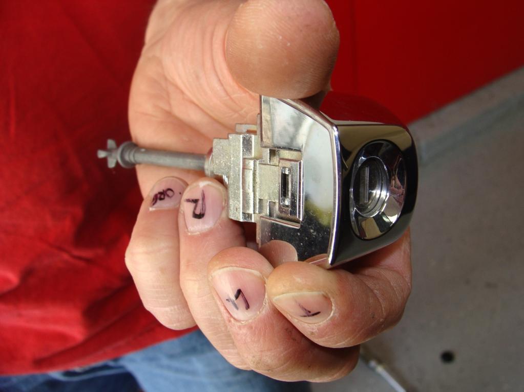

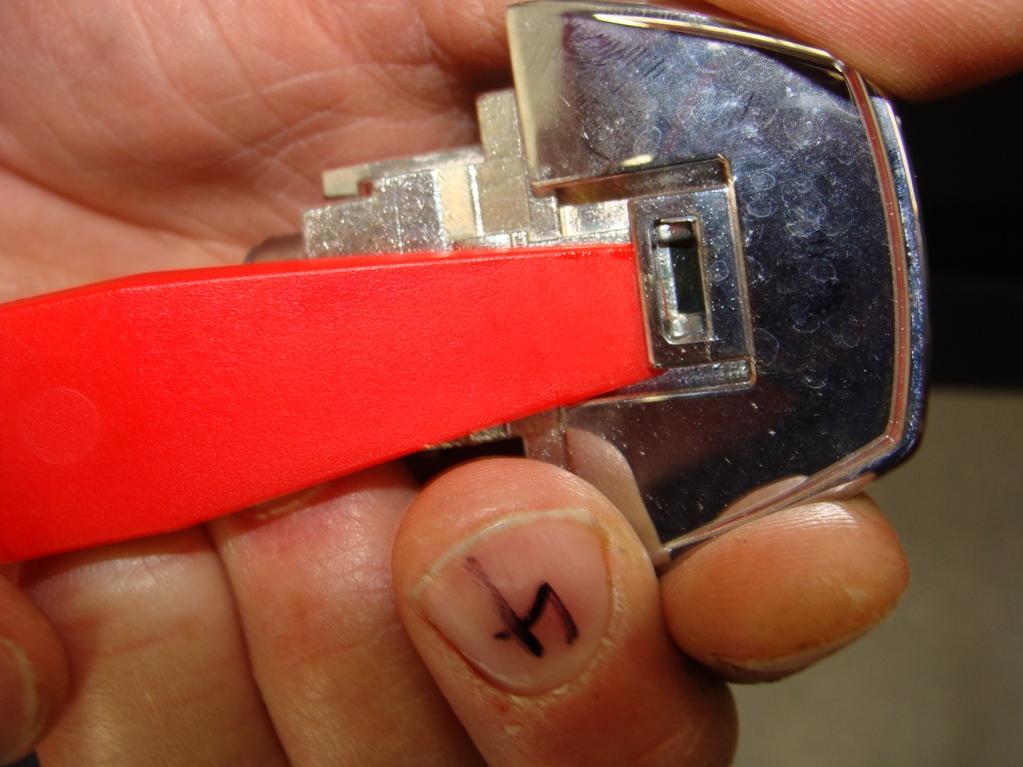

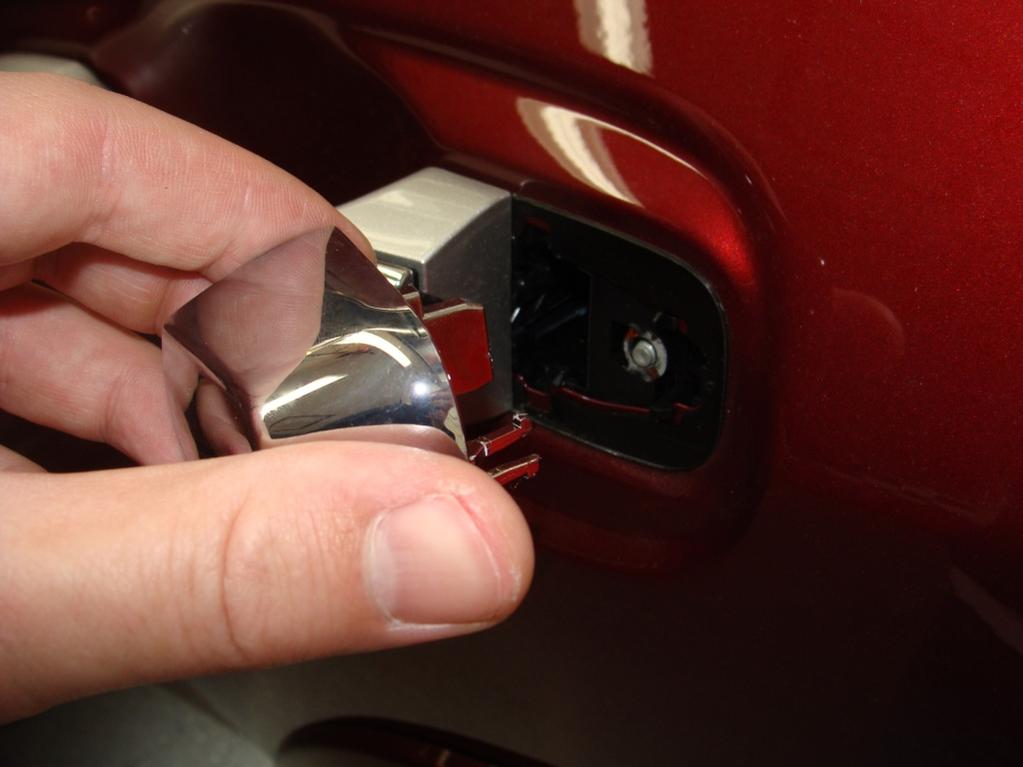

One small nuance about the front driver’s side door is the locking mechanism. We thought this might be a tripping point, but it really wasn’t. Following the same instructions as above, the locking mechanism and door handle cover just slide out as a whole unit.
With some slight pressure on the tab, you can release the lock from the door handle cover, and paint it or reinstall your color-matched door handle cover.

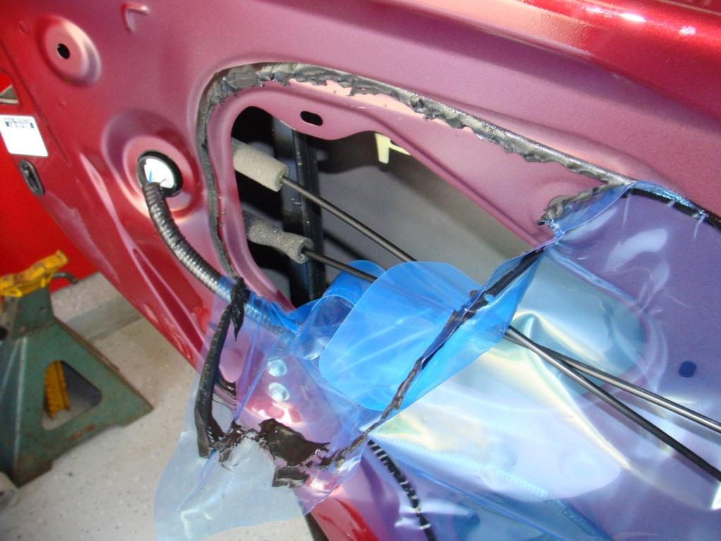

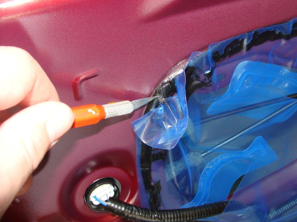

Both rear door handles will come off in an identical fashion, as there’s no locking mechanism with which you have to fiddle around. Again, the instructions are very similar to the front doors, but the door handle cover comes off differently.
So, we’re once again going to cut into the adhesive (not the plastic) to reveal the inside of the door.

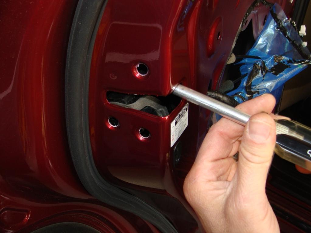

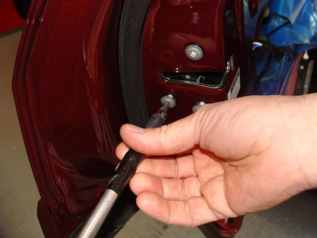

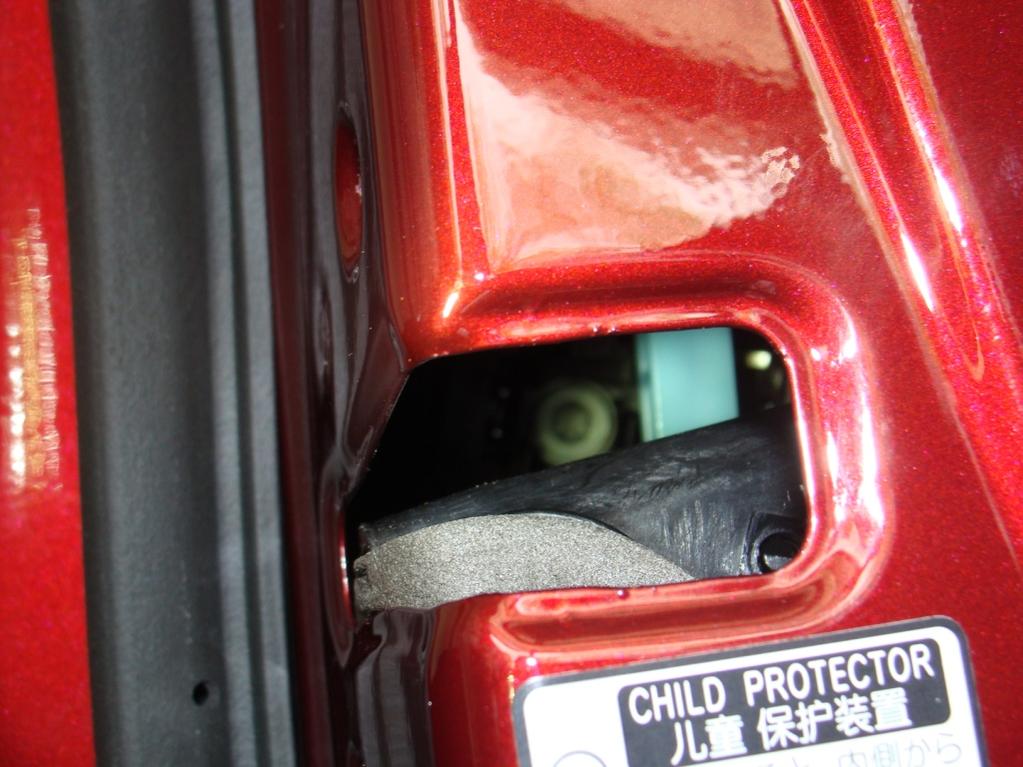

Now, you will see three Torq screws around the door latch. These get removed.
That will allow the latch to flop around inside the door. That’s OK, because you want to push it down enough to see the Torq screw behind it…which is the screw for the door handle cover. Here you can see the latch has been pushed downward, and you can see the silver of the screw in the background.
Back out that screw – but realize that it’s seated and won’t come all the way out (there’s a catch, which is good, because it prevents you from dropping the screw into the door). You’ll feel when it’s all the way out.

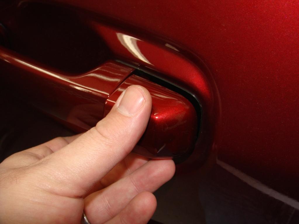

Reach in with a flat head screwdriver and GENTLY press the two tabs holding the cover in place in the direction shown. Remember that this is plastic, and too much force will bend or break those tabs.
While pushing on the tabs to release the door handle cover, gently work the door handle cover from the other side to pull it from the vehicle.

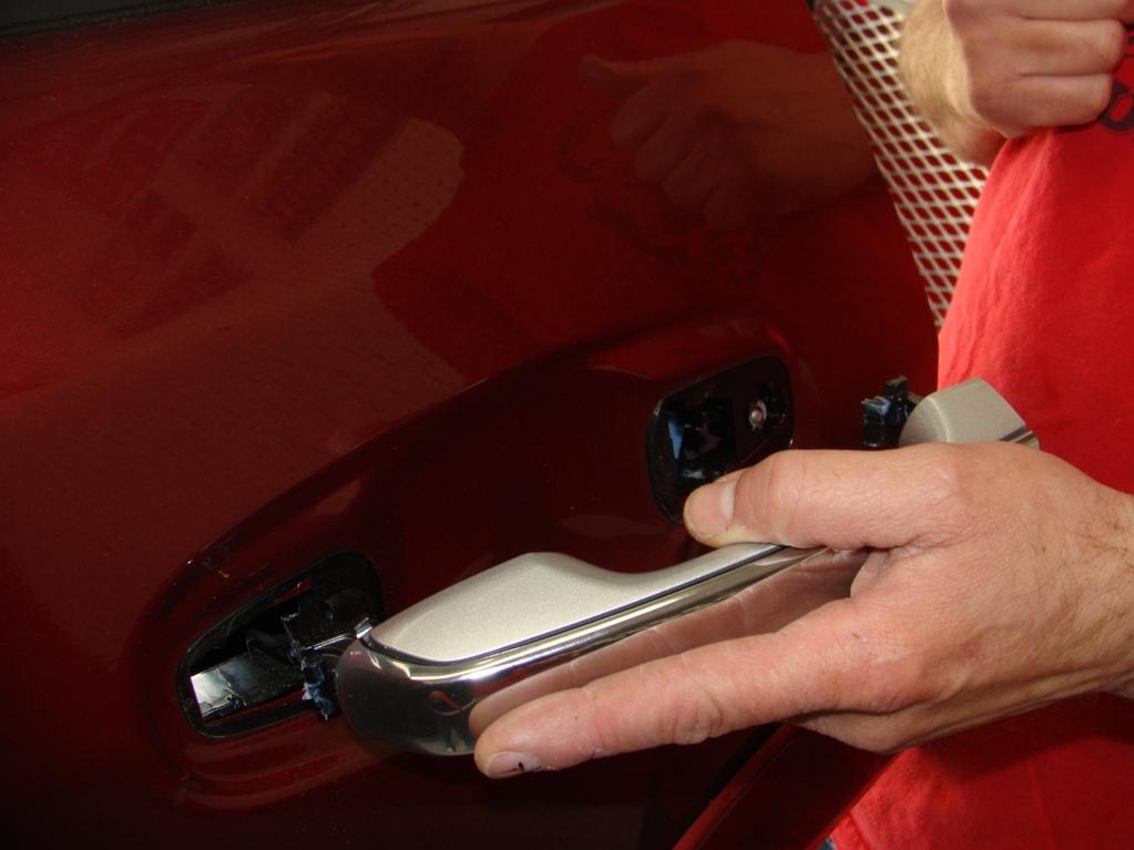

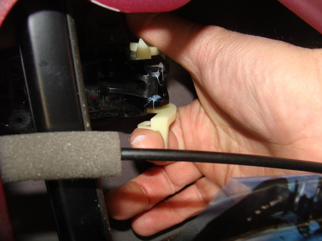

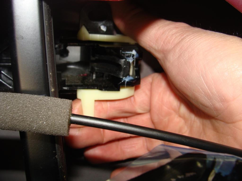

Here’s that yellow clip. As pictured here, it’s “closed” and holding the door handle in place. See how Antman has simply grabbed it with his finger?
A pull of the finger, and now the yellow clip is “open”. See the difference?

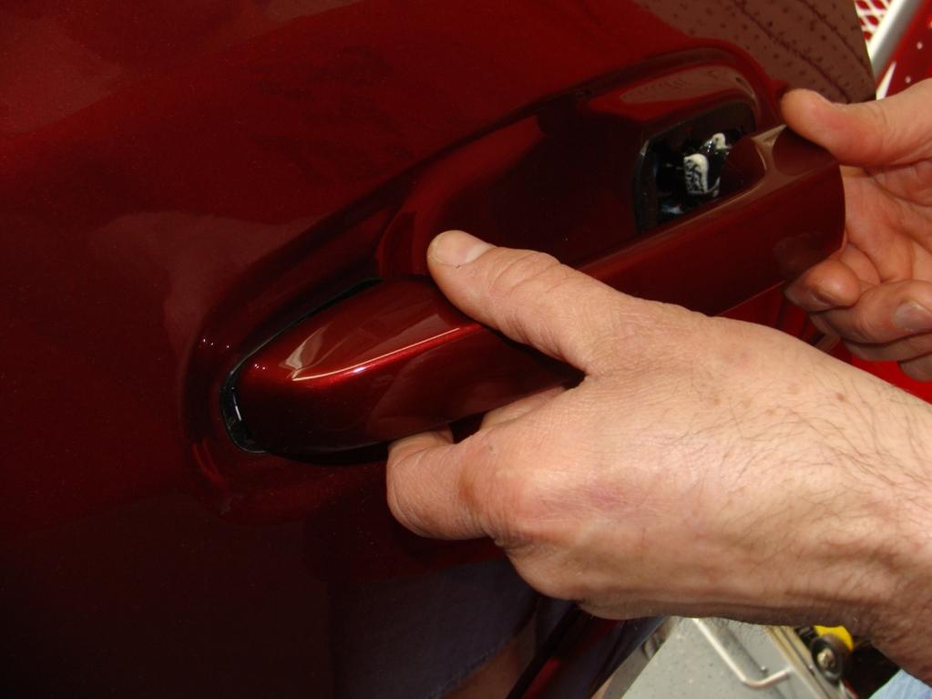

Once again, we’re simply pulling the handle away from the door and towards the rear of the truck, and the door handle should come right out.
And your rear handles are now removed!

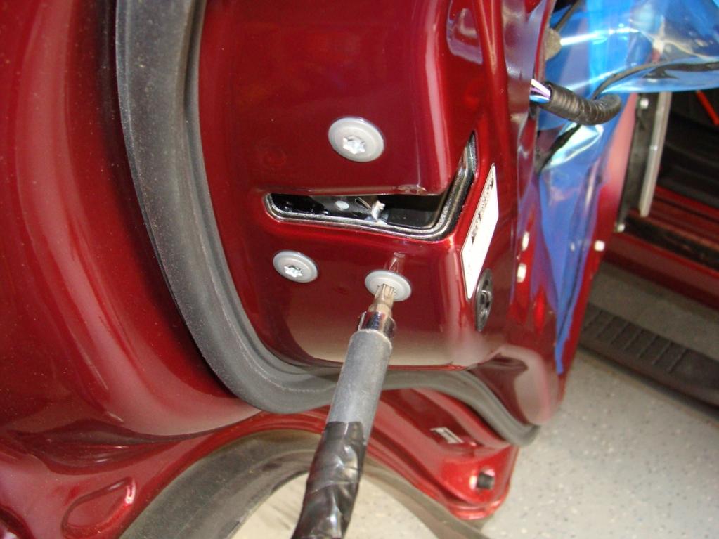

Reach in and retighten the Torq screw that holds the door handle cover in place.
Reattach the door latch with the three Torq screws on the outside edge of the door.

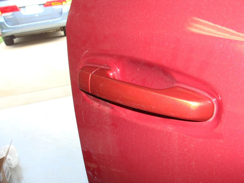

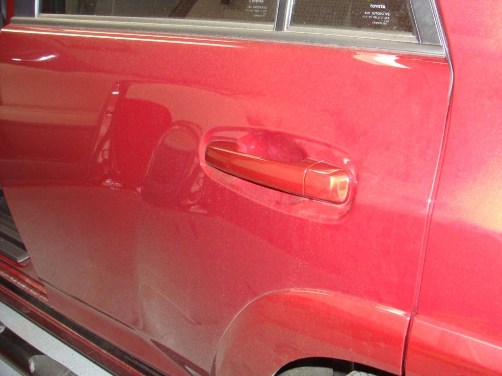

Hopefully, you have something that looks like this when you’re done!

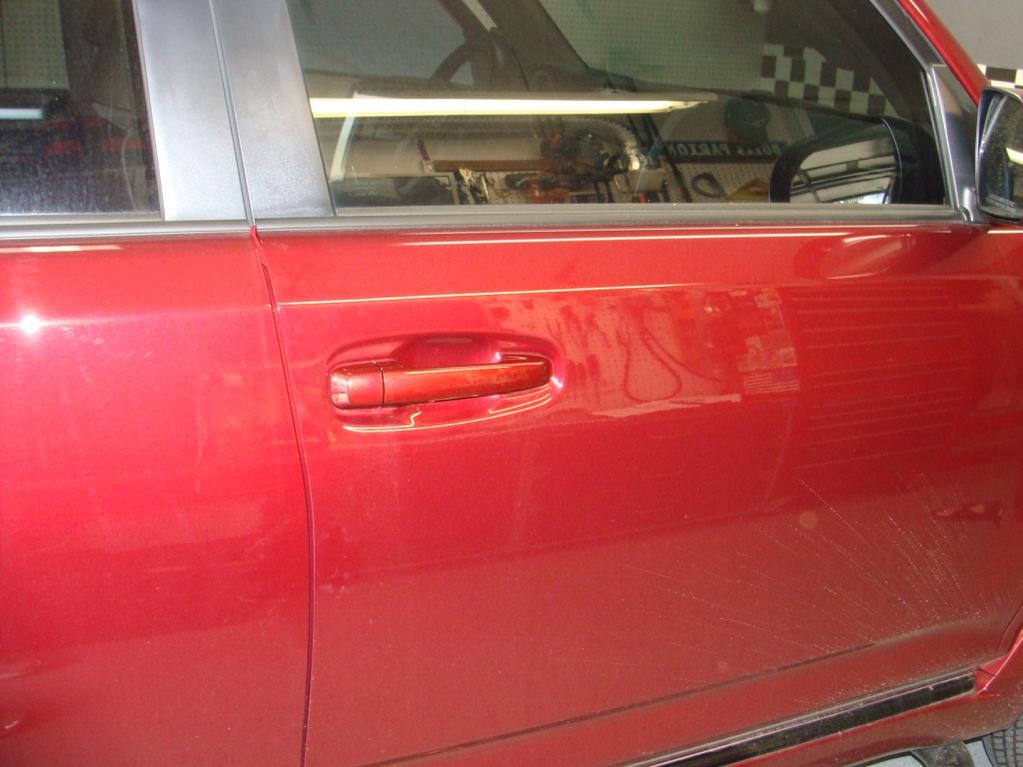

Low on the dork meter, and she was impressed. Less impressed than I hoped (the light is subtle, and I think she was expecting more...but i wanted subtle!), but she likes it.

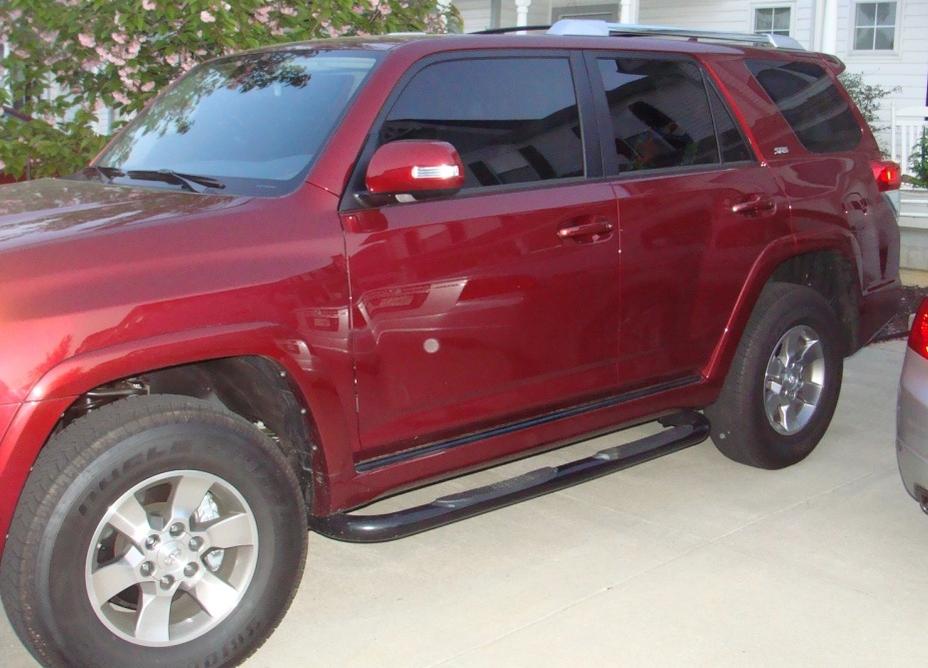

you got a picture of the whole care with the door handles changed out? I know you do..post it! :trophy:
Here...I'll try to get a better one tomorrow if I can. This one has lots going on in the reflections and what-not.
