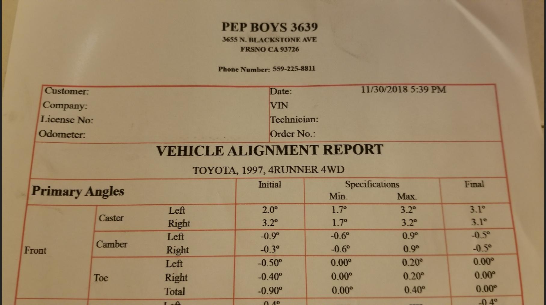

Well, I finally got the alignment done.
Interestingly he didn't have to touch the cam adjusters and the SPC UCAs. He got the above alignment simply by adjusting the tie rods.
This is what I did beforehand, all to the max:

With that he simply played with the tie rods...

Alignment numbers look great. Those are the best caster numbers I've seen on G. Everything drive pretty well?
Based upon the sheets and info shared here, I told the guys at the shop that 2 degrees of caster might be the most they can get; and that I'd be fine with that... The shop sells and installs these SPC arms and have quite a bit of experience doing alignments on lifted rigs, including our 3rd gens. Even though they are a little more expensive and a 30+ minute drive, I found it worthwhile...
Unless I missed it, I don't recall anyone previously saying that their alignment techs tinkered with the tie rods. I was wondering myself why. Maybe just assumed... Comments here on shop adjustments were limited to the eccentric cam bolts and the top nut on the SPC UCAs.
So, I've only driven home that day and I can say that it tracks straight, steering feels light and centers after turns. I think it might center even a bit better if I back-off the steering rack guide a little more. I just installed a new one, and made it a little tighter than spec before the alignment. I believe I noticed, possibly only at certain speeds, a slight left/right movement in the steering wheel. I'll drive it again later this week. As happy as I was/am about the caster, the toe less so. I had my oldest kid with me, other commitments, so I didn't ask for additional tinkering to improve upon the toe. I can bring it back for free within 6 months or 6,000 miles, and I plan to do so...

ALL alignment shops mess with the tie rods. That's the one thing they all do, which is why it isn't mentioned. Crappy places only mess with them and ignore everything else.
In the case of your alignment, you did all the hard work in your driveway, so you made it easy for the tech. Everything is within spec and near the middle. I'd be quite happy.
If it was a car, I'd go for less toe... but its a truck and you want stability. Caster might be nice to have slightly higher on the passenger side (~0.1-0.2*), but if it tracks well and doesn't follow a crown excessively, keep it as is.
