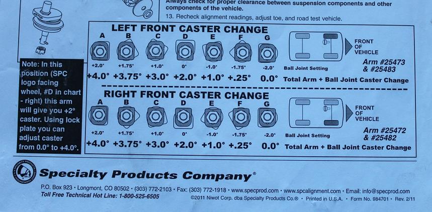

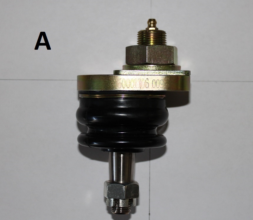

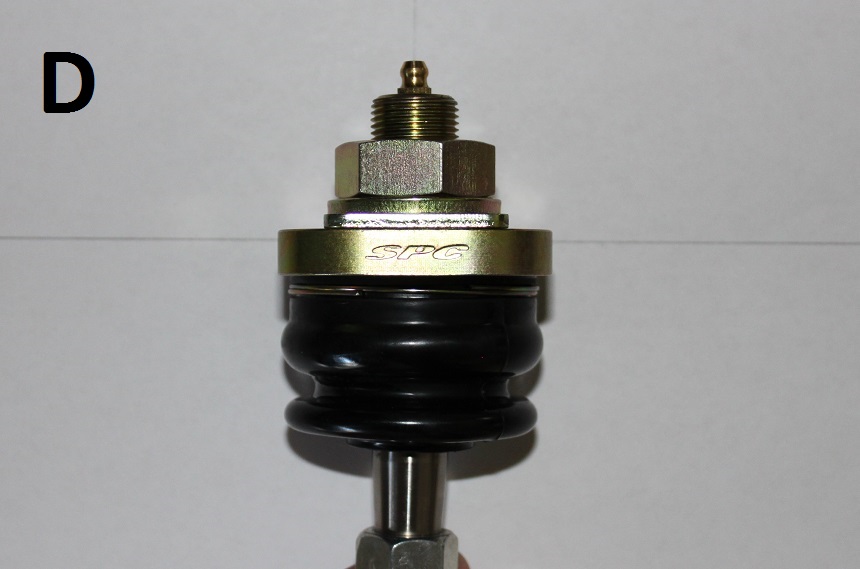

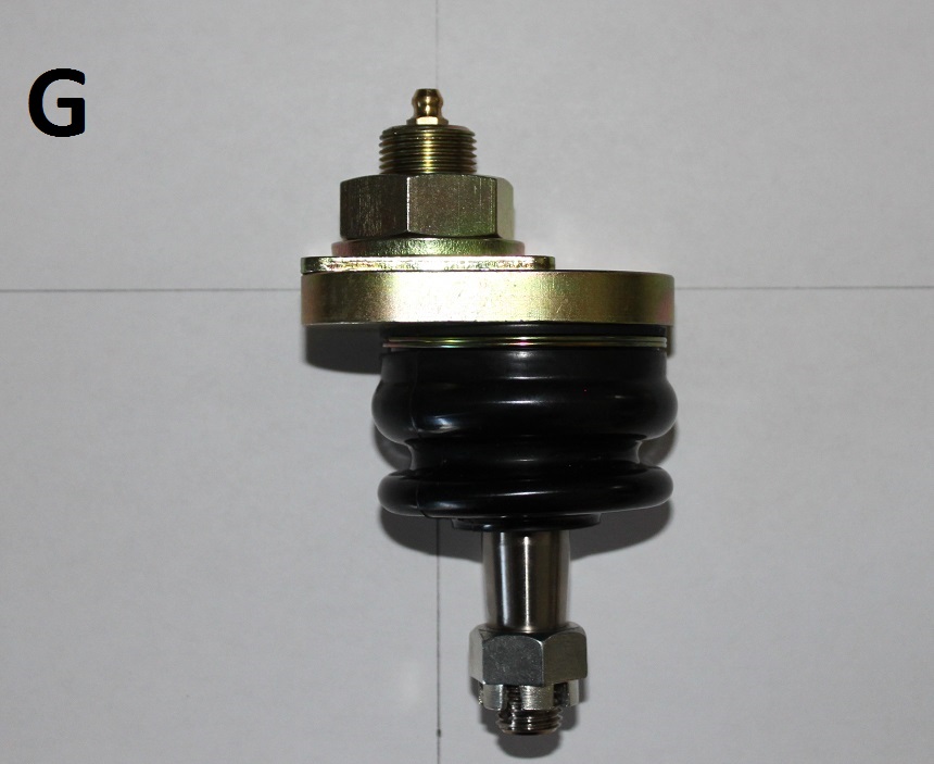

For some reason I am having a hard time grasping IFS alignment and why the G setting gets more clearance. Seems like more positive caster gets more clearance so why wouldn't A be better?
Really disappointed as I switched from D to G and lost clearance. Can someone look at these and tell me what happened?
SPC arms at D setting
SPC arms at G setting (sorry it is sideways)

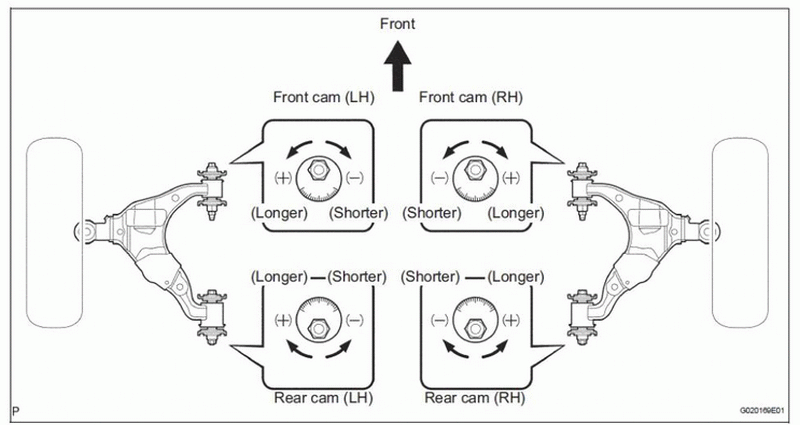

And when people talk about "All the way in and all the way out" I assume they are talking about shorter and longer based on this. I may play with it at home since I have to pull out my brand new CV that isn't sealing at the diff.
Sent from my SM-G930R4 using Tapatalk
All the way out...the upper ball joint.
It would be a camber setting...That 1 1/4" nut on top of the ball joint.
Slides in (towards motor) and out (away from motor).
Assuming your talking about firewall clearance. so, you lose clearance because your are "leaning" the UBJ backwards. Makes the caster angle greater but reduces clearance to the firewall. Increases clearance to the front though.
Shortening or lengthening the lower eccentrics changes caster and camber because the arms push (or Pull) either the front or the back of the spindle in or out creating a multitude of caster/camber angles
Try to picture this: Looking at your posted picture of the LCA cams. Look at the drivers side. Imagine putting your socket wrench on the rear cam and turning it counter- clockwise. Where the "+" and "-" symbols are heavy tabs protruding from the LCA that keep the camplates in place (the pieces the bolts go through that have the graduation marks on them and offset the LCA bolt which is the key to the cam adjustment) As the bolt/ cam asy turns, it is in an ellipse (because it is offset in the camplates) and moves the LCA bolt in (towards the motor-shorter)) when turning it clockwise and out (towards the wheel- longer) when turning it counter clockwise.
You only have to turn it 180 degrees using the graduation marks and the pointer above the cam plate. I've gotten my alignment done and watched the tech go round and round moving it in and out, in and out, and locking it in upsidedown. Not a big deal but it shows me the tech doesn't know how the cams work.

Actually, when people say "all the way in and all the way out", they're referring to the LCA cams. Fronts go full in, and rears go full out.
That said, you will have positive camber after doing that, and you will need to use the SPC camber adjustment to pull camber in at the UBJ.
Copy that, I thought we were talking about the SPC arm.

Seems like G would move the UCA to the front.
I guess with the interaction of the Cam bolts/LCA it pushes the tire to the rear?
Thinking the 'G' setting is like the stock setting.

I think the part that is throwing me is the ability to move the uppers in relation to the lowers. People say the most firewall clearance is with G so I am going to make another stab at that. Alignment shop has the front cams 180 degrees from where they should be so I am going to adjust tonight.
Have I met you yet?

I guess my question is:
What settings should I start with when I install my SPCs with Sequoia 17" rims and 32" tires with 1.25" spacers?
