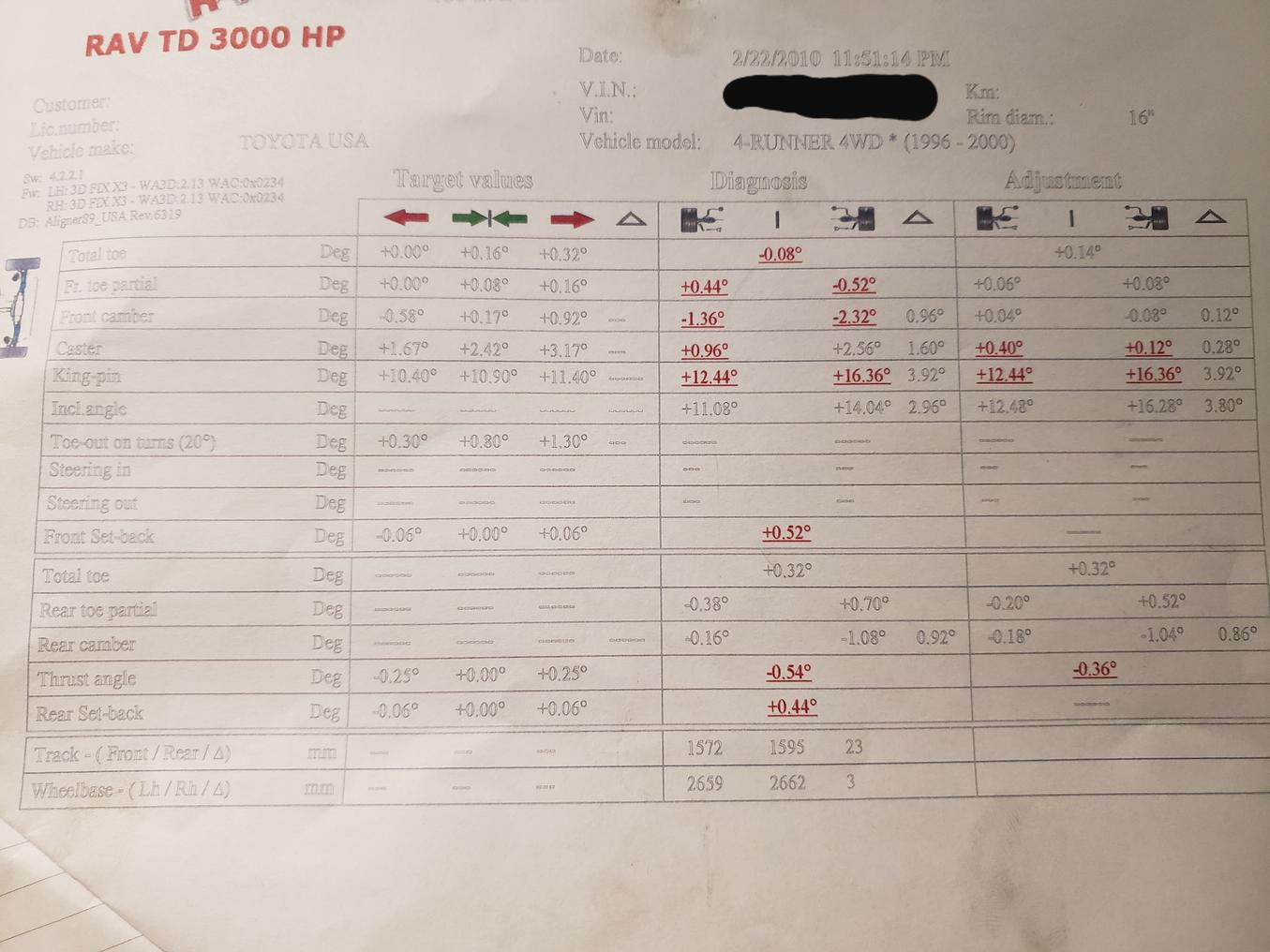

Hey guys, new to the forum but saw this thread and thought I would post up my alignment sheet. I just had King Coilovers (2.5"), 1.25" Spidertrax spacers and SPC UCAs installed on my 99' by Slee Offroad in Golden, CO and they also did my alignment. Truck drives great with only minimal rubbing when I hit a big bump while wheels are turned. I am running 285/75/16 BFGs.
Hope this helps somebody.

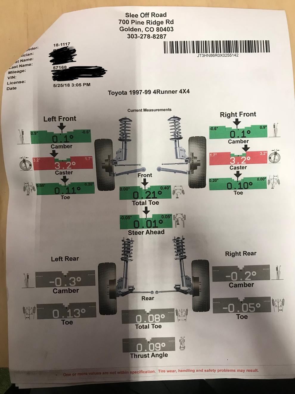

Close to 3" lift up front with bilstein 5100/Eibach 620 coils. SPC arms set to G for maximum clearance, still need some trimming with 35s.
What do you guys think? Slight pull to the left still but drives way better then it ever has, maybe I'll put sway bars back on for the winter lol.
You can see how bad my driveway alignment went from eyeballing it. Scary drive there!
