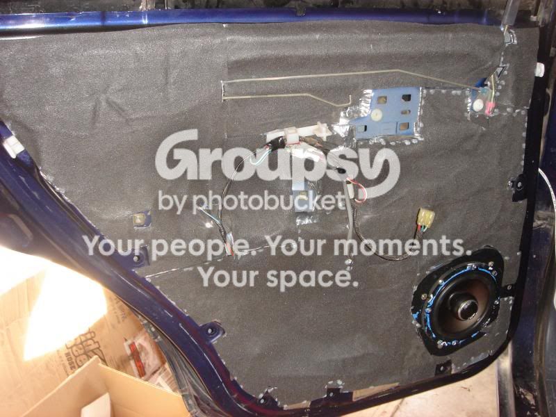

5.25 will fit in the back if you use speaker adapters, i bought adapters and spacers to make my 5.25 Polks fit back there. Buy these, make your own, or use 4" speakers for the rear doors.
I needed a hair more clearance on the back of the speaker to clear the window, so I built up the bracket some with silicone gasket maker before mounting the speakers.

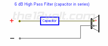

The 4" speakers are CONSTANTLY blown. When I went to the local shop here, they guy told me to use a "bass Reducer." Basically, it LOOKS like a capicator, but it's not. It gets wired into the positive side of the speaker, and does something with the signal or some bs. I don't know. I'm not an audio guy. I just know what sounds good to me.
They're like 10 bucks a piece for the things. If not less. should save the 4"ers in the back from blowing constantly.
I have JL 6.5s in the front and I put 5.25 JLs in the rear doors using the adapters mentioned above and have never blown them. I'm running a 5 channel KAPPA amp with a 10" sub and no issues.
Put 5 or 6.5 in the rear is easy. You only have to do a small amount of trimming with metal shears. It is easy just do it.

It is a capacitor.
High Pass Filters
High Pass filters allow high frequencies above a selected crossover frequency to pass, filtering out all frequencies below it. In a first order (6dB per octave) filter, this consist of a capacitor in series with a loudspeaker. Just above the crossover frequency, the capacitor begins to add resistance to the circuit. At the crossover frequency enough resistance has been added to equal the resistance of the loudspeaker and reduce the power by 3 dB or 50 %. One octave below the crossover frequency, power has been reduced by 6 dB or 75%. Each octave lower reduces the power by an additional 6 dB. The size of the capacitor will be determined by the impedance of the loudspeaker(s) and the desired crossover point. The smaller the size or value of a capacitor (microfarads, µfd or mfd) is, not physical size, the higher the high pass frequency will be.

I just installed Polk MM651 in my rear doors. It was a pain! First, in the stock location the magnet would hit the window. So I thought I could use a spacer, but that did not work because I then could not get the door panel back on. I had to trim a lot of metal to get the magnet below the window when the window is rolled all the way down.
If I were to do it again, I would go 5.25" coaxial speakers in the rear. Just get a quality speaker and you won't need bass blockers, especially if you keep the bass level down and install a sub.
