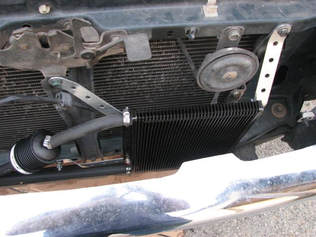

Finish my cooler install today. I used all existing holes for mounting. I decided not to install hose couplers and instead removed the factory hoses and connected the supplied hose that came with the Tru-cool kit. Turned out the hose supplied was the exact amount when I employed some fancy routing.
Good job BTO!
Did you install inlet up?
It's difficult to see from the picture but the bend radius on the
lower hose looks too small to me.
Thanks Alp.
The Tru-cool supplied hose is pretty stout and not easy to bend. I think I would have noticed if I kinked it on the bottom. I'm doing an oil change on her this morning. I'll give the hoses another look see before I put the skid plate back on.
I think I did end up with the inlet on top. I really was more concerned with hose routing. The stock hoses were very wimpy and felt like they might blow. I'm glad I removed them.

I did the same as the rest. I popped off the grill and unbolted the skid plate. Took me a while to figure out how to get the grill off. I had to press in on the top and bottom of each retainer to get them to release. The skid plate had one bolt that refused to budge. I ended up using a six point 12 mm socket with my floor jack bracing it up and actually lifting the front up some. It worked!
The cooler seems to work fine. I checked the bend radius of the lower hose and it seems ok at about 3 inches. The top hose is hot, the cooler is warm and the return line is luke warm. I don't have any other way to check it.
