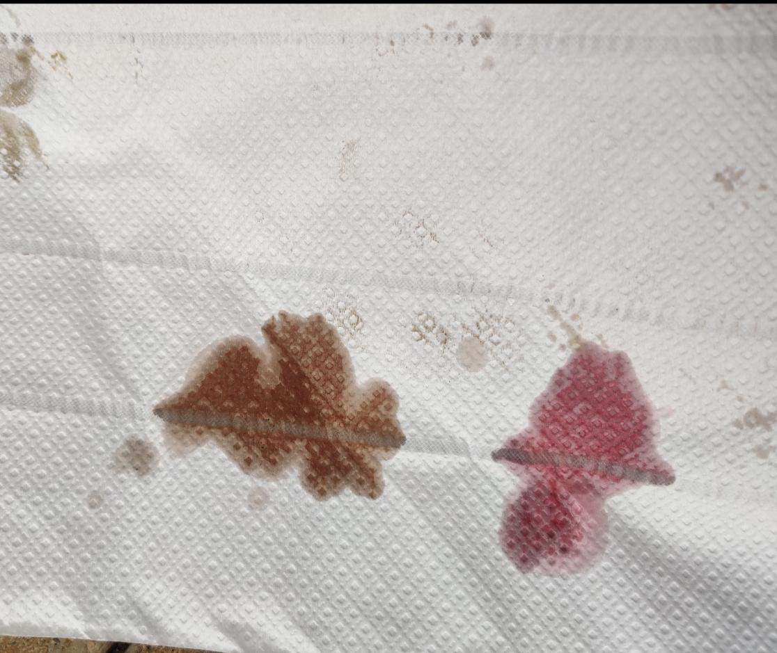

So had a P0977 error, decided to do a quick drain and refill ops, without dropping the pan. Tried the wire jumping method, and AT light stayed solid immediately and started flashing after about 8mins.
I used an elm bluetooth obd scanner and Motordata obd software to track the temperature as well.
The scanner read 115.27, the moment the AT light started flashing, and 98degF at the start of the process, hence i now understand why the AT light was solid from the getgo.
Will be using the bt scanner alone in the future.
Old vs new fluid
