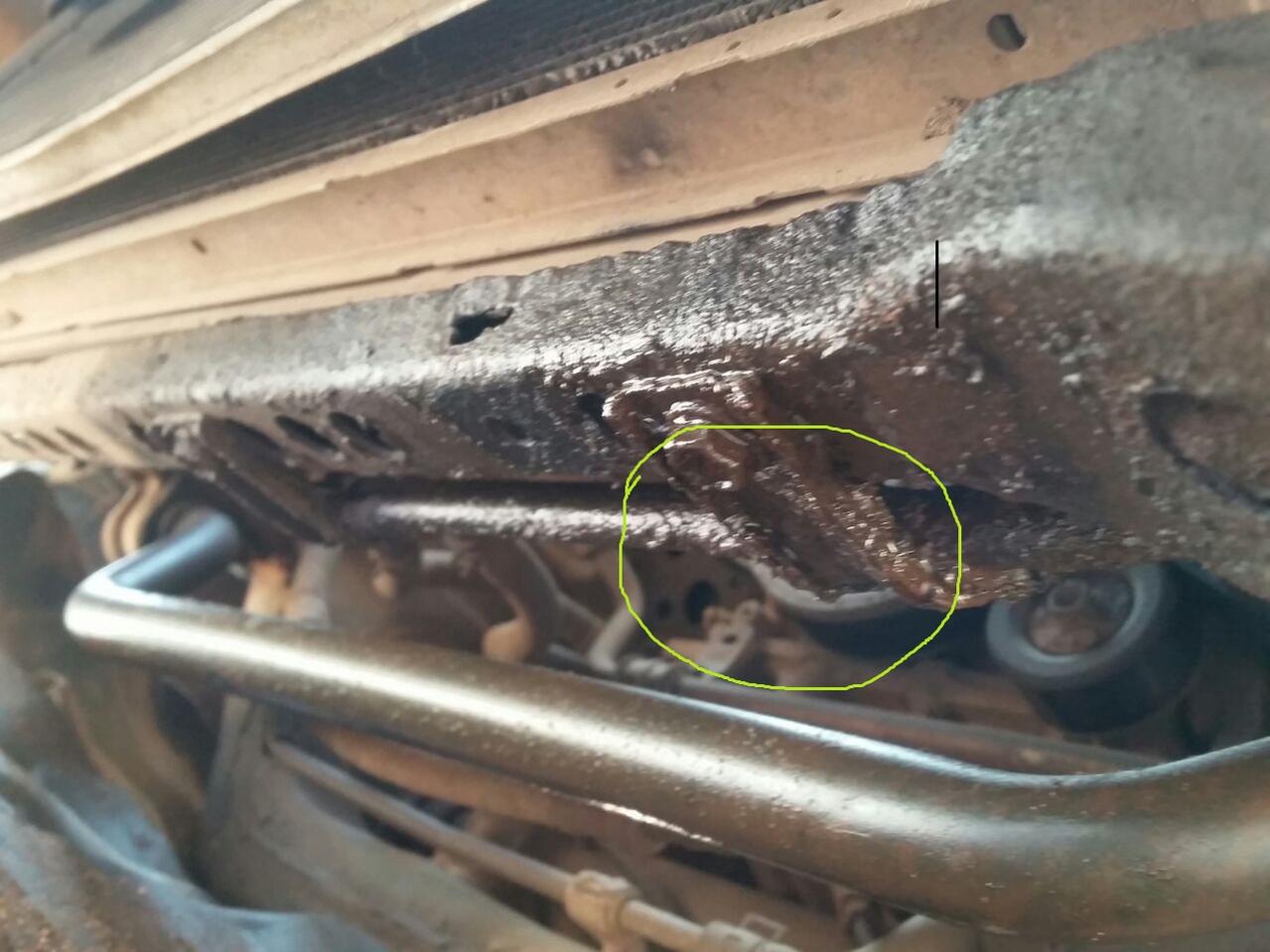

nice write up, just discovered my tranny is leaking from the cooler lines, will replace the cooler lines and drain and refill the tranny
