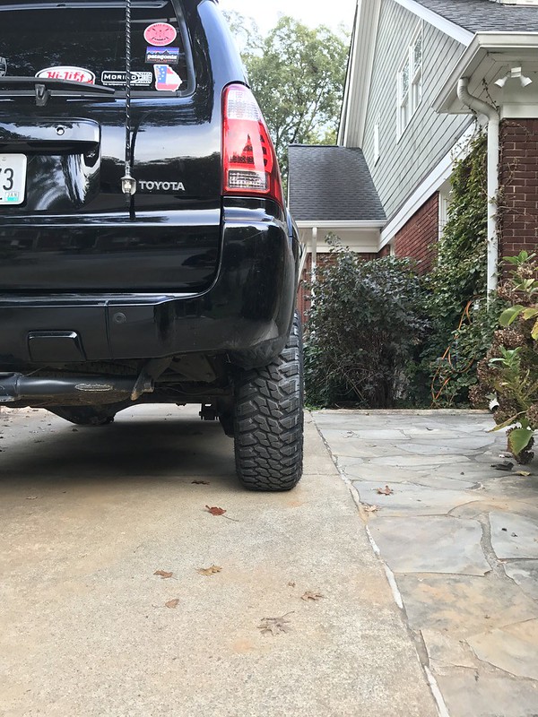

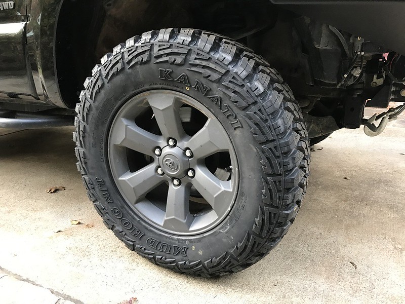

I've been real busy since my last post. I'm saving up for 275/70R18 Kanati Mud hogs and am planning a hybrid rear bumper and tire swingout build which will hopefully happen in the next two months.

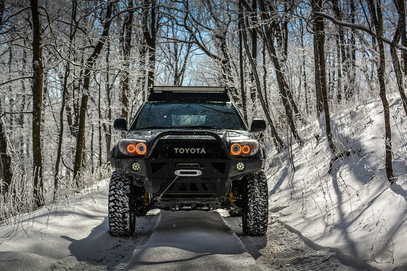

I found some nice logging roads over by our lake house on Lake Wedowee and then the day after I went and hit Beasley Knob. Unfortunately a rock thought I needed some body work done.
untitled shoot-010.jpg by muscarellaw, on Flickr
untitled shoot-006.jpg by muscarellaw, on Flickr
20161003-DSC_0019_zps0xjvwwbt by muscarellaw, on Flickr
20161003-DSC_0036.jpg by muscarellaw, on Flickr

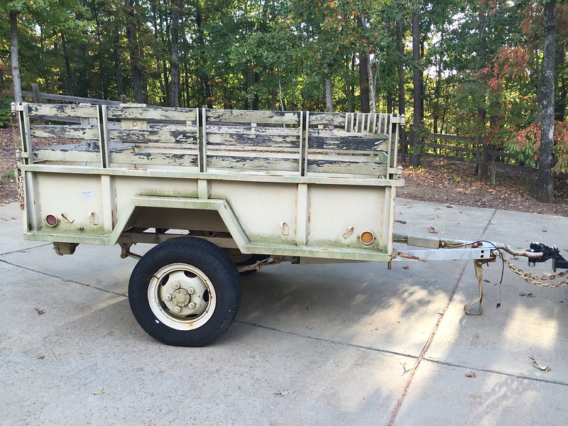

Bought a North Tool sandblaster and got to work on the rust on the trailer today. Ended up getting the front primed.

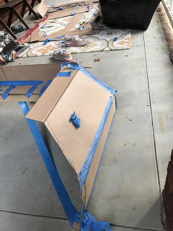

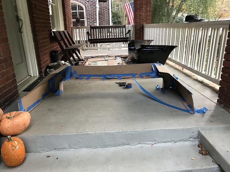

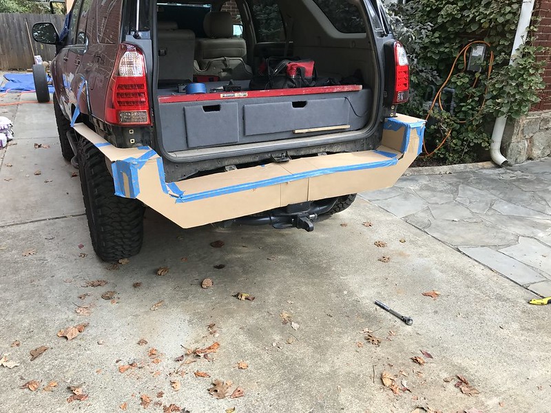

Started a new project. At first I was gonna cut the center of the bumper out and do a hybrid bumper. Then I was gonna do tubular corners. Then I decided why not full plate? I'm a little worried about the accuracy of cardboard but I think it'll be fine. I'm gonna build the shell first and then go from there with gussets and stuff. I got a lot of inspiration from crozfab's bumper.
Since I'm posting this all at once if you're going to quote could you please shorten the quote to the secion of interrest.

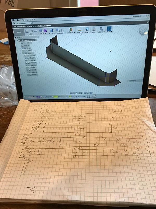

I started by modeling it out of cardboard AKA CAD (cardboard assisted design). Once that was done I took a stab at Fusion 360 (not solidworks since I have a Mac) but that proved to be more trouble than it was worth so I ended up going back to paper and pencil.

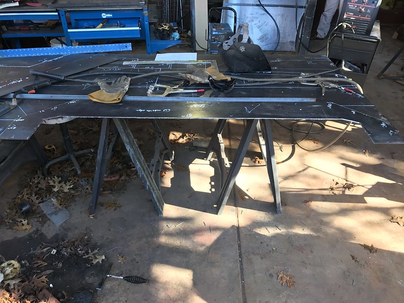

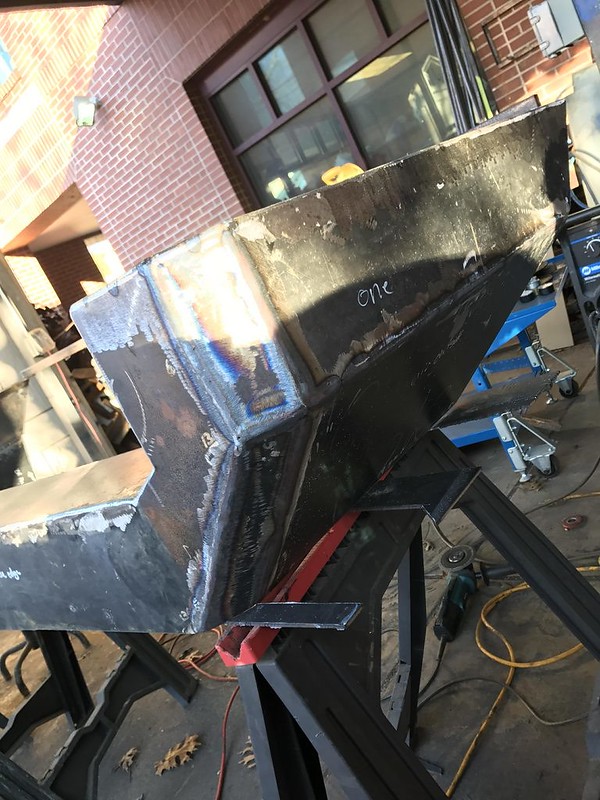

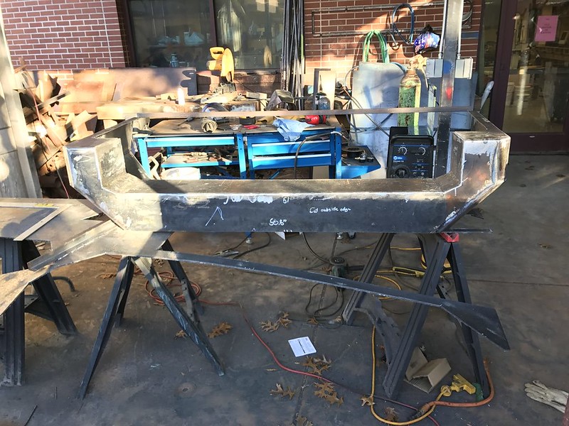

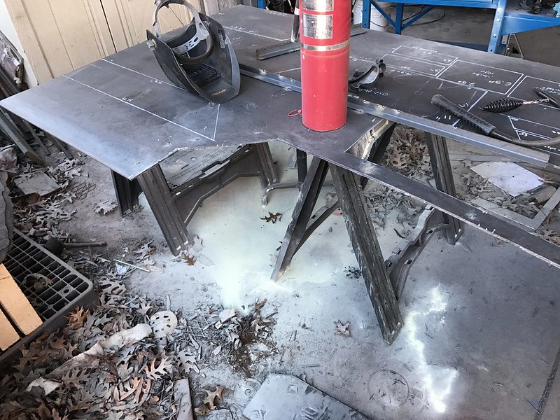

I then was finally able to get my money's worth out of my school tuition. The school bought me the sheet of 3/16" plate all I had to do was supply the other parts and the gas consumables. We have a Miller Spectrum, Miller 250, and Hobart Handler at school but we only use flux core. Had a little mishap with some leaves, a sawhorse, and the plasma cutter when I forgot the horse was still underneath.
UEzAtf8h by muscarellaw, on Flickr
C7giPMPh by muscarellaw, on Flickr
c3CwFXSh by muscarellaw, on Flickr

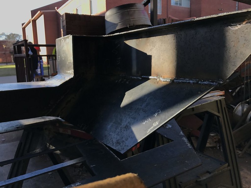

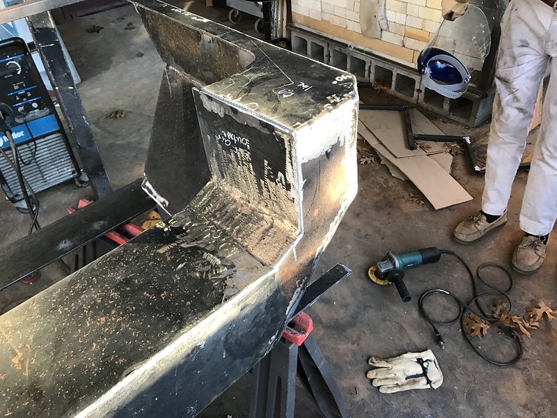

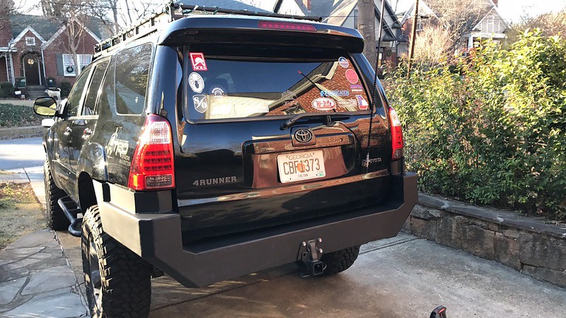

My buddy and I put in 3 and 1/2 hours and it's finally looking like a bumper. Went through 4 grinding wheels in the process and I'm dead tired.
dMbHiMah by muscarellaw, on Flickr
nNQECFgh by muscarellaw, on Flickr
r9dTj4Sh by muscarellaw, on Flickr
BeUgpj7h by muscarellaw, on Flickr

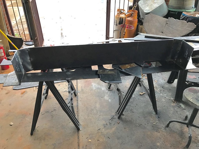

Now I just have to put a lip on the bottom make some fender liners and get the brackets fabbed up. Then it's onto the tire carrier and hitch.

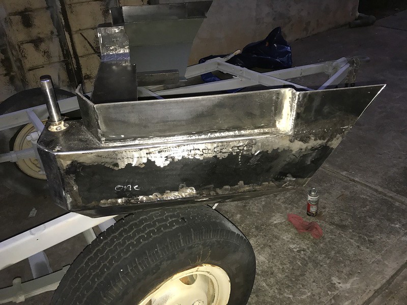

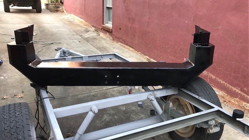

Took it home today. Didn't exactly fit in the car though. I got the bottom piece welded on. I'm trying to decide if I should grind the welds or just leave them since it's the bottom. Let me know what y'all think. Worst case I can go back later and grind them down. Test fitted it. It's now a bit tighter but I forgot to weld the frame rails on before putting the lower lip on so I now have to go back in and cut a section out of the bottom. I still have to weld some angle iron between the sides and the frame to brace it. Instead of making a hitch as I originally planned I just bought the factory small one. I also decided against doing d-ring receivers since my welder can't do 1 in so I'll just stick with my hitch d-ring thing. Moving onto the tire carrier arm now which was crooked on the first try. These are just pictures I've been taking along the way.
IMG_0224_zpskam2pqeo by muscarellaw, on Flickr
IMG_0225_zpsatvwz0wl by muscarellaw, on Flickr
47E2AF1B-7E68-44A8-8947-89B2966A25B7_zpsd5taxhv3 by muscarellaw, on Flickr

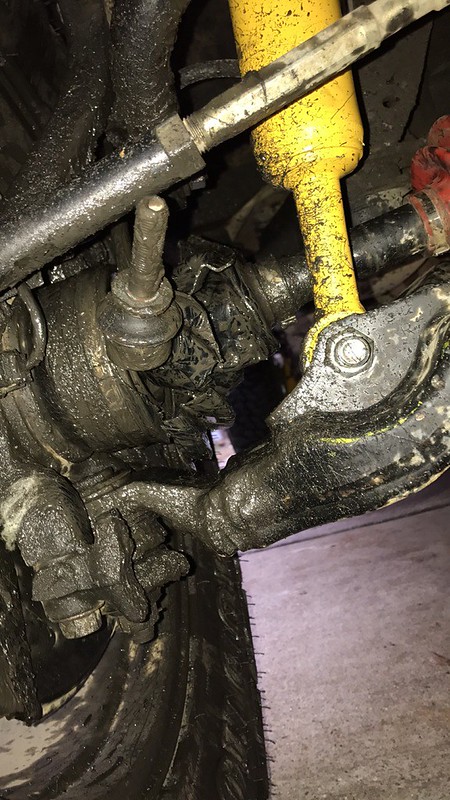

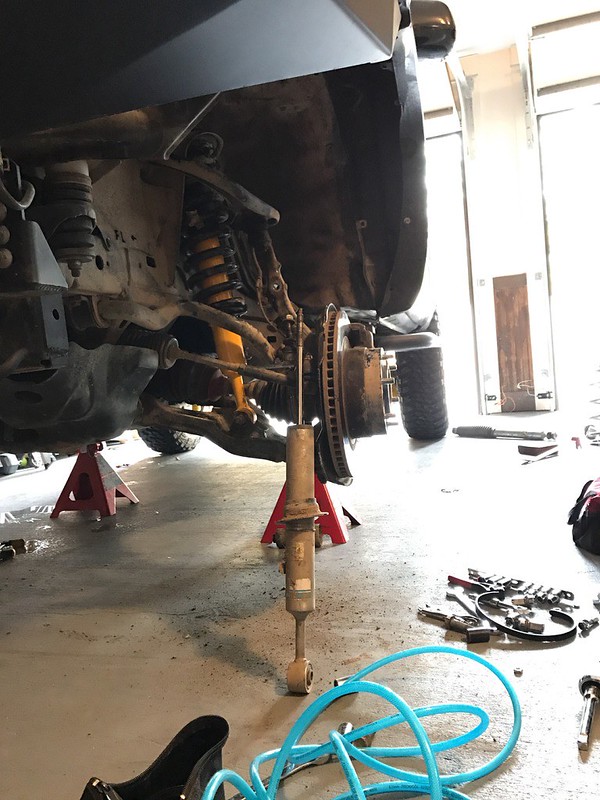

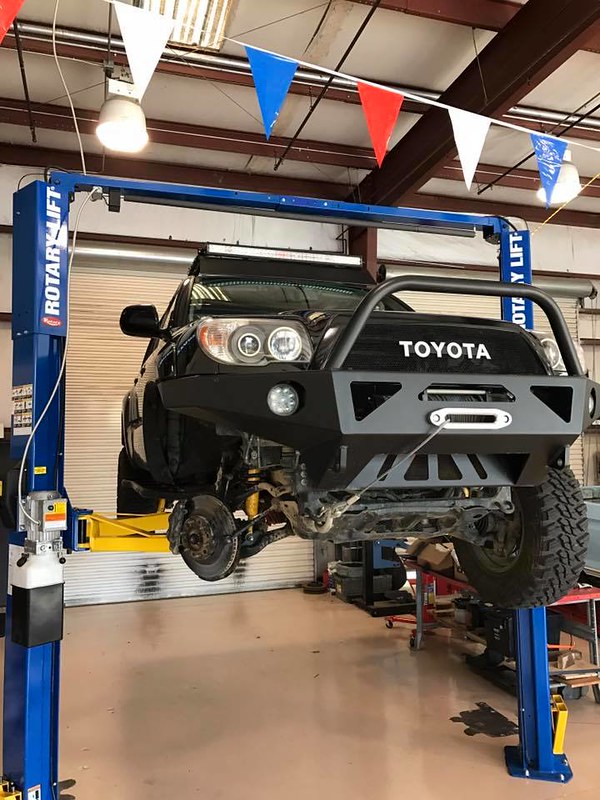

Found the time to put in my OME front and the OME 5th gen 440 lbs rear. I forget the front part number but they ride great with my 886's. The rear is 898 and 60080. It's pretty stiff right now but it'll hopefully be good once I get the swingarm built. Unfortunately the swaybar came undone and made a mess. It ended up having to take it to GAS in woodstock to have my buddy remove the axle which was really really stuck in there. I then rebooted the axle and stuck it back in. Hopefully once I get my nice hose clamps for my CV axles I can finally get back out on the trails.
IMG_0231_zpsbucmwmwb by muscarellaw, on Flickr
6CE0D921-6075-41D5-9FA9-C45957B5D37A_zpsjfyckhh4 by muscarellaw, on Flickr
15747838_1771470666510270_5506944256990593765_n_zps7plmgykz by muscarellaw, on Flickr

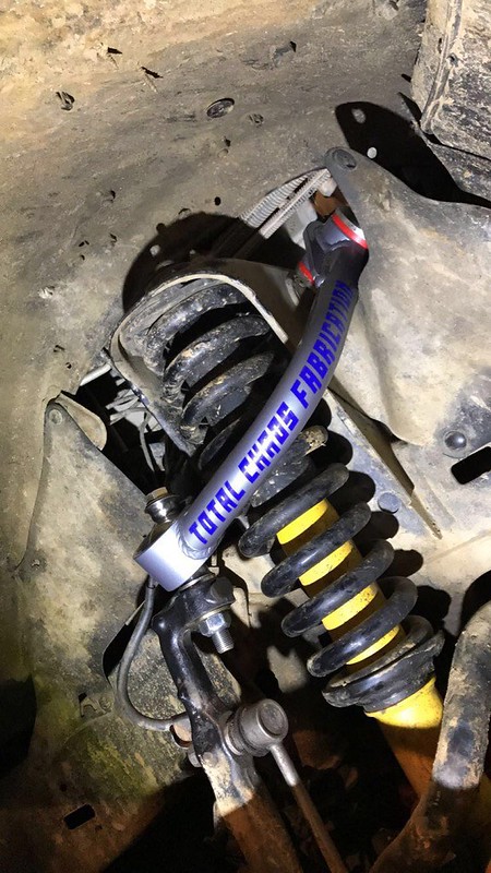

Also finally bit the bullet and bought some Total Chaos UCA's

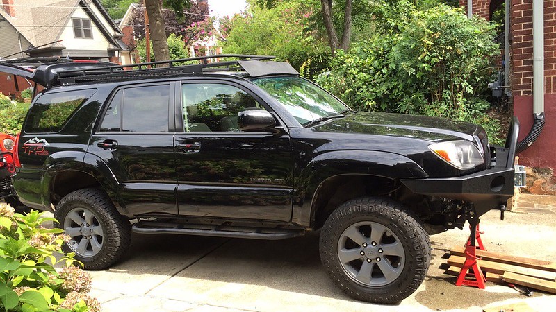

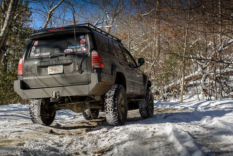

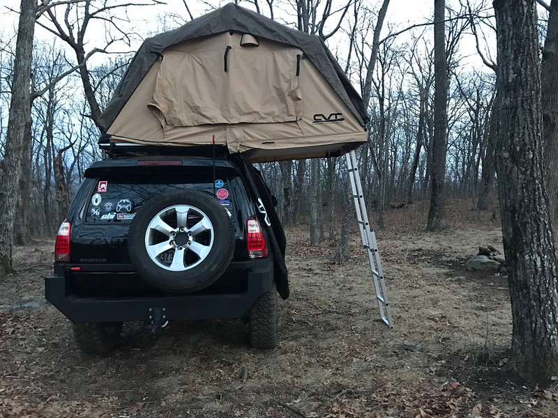

And I finished the tire swingout (still gotta add a jerry can mount, lights and stuff, and a full sized spare) and got a good deal on an RTT. I worked a bit on the trailer and got the frame and underside rhino lined but haven't started any of the cool stuff yet. I've just got too many projects.
