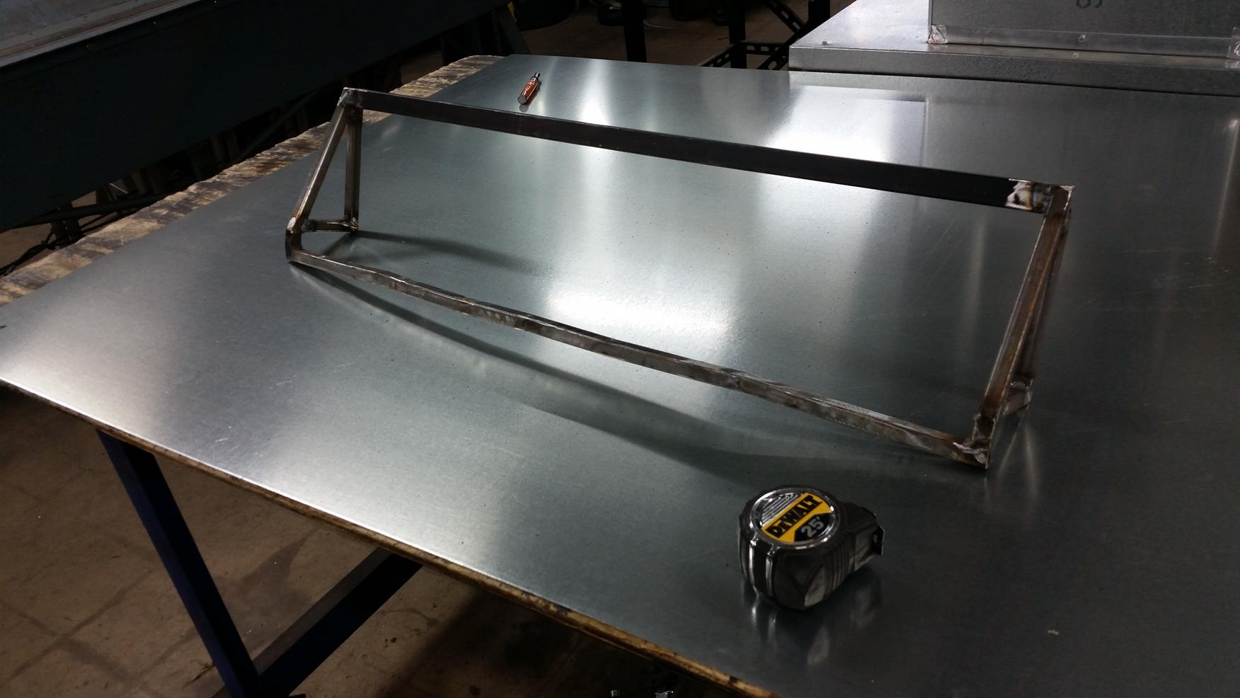

The next goal is to start making the front of my truck look better. I can't wait to get rid of the chrome tape. Here's the frame for the front of the roof.

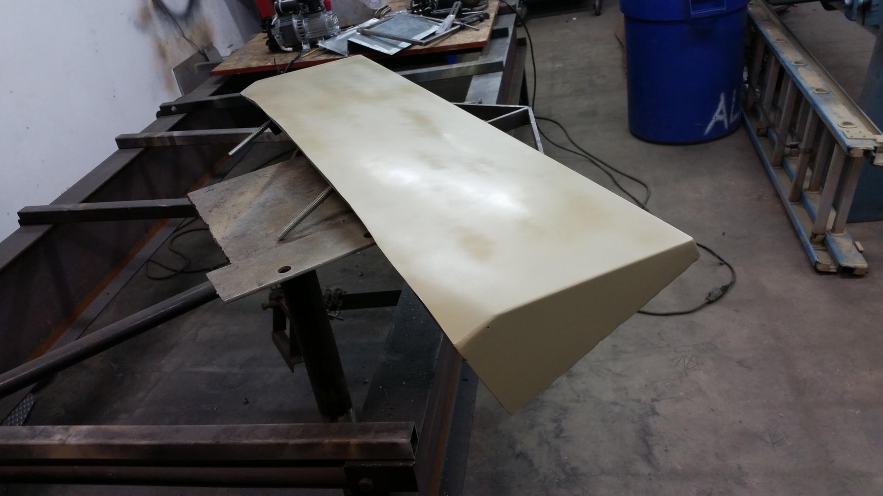

Got It skinned and painted. I'm going to put marker lights on the sides and I'm fabricating some custom light mounts for the front.

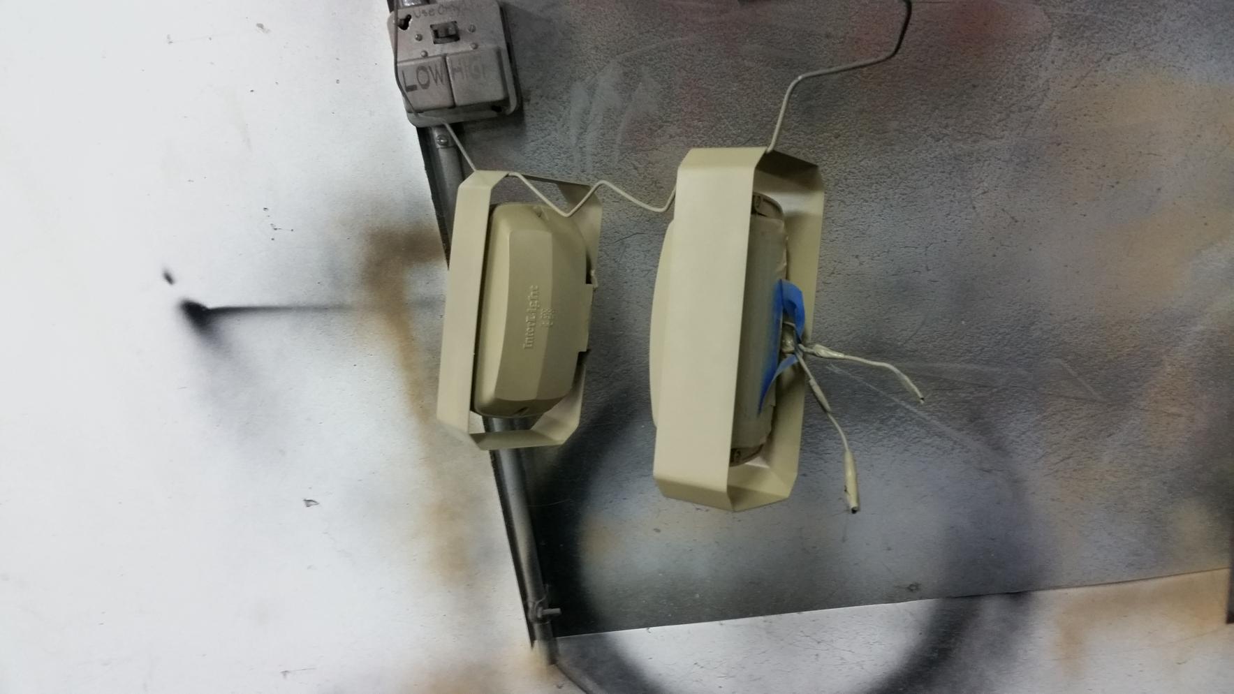

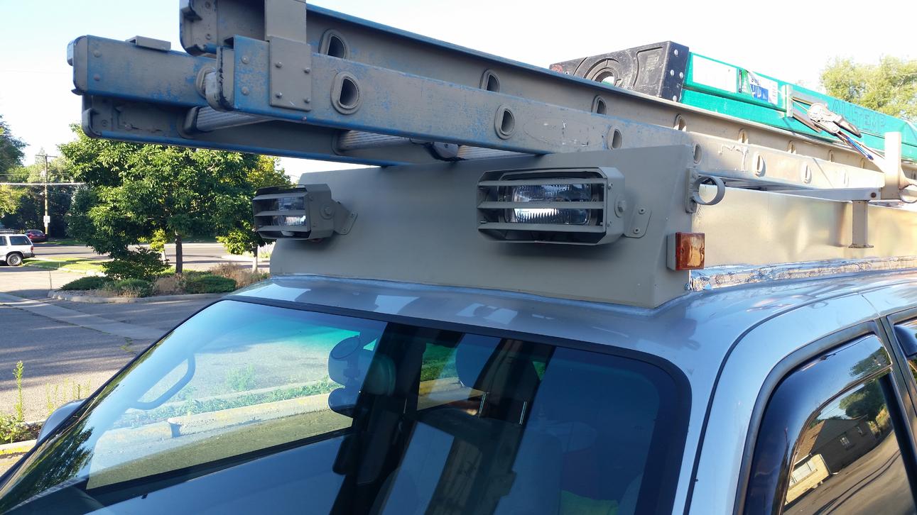

An update on the roof. I just finished a pair of lights for the front. I took an old pair off my rally car and made the surrounds to update them.

Amazing amount of work that you've put into this rig. Can't wait to see the finished product. Starting to look like an MRAP type vehicle! I was afraid enough to drill a few 1/8th inch holes for my JDM mirror and rear wing, but dang, you cut the whole roof off!!!! Keep up the good work.

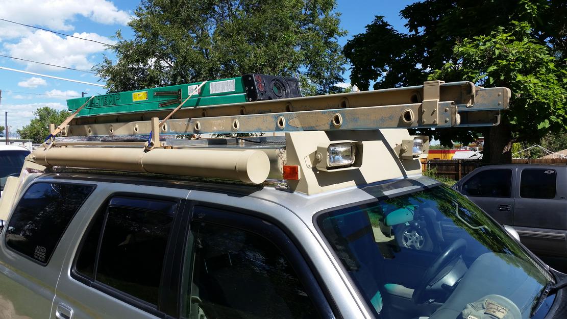

Got the front on and roughed in the lights. They still need a few more rivets and will be getting mesh or lexan covers. I plan to add more lights when I have the money.

Got the front tie downs on. I also made grills for the lights that give it a more mrap look.

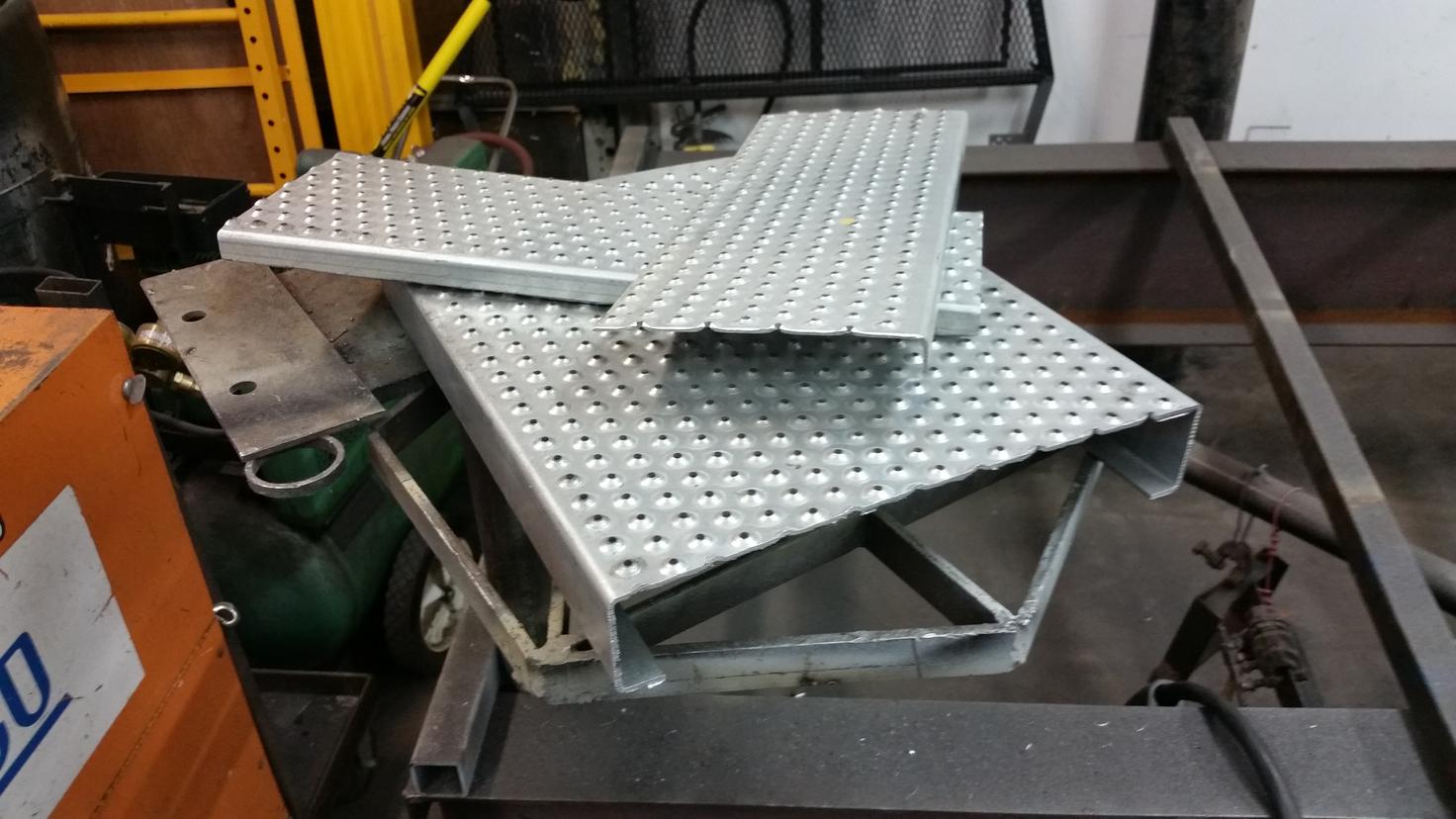

I started laying out fold up steps for the rear bumper.

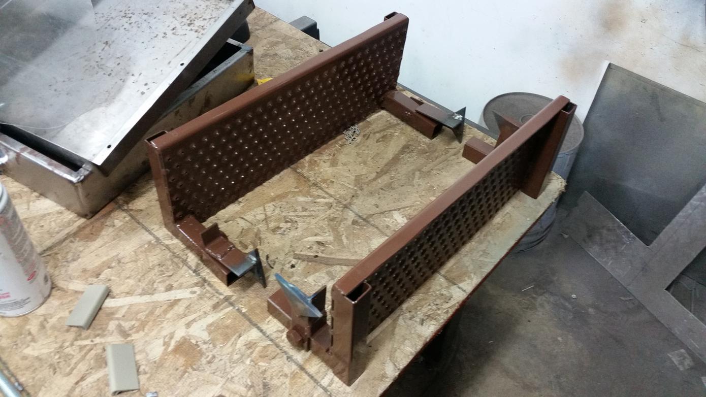

Steps are primed and ready to weld on tomorrow. Should make it easier to get in and out of the back.

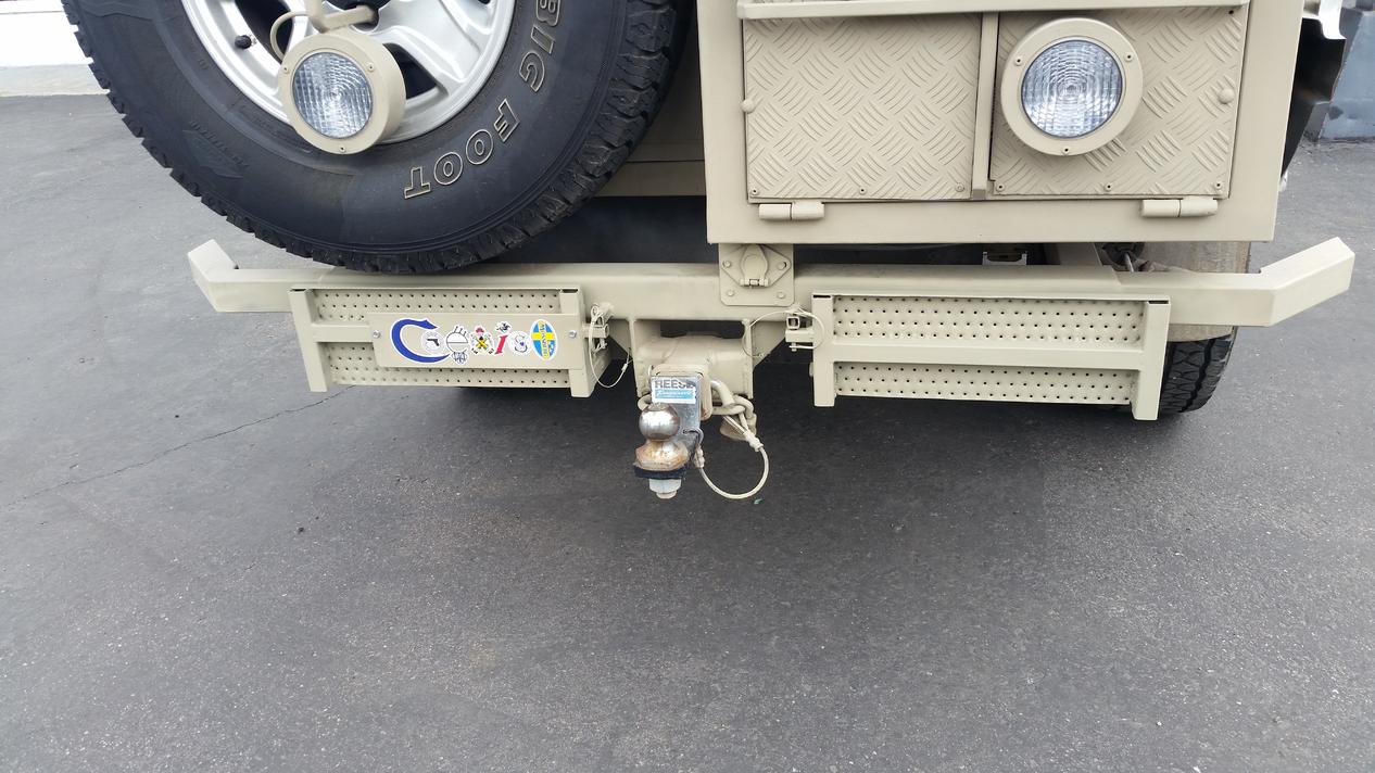

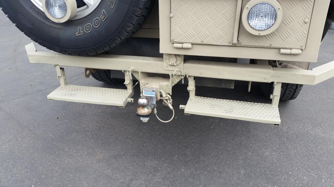

Here's the finished steps up for clearance and down for use.

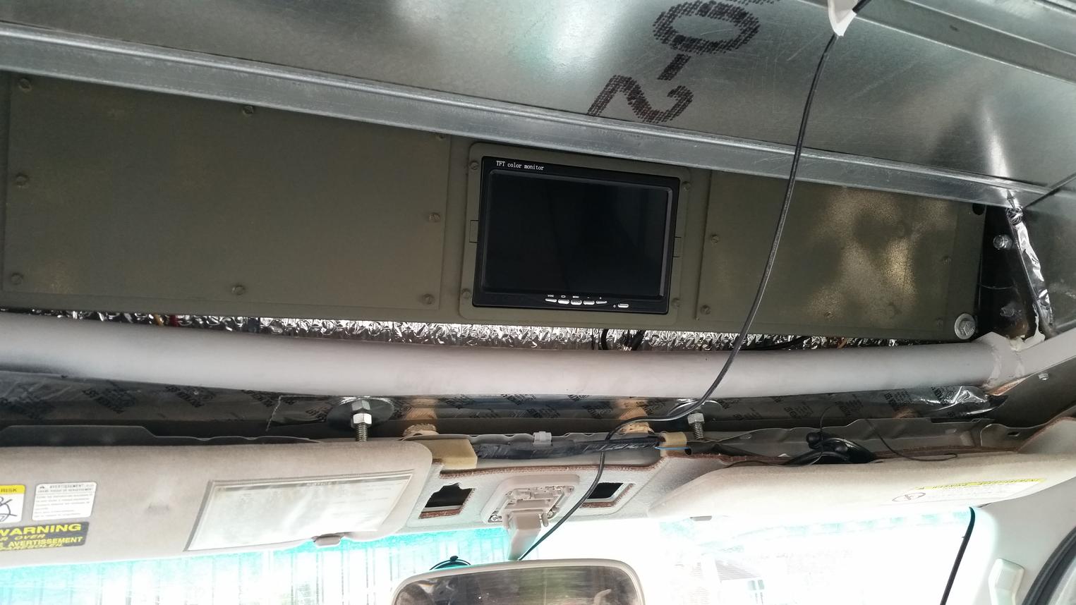

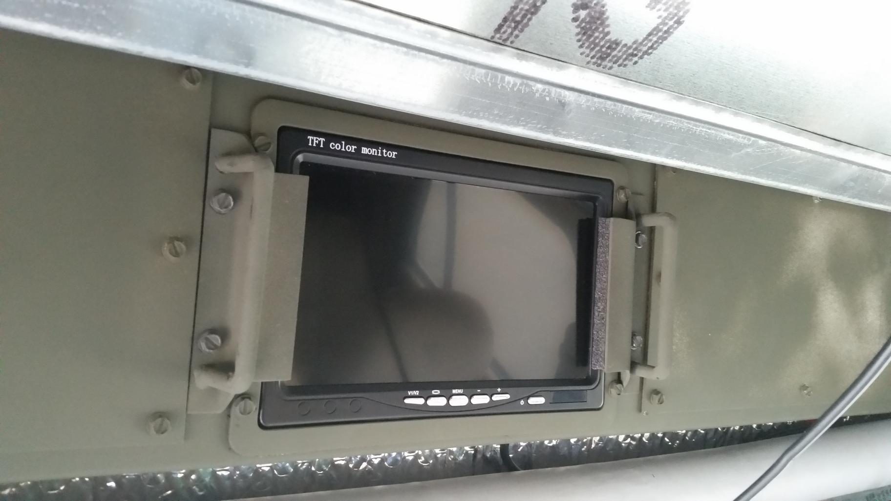

It's still a work in progress, but I have the control panel in. All the shiny metal around it is temporary and kinda crooked so imagine it's not there.
