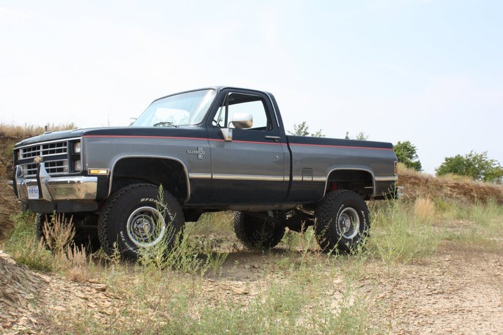

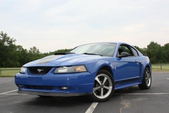

So this post has nothing to do with my T4R. Just going through old photos and found some shots of my old rides. Here are my old 1986 Chevy K10 and 2003 Mustang Mach 1.
The Chevy
Before
After
The Mach1

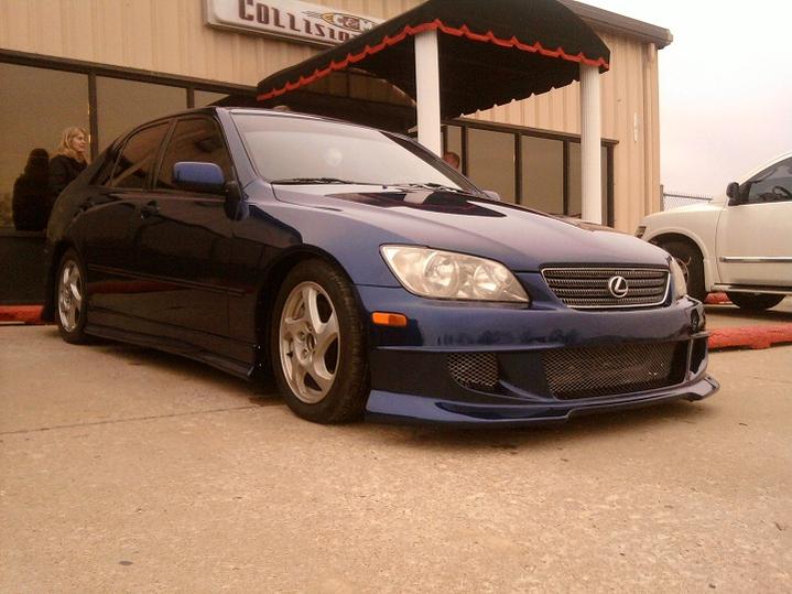

A shot of my buddies IS300 for kicks. It was a little too low

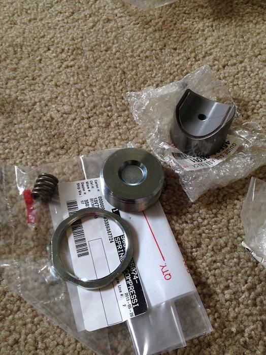

Well before I moved back to OK for the summer I went an ran sevenmile creek again with my parents and a buddy. It actually lived up to its name this time. Got water halfway up the tires on the creek crossings. Scared the crap out of my parents :lol:. But afterwards my steering rack was pissed. Its clunking all over the place. So I did some looking and the rack guide looked like a likely cause. My steering was pretty sloppy and I had some vibes anyway so it seemed like it was time to do it. I'll be tackling that this weekend along with my tranny cooler and some ARB trimming.

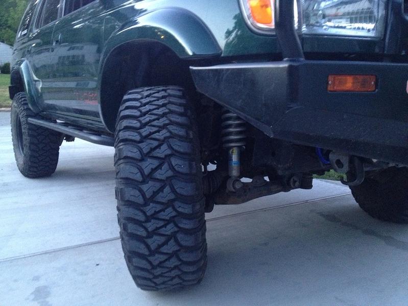

Looking forward to the trimmed up ARB, really improves the looks to me. And hell, who doesn't like more ground clearance?!
Agreed. It's going to start slow but I'm sure ill chop more soon. For now I'm trimming the sides. One of them actually rubs my tires haha. May do the front too depending on how off it looks with just the sides.
Can anybody comment on structural integrity? I feel like the bottom lip adds something to the bumper. And while I could just weld in a new piece in the back, I would prefer to be sure I need it first
I'm pretty sure BFAD trimmed both sides and the center on his, the bottoms may add a bit of extra strength but based on the design and ARB design philosophy so to speak, i wouldnt doubt if it was there just to be more compatible with the back or front of car in an accident, to keep from being much much higher than the crush zones on a smaller vehicle.

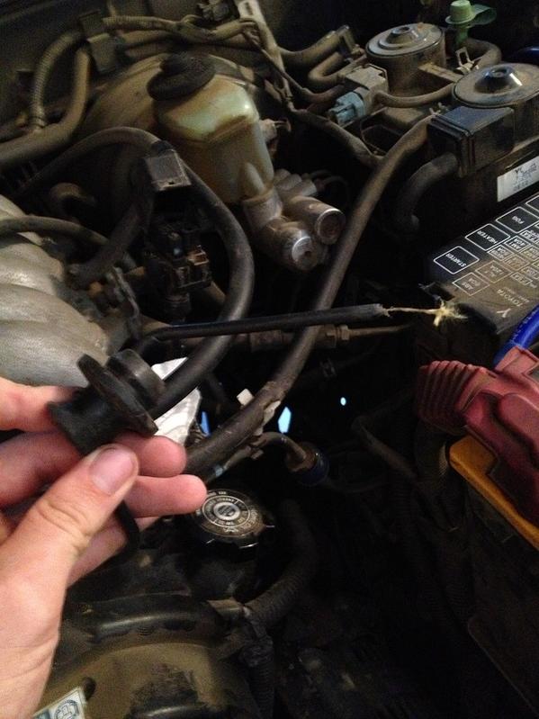

Well the tranny cooler turned into an ordeal. Couldn't get the right sized line to fit (regular 5/16 tranny line would NOT go on no matter what I tried) so I had to order some. So I'm sitting there like while I'm ordering stuff I should check my plugs and see what condition they are in. And then this happened.
:bash:
Oh well. I added NGK plug wires to the list. Finally pull the plug out and its a single ground NGK. That blew my mind considering my timing cover has a stick that says dual ground plug only. Add spark plugs to the list.

Fast forward to yesterday and I finally get all my parts in. Replace the plugs and wires, route the tranny cooler, new steering rack guide, and trim my ARB. The biggest surprise of the night was that we finished before dark! Onto the pics
Steering rack parts. New vs Old

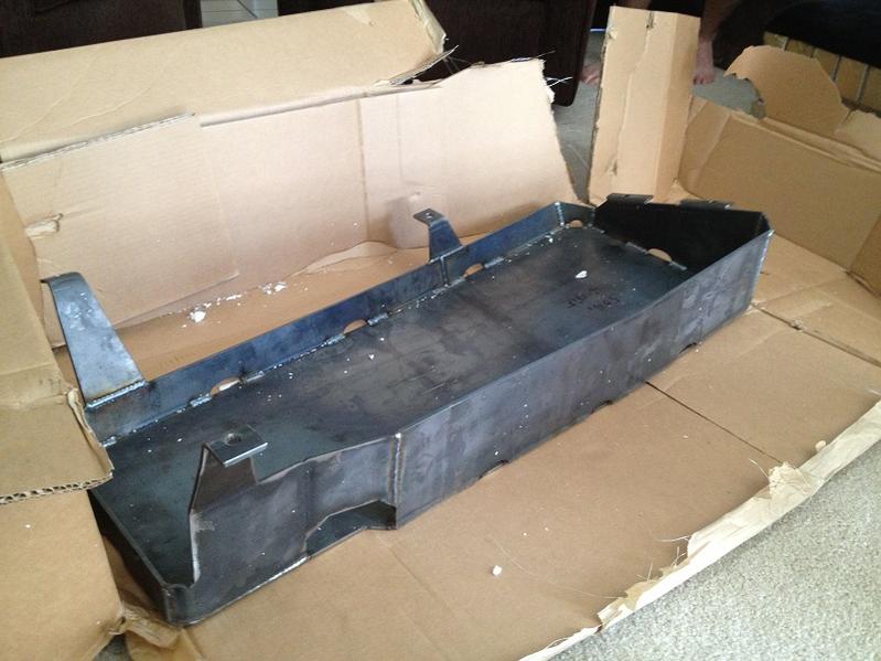

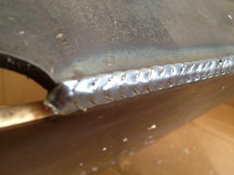

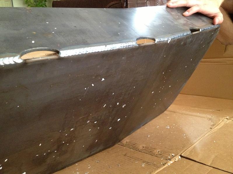

Got a package in the mail today :biggrin2:
It will be going on this weekend along with rear brakes, spark plugs, and a well needed wash.

That's awesome.. I need to look into this. My stock tank skid has seen better days. Either that or finally find some motivation to do the f150 tank swap. Hell, my fuel gauge doesn't work anyways lol. Good work on the ARB bumper, I want to see more pics of it.
[MENTION=88391]NateMob[/MENTION] it's all 3/16" steel. Got cutouts for draining water. Another one where we usually have driveshaft/gas tank interference. The mounting points are also 3/16" steel if your curious. They aren't on the website so just email Darren at [email protected] and he will set you up.
[MENTION=58830]ARKRWLR[/MENTION] do the F150 swap if you don't have a gas gauge already. I would but mine works currently. My stock tank skid probably isn't as bad as yours but its still beat up and rusted. I guess it's good I got one because I trashed mine on a rock last weekend haha. Ill get more pics of the ARB this weekend when I finally clean it. The trim is subtle but it I think it really helps with the look and the clearance.
