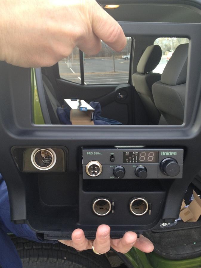

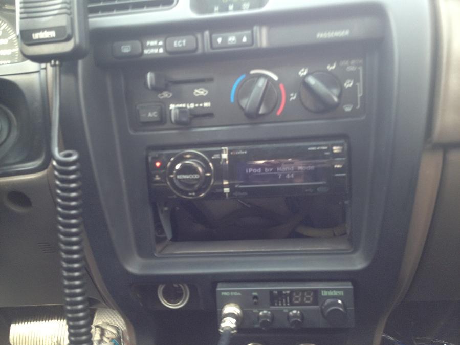

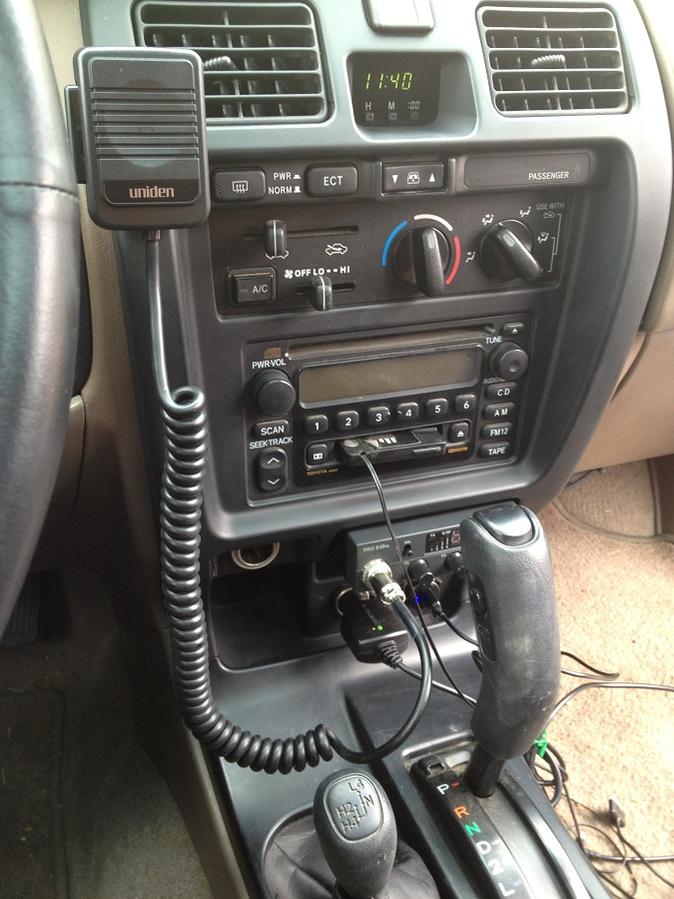

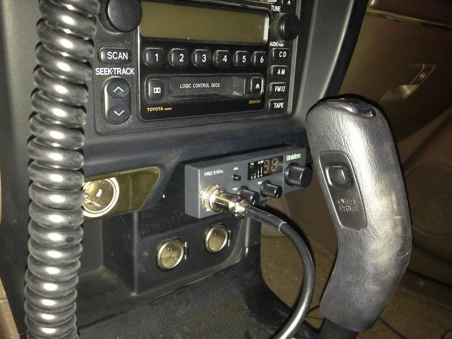

I'm heading out wheeling tomorow and some of the guys have CB radios. Sounded like a good excuse to get one! So I went to a shop (CB Shop & More, its a great place off of I25) and picked up a Uniden Pro 510xl. Put it in the ashtray and I love the look.

Nope. Super simple. Power wire, ground wire, cable to the antenna. Only thing that you can't do (unless you have the meter) is tuning the antenna to your truck. The shop i took it to did it for me and it took like 10 mins.

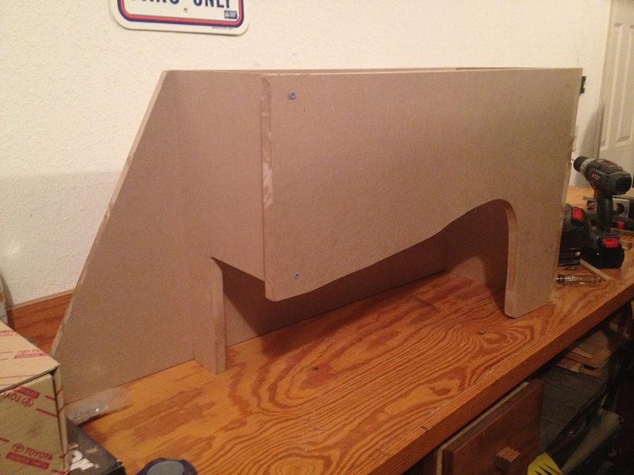

Funny you should mention that. I was just about to do an update on my truck haha! As was posted earlier in this build I acquired a set of 9 wrap coils a couple months back. Well for Christmas Santa brought me a set of Eibach/Toytec 112620 coils to stick on the front. Those are both sittin in the garage waiting to be put on in the next week or so. Santa also brought me a 12" Kicker CVR so me and my buddy decided it was time to go at our cargo box builds! I dont have that many pictures currently but I'm doing more work on it today (the 28th which is coincidentally my birthday :happy bda ) but here are the ones I have.

First cut
After many cuts
This box sits on the driver side and will be used for tools and recovery equipment etc. The other box willl house the sub and amp. Not quite looking forward to the other box as it will have to have some funky angles and will be sealed for acoustic reasons. Oh well you know what they say, measure once cut twice......wait :bash:

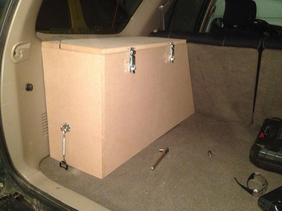

First Box Done! sorta
Well I finished the first box, except for carpeting. But who knows when I'll get carpet haha. I'm in the process now of building the second box which will house my sub and amp. I apologize in advance for the blurry pictures. They were taken when I finished the box last night at who knows what hour in the morning.

Thanks man and happy belated birthday then! And to be honest it's pretty easy just gotta be patient with the wood and not expect the first cut to be perfect. I dunno how many times i took the board I fitted to the wheel hump back to the jigsaw haha!

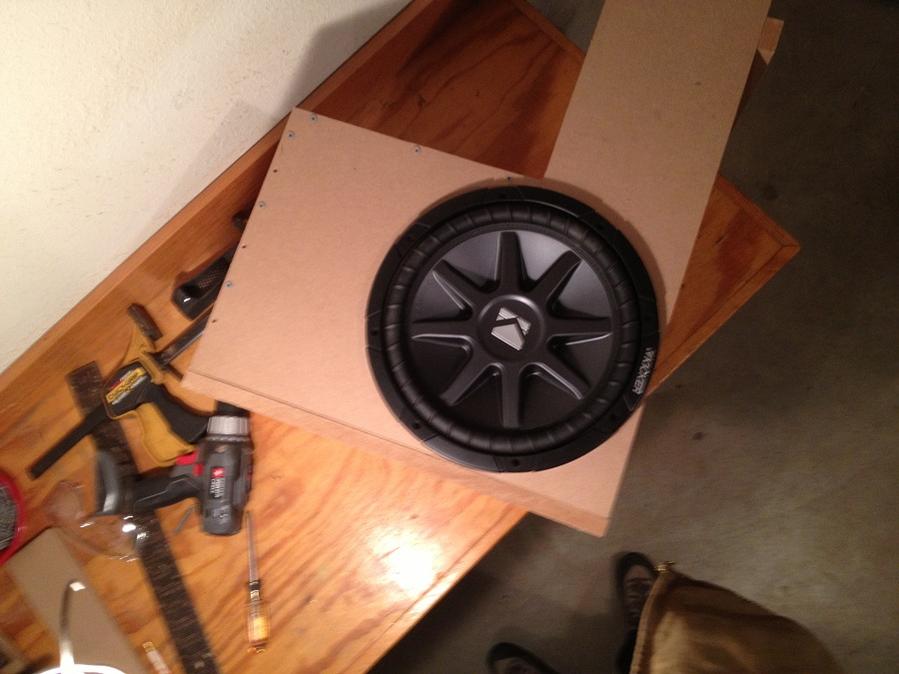

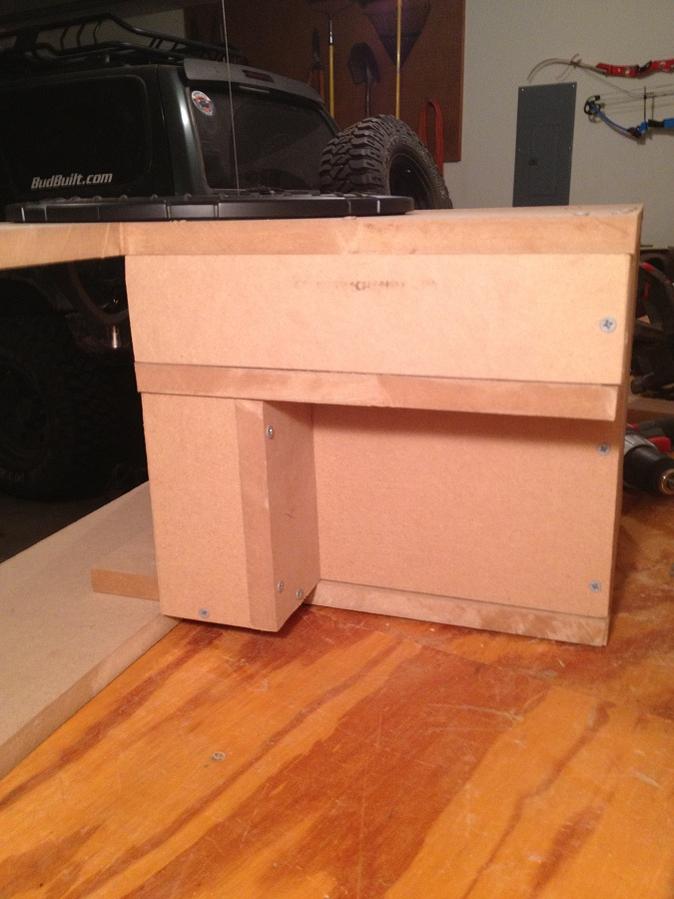

Sub box coming together
So I've been working on the sub box and it should end up pretty sweet, we will have to see though. Here are some update pictures.

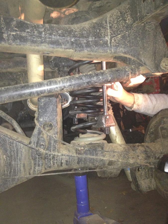

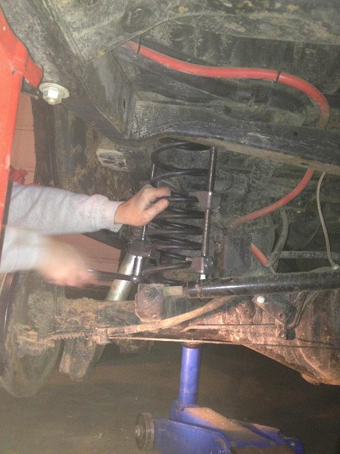

9 Wraps In

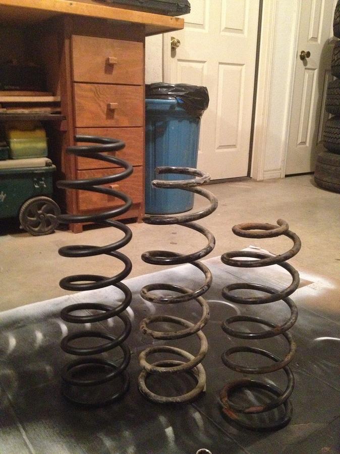

Well I finally was up and nimble (enough) to get my 9 wraps in the rear end. I used a coil spring compressor to get them in so I wouldn't have to unbolt everything. I'm sitting at about 24" or 23.5" hub to fender in the rear and currently 21.5" in the front with my TRD Tundras on the 2nd perch. Tomorrow I'm getting my Toytec/Eibachs on and hopefully that will lift my front end up a bit. Can't wait! While I was crippled I ran some wires and did some soldering so my head unit is in (pocket missing for now) and the wires have been run for my sub. Oh and Weathertechs are on the way!

9 wraps vs 7.5 wraps vs stock
