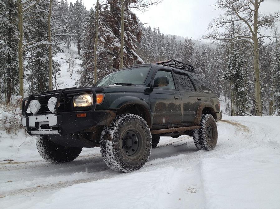

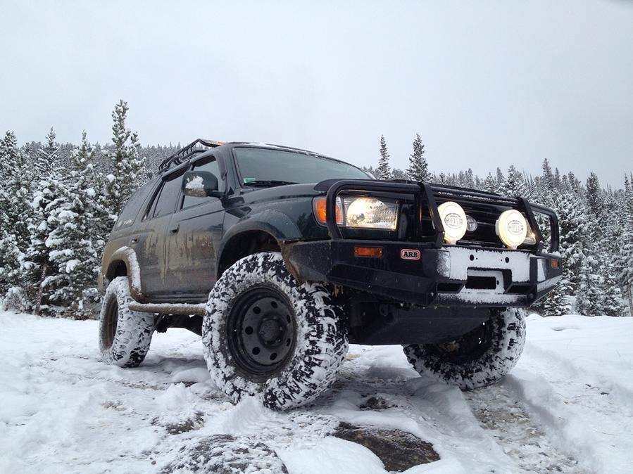

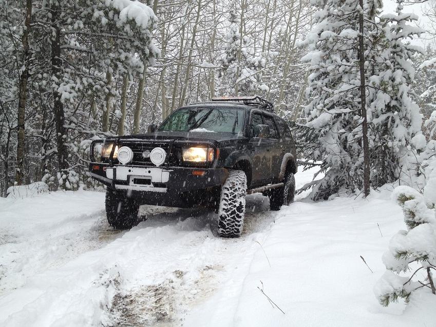

So today I decided to take the Runner out for the first snow I've had her for. Tried to go up to West White Pine Mountain and or Monument Gulch and both were closed. I ended up doing part of Greer Road (I think) and some random forest roads.

Very nice pics man! I really can't wait until my wife and I move to Colorado...this time of year makes me depressed that we aren't there because we love snow and cold weather...
JEALOUS!! So pumped to see some 3rd gen snow wheeling action! You may have just motivated me to go out this weekend.....

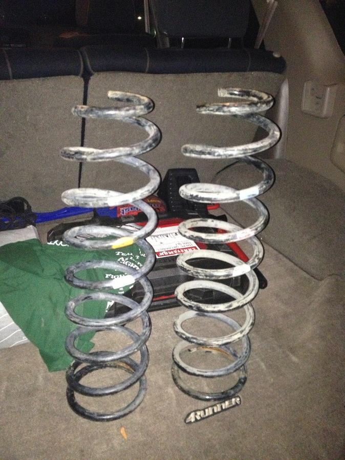

So I bought my truck an early Christmas present today. 9 wraps!! Thanks to the guys from Irbis Offroad. Color code is blue pink white if your curious.

Very nice! I just installed my 8.75 wraps this weekend and I love the raked stance. Are you going to be getting new shocks, panhard drop bracket, extended brake lines, and/or extended bump stops?
From the Sonoran steel kit I have extended bumpstops, extended rear brake line, an adjustable panhard bar, and longer bilstein 5100s. So probably nothing else in that category. Ill just see when I get them how it rides and flexes wether or not I want to change things up.
I'm curious too see how much rake I'll have once I make my rear cargo box with a full sub and amp. Also paired with the toytec/eibach coils up front on my adjustable 5100s. I might try the second perch due to the fact I have an Arb,full skids, and a winch (hopefully maybe soon). It might get me around 3.5 inches of lift. Which I think would pair nice with the 4 inches I think I'll get from the 9 wraps.

RE the rear coils, I'm curious to see if those even net a change in height w/the CBI back there. The 9 wraps are taller on an unloaded rig, but they sag more easily under weight.
I'm curious too actually. I'm not looking for a huge height increase out of them more so just to keep it where It is once I add the cargo box. If I get some height out of them that's just a bonus. My only dilemma right now is to wether or not I should stick the 9 wraps in with the cargo box and measure it and then try and match the fronts somehow. Or to just throw it all together at once and hope for the best.
If it were me, I'd put the 9 wraps in, then throw everything I had at them (put every bit of weight in that you intend to carry). Load the back up with camping gear, coolers, tents, whatever... then fill the cargo box w/tools... then measure where you sit w/the 9 wraps.
My guess is that you'll be pretty close to level, at which point you might start looking into some OME 861's. Myself and a couple others are running them and they work great w/a heavy rear end.
Once you dial in the rear, then figure out the front. The fronts are too much of a PITA to have to do them more than once.
I am also curious to see how the 9 wraps hold up with the extra weight of the CBI. With my 8.75 wraps, I am currently sitting right around 2" higher in the rear and that is with my tool box and subs, but I ultimately want to get a CBI plate bumper/tire carrier so that will add quite a bit of weight.
