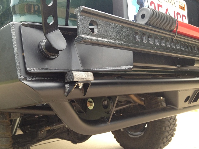

What is that welded on tab below the swing latch for? I see it's got a bolt and nut on it. Looks like some kind of foam spacer in between, too? Is it for keeping the swing out secure or something?

In a nutshell yes. It's a rubber block that's bolted on to keep the swing arm where it should be. I'll try and get another picture later today showing it better. It helps keep it from vibrating and moving up and down. Also the swing arm dips a bit when it's out and without the block it doesn't line up with the hole for the bolt/handle combo. And thanks a lot. I think I'm jealous of a couple of your goodies aswell! Mainly the geared part but I want a rear locker at some time haha.

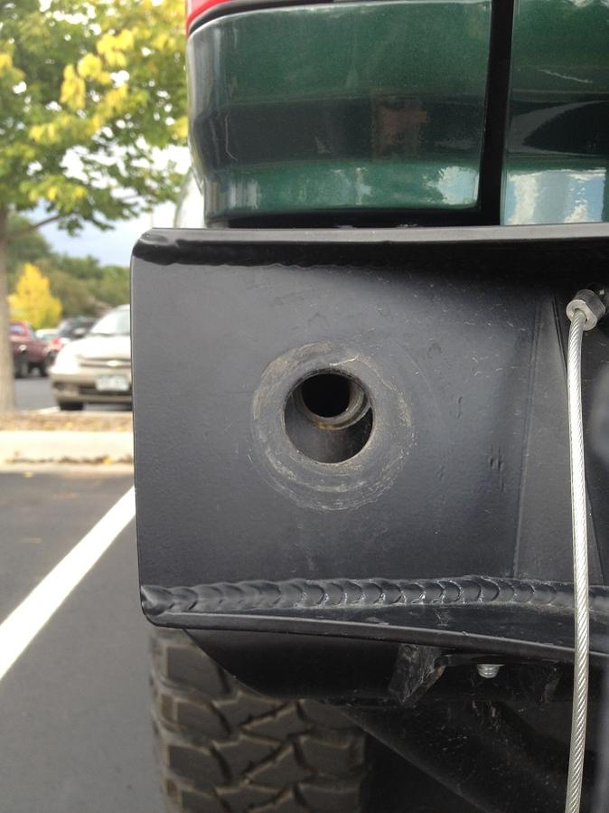

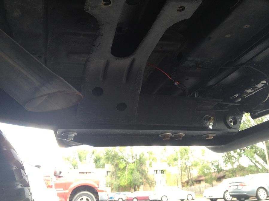

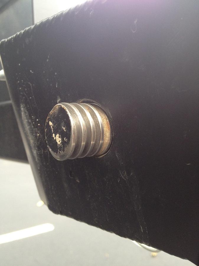

Here are some close ups of why that rubber block is needed and the tolerances in the bolt. Also grabbed a mounting bolt shot for good measure.
Mounting holes. There is one more bolt on the far side of the frame rail, close to where the wing support is.

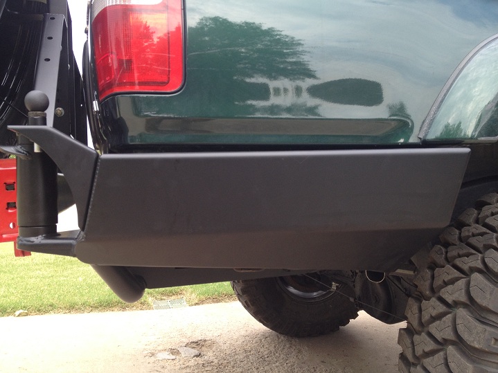

Swing away droop shots. Keep in mind its a full 33" tire, steel rim, and a high lift jack. Plus the swing away itself. The first picture is not quite the same angle because the swing away is not completely parallel with the truck or else it would be on the rubber block. It looks worse than it is.
This is the swing away with the bolt/handle put through it. You can tell how exact you have to be with the placement of the swing away hole relative to the nut for the handle

That's interesting that the swingout on your bumper sags that much. It's probably because it's about the heaviest version of the swingout that you can get... gas can carrier, full length, etc. More weight + more leverage = more sag @ the end. Plus that looks like a 60" Hi-Lift, right?
Mine doesn't sag at all, but it's 3/4 length, no can carrier, and I've got a 48" Hi-Lift on it. That little plastic part also serves to stabilize the outermost end of the swingout.
CBI forgot to include that part (surprise) when they sent me my bumper and it caused the damn swingout to jiggle just enough that it would work the latch loose on trails. I noticed the part on Ameining's thread, got CBI to send me one, and it seems to have solved the problem.
Anyway, the 4Runner looks great man. You've made a hell of a lot of progress in a short time. Great work, and I'll look forward to future updates.
This may be a dumb question, but do you have to screw in/out the handle every time you open/close the swing arm? How many turns of the handle does it take to disengage?

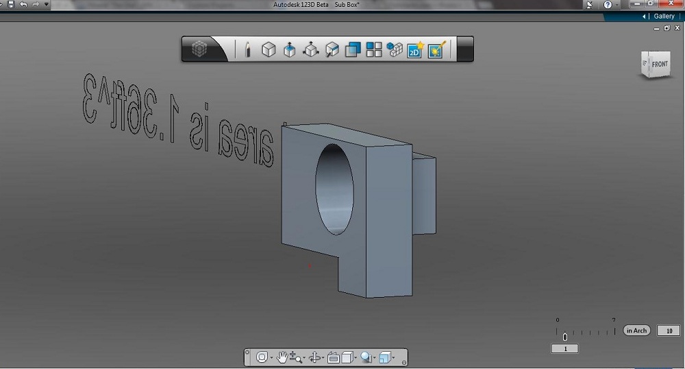

Thought I'd show off my simple CAD piece. No idea if the dimensions are right for over the wheelwell but I like the look
Yea you do. I thought it would be a pain when I first got it but its really not. And I never really count but probably 2.5 or 3 till its good and tight.
Thanks for the pics TCM. I'm quite surprised at the amount of sag too but like BFAD said, it's the largest of the swing outs and your extra weight adds up. I wonder if it would sag still without any load on it? I wonder if they could do a 3/4 swing with the Hybrid cus I wouldn't be interested in the can carrier and I have a 48" hi-lift as well. Might be a question for Nathan. I'm just worried cus I'll be sticking a big ass 35" tire up there and a jack as well.

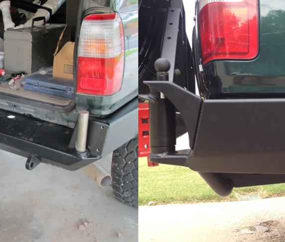

BFAD made me see something I didn't see before which is in this picture
I didn't realize that the spindle was just on a tab like this. IMO, this is pretty weak and I am very surprised CBI was happy with it. The bottom tab needs to be a lot more heavy duty than that. Hell it looks like a standard light tab. I think it's something that needs to be addressed. A small amount of sag maybe, but you're having a good amount of sag. At such a high price tag, I'm not ok with that. If you truly wanted to get rid of the sag you'd need to find a way to gusset the tab the spindle is sitting on.
I think most of the sag actually comes from how the swing away mounts to the spindle. There are brass rings that get press fit into the swing away and then that whole deal gets slid onto the spindle. That kind of system has to have a little play in it or else it wouldn't swing. That little bit of play extended out to the end of the swing away coupled with all the weight on the swing away makes up for the sag. I haven't noticed that tab bending at all. Also the top of the spindle is bolted to the main body of the bumper by that bracket on top.
Its worth a look though. The sag doesn't bother me (although it is like you said, enough cash it shouldnt) and like I said ill try and get another picture of it flush without the block because I don't feel like the first picture did it justice.
I guess you could be right about the spindle being the cause as well. Just doesn't make a whole lot of since unless they're different spindles than whats on the plated bumper. Even with a 3/4 swing arm it would sag a little if that's the problem. Next time you're back there put a small level on that tab that the spindle is on and see if it changes any when bringing the swing arm out. I still think it needs to be beefed up a little more regardless.
I went back and looked at the picture I posted of Ameinings bumper because I couldn't figure out why you thought the tab was the problem and realized that the way the spindle attaches is totally different. I'm not sure how I missed it before. I thought the plate bumper had the same thing just welded to a plate instead of a tube like mine. It makes much more sense that that would bend rather then how it is mounted on the plate bumpers. The idea with the level seems like genius to me. Even though its not much of a sag I want to know what the weak link is and maybe think of a way to fix it. I'm not sure I can gusset it easily without interfering with the swing out but we will see.
Side by side
