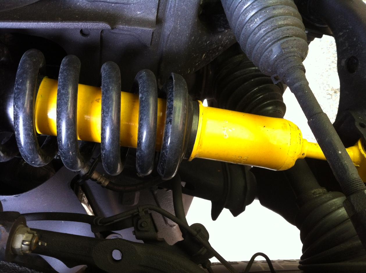

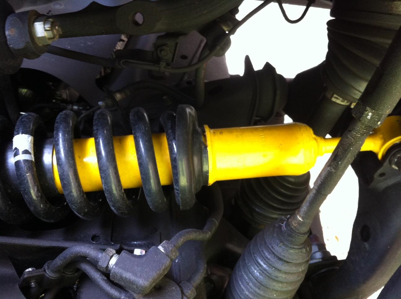

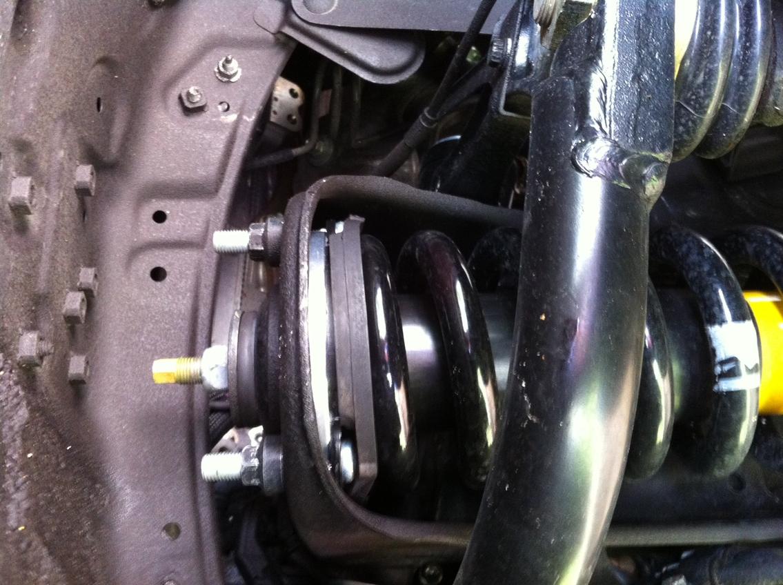

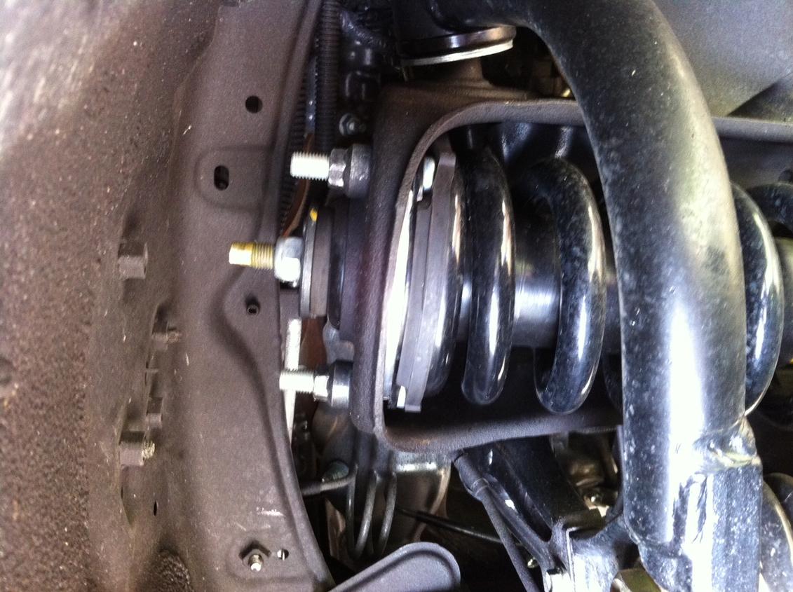

Ok, am I missing something? I can't find the spacer/ trim packer on either front shock (and I don't see any place it would be on the rears). Here are the photos of the shocks, the first two are the driver's side and the last two are the passenger's side.
