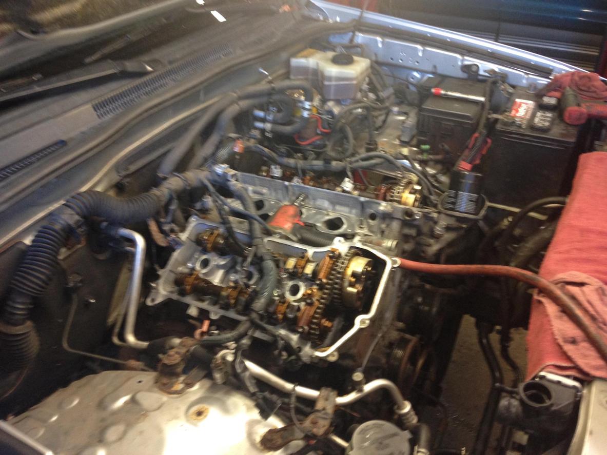

The service advisor sent me this picture when the heads got put back on. Can you guys tell which terminal post they disconnected? With the blurry picture and no truck to compare it to, I can't tell.
It concerns me a little that they have an impact wrench set on the engine, and another on the battery. Not that it's related to this particular problem, but with an aluminum head, aluminum block, and specific torque specs to be used I can't think of what they would have been using an impact gun on during that part of the reassembly process.

The vehicle has no voltage if either terminal is disconnected.
Not sure why you're worried about an impact being on your engine - what is the issue with using that to zip out bolts? I am a DIY garage hack and I use cordless impacts 95% of the time on my own personal car that slings me around a racetrack at high speed. I can't possibly see an issue as a result.
If it were me, I'd personally go check out the vehicle to get the full story and see the actual behavior. You can tell them you're not accepting the vehicle back if you feel there's a problem they caused, but test driving it doesn't mean you're accepting it.
I'm not worried about them using an impact wrench to take things apart, but this is the reassembly part where over torque can matter.
