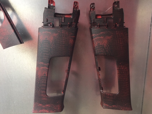

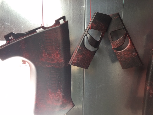

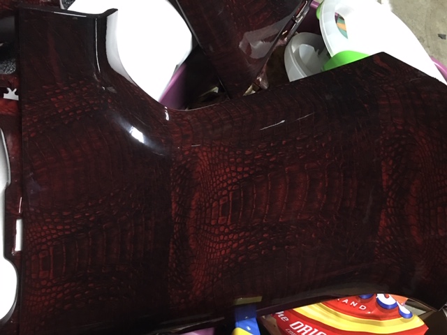

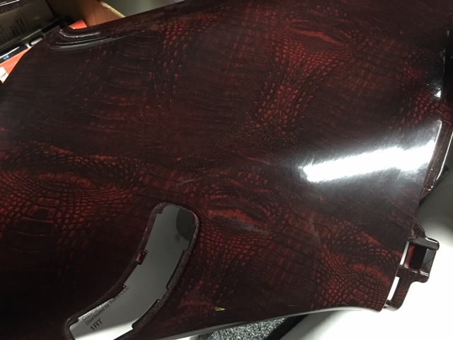

sneak peek at some interior plastic getting hydrodipped in red alligator skin pattern, no clear coat on them yet. Slowly getting rid fo that tacky tan colored upper interior pieces and headliner

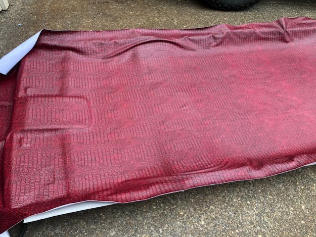

the headliner

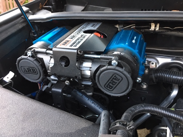

ARB compressor mounted, now need to plumb it and install air line fittings front and back

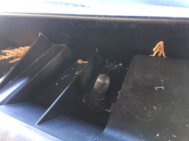

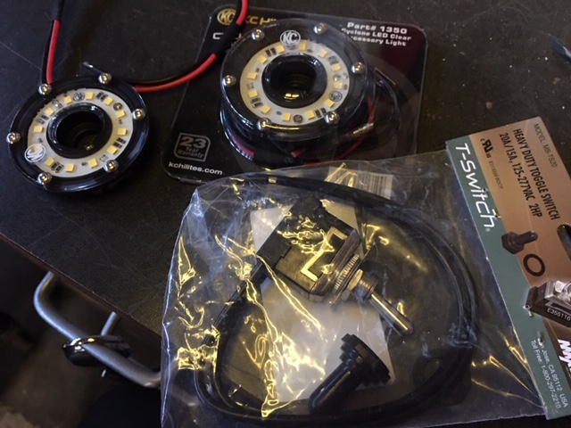

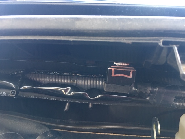

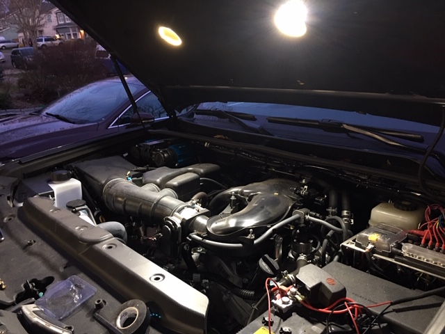

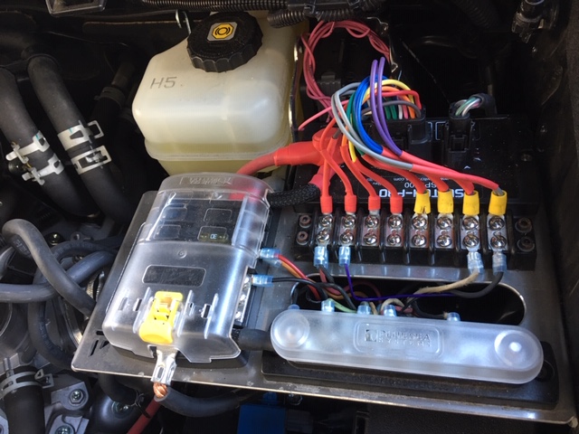

I installed a couple KC Hilites led's under the hood so I can fix stuff in an emergency at night or whatever. They are bright! I'm contemplating using these as extra rock lights in strategic spots under the vehicle too.
I ran the on/off switch and mounted it right on the cowl panel since its a waterproof switch with a rubber boot. and ran the wires to my add on fuse box next to my switchpods unit. I didn't wanna waste a fuse spot just for th hood lights since they are low amperage and would only be used for emergency fixes and such so added onto a fuse for another light on the vehicle.

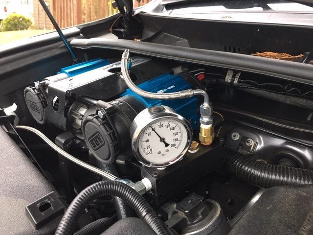

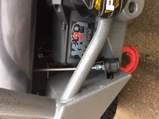

I also finished installing my air manifold for the compressor and plumbing lines. I havn't run a line to the rear yet.
But you can see how i decided to mount the front quick connect air fitting. I can just hook a hose up in front bumper and air up tires or whatever.

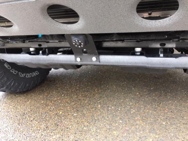

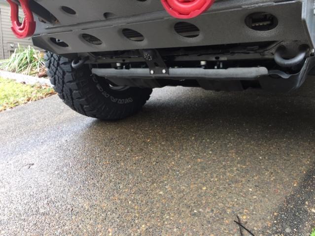

Installed a Summitview rock camera underneath front bumper so you can see over the edge of a drop off or rocks you might hit etc... running into the extra video input of my Kenwood headunit.
I went and bought some universal bracket at the local farm store, cut it down drilled some holes and bent an angle into it. I didn't wanna drill into my freshly powder coated bumper so i figured this was a good alternative. and easy to change or modify like when I get better skid plates later.

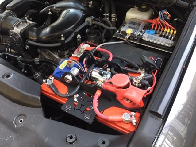

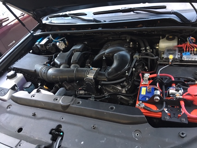

I also finished installing my Genesis offroad dual battery system today. It was a bear moving factory wire harness over to get things into position but finally finished it up.
It's a smart system so it disconnects the cranking battery if it drops below 12.7v when car is off. Then once you start vehicle once it sees the cranking battery above 13.7v it reconnects the second battery and starts charging both batteries again. So accessories can run off the secondary battery while car is off while still maintaining the cranking battery to start later.
Genesis Offroad Toyota 4Runner Dual Battery Kit
And yes I am aware of peoples opinion of weight with 2 batteries but you can see all the other corners under the hood are full with other things so this was the best thing to do I think. I talked to the owner and he says its never been an issue.

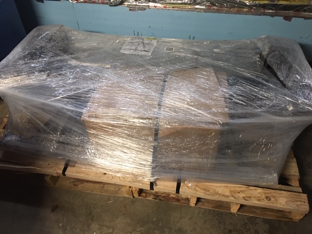

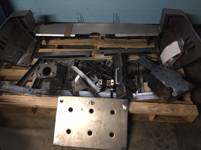

My C4 FAB rear bumper arrived today, about wore me out just unpacking it from the pallette LOL
Now to start sending pieces off to the powder coaters
