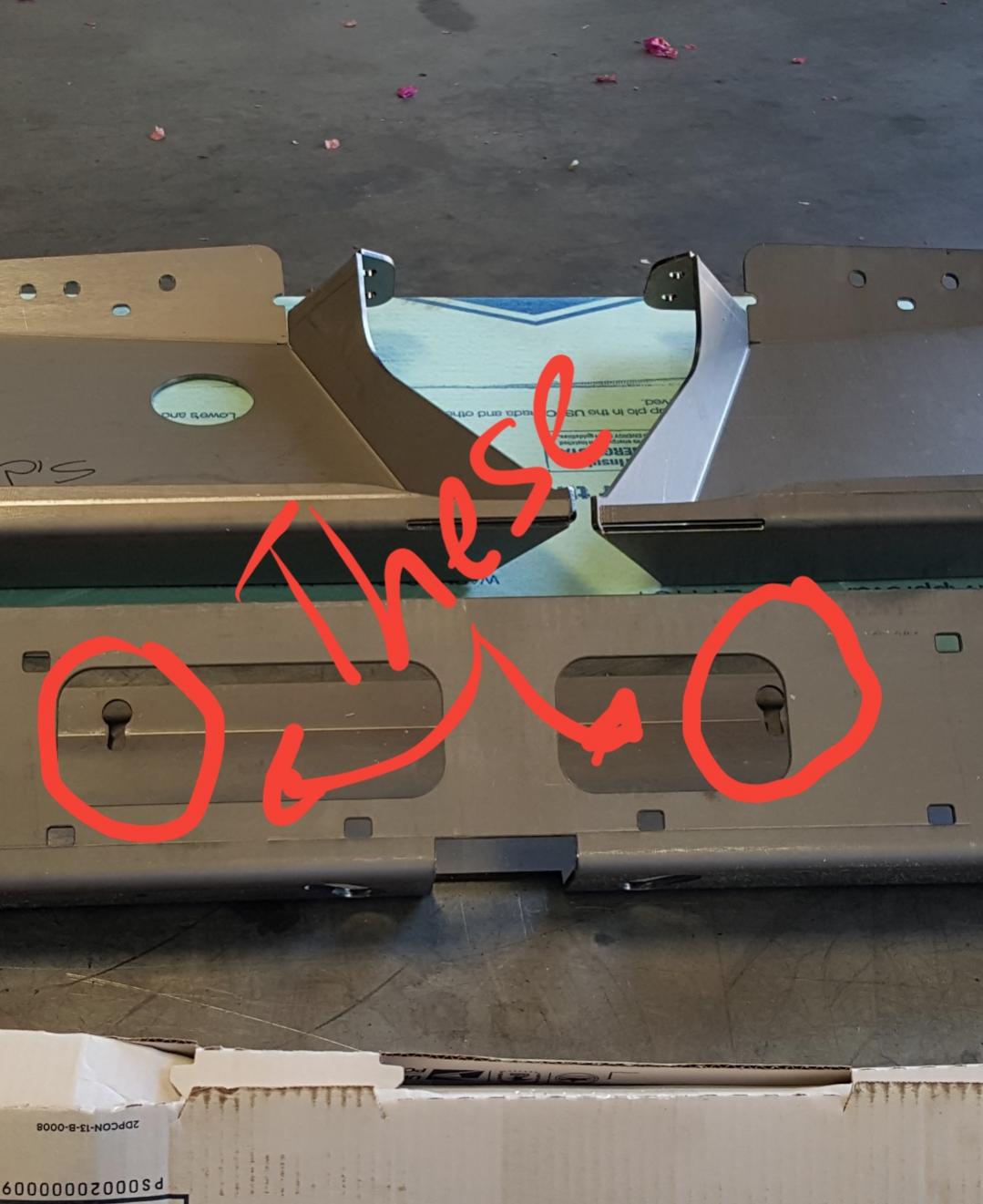

Yep makes dollars and cents. Looking at the rear bumper skin it would appear that Keith put in some access holes for a shallow 1/4 drive socket with a extension to pop those bolts out, but I could be wrong as I don't have it installed yet. I'd snap a pic but I'm about to jump in the shower. Maybe [MENTION=28464]eimkeith[/MENTION] can chime in on that. Otherwise I'll just cut the nuts off lol. Or reverse it, weld the nuts on the straps and do up the bolts from the top.
I totally agree, strip all the coatings off the nuts and burn those puppies in! No pansy tack welds!
Edit I did have a pic! Slots circled.

Looking at the rear bumper skin it would appear that Keith put in some access holes for a shallow 1/4 drive socket with a extension to pop those bolts out, but I could be wrong as I don't have it installed yet. Maybe [MENTION=28464]eimkeith[/MENTION] can chime in on that.
Yep - those holes & slots are for socket head cap screws to go in from the bottom. Once the receiver assembly is installed, I don't think you'd be able to access the tank straps from the top.
