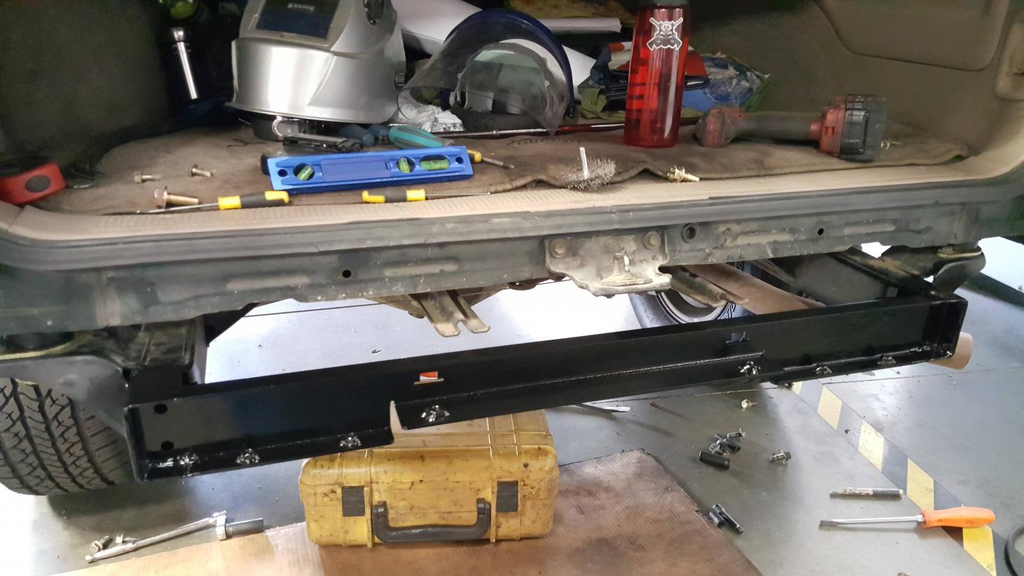

Here's another ass shot lol. Ended up just putting the nut strip in then welding it up and then bolting down the nut strips untill I get the bumper installed.
