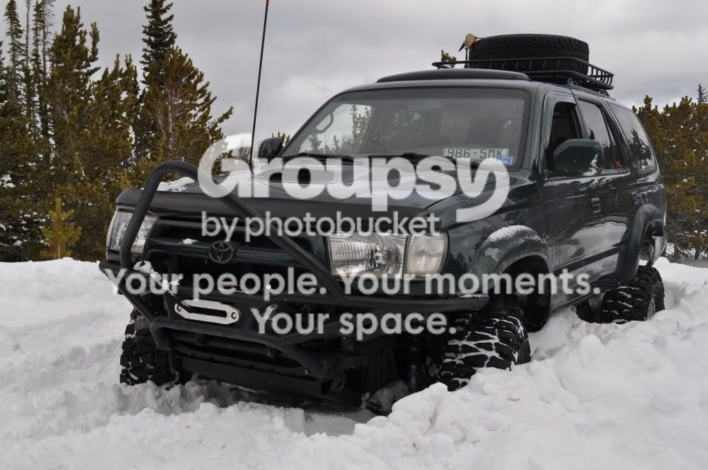

Where did you have to trim? I am planning on 35's soon and i need to be able to clear them at full stuff. ErikB's bumper is my favorite too. Check out 00Spork'd if you havent seen it already. Basically ErikB's with a stinger

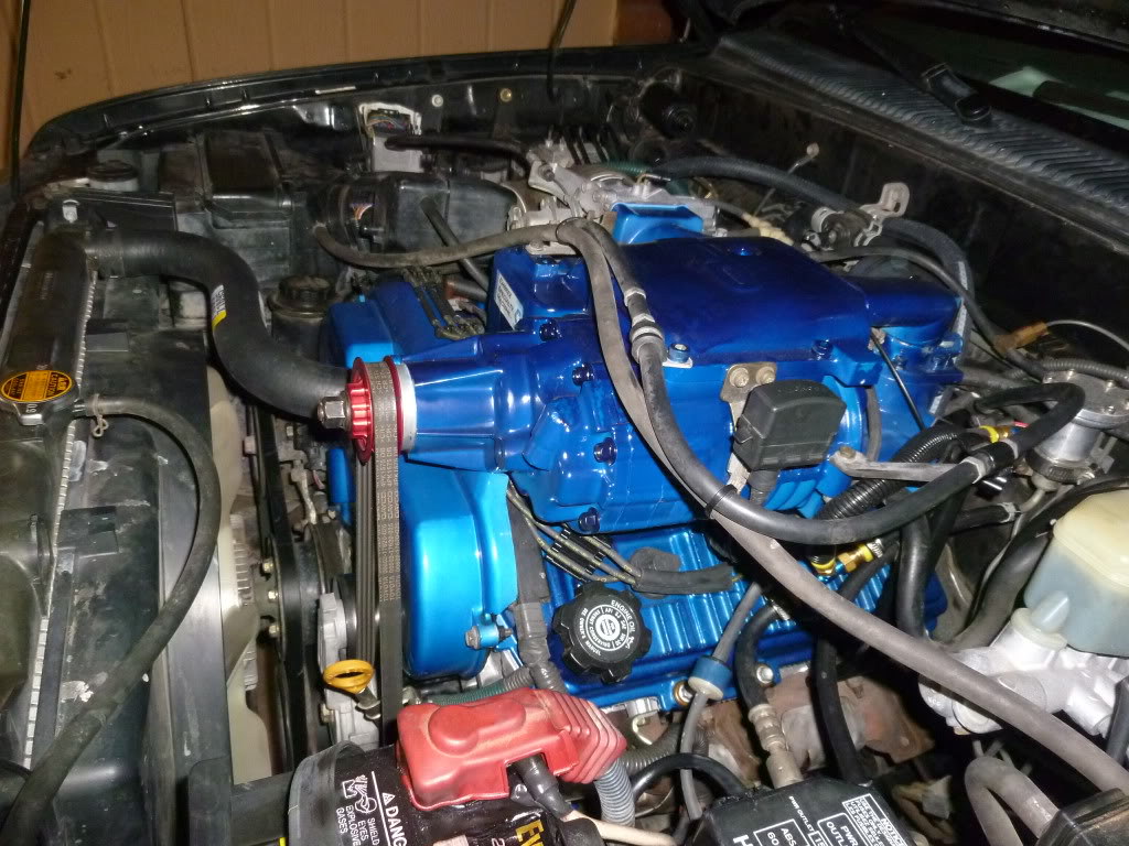

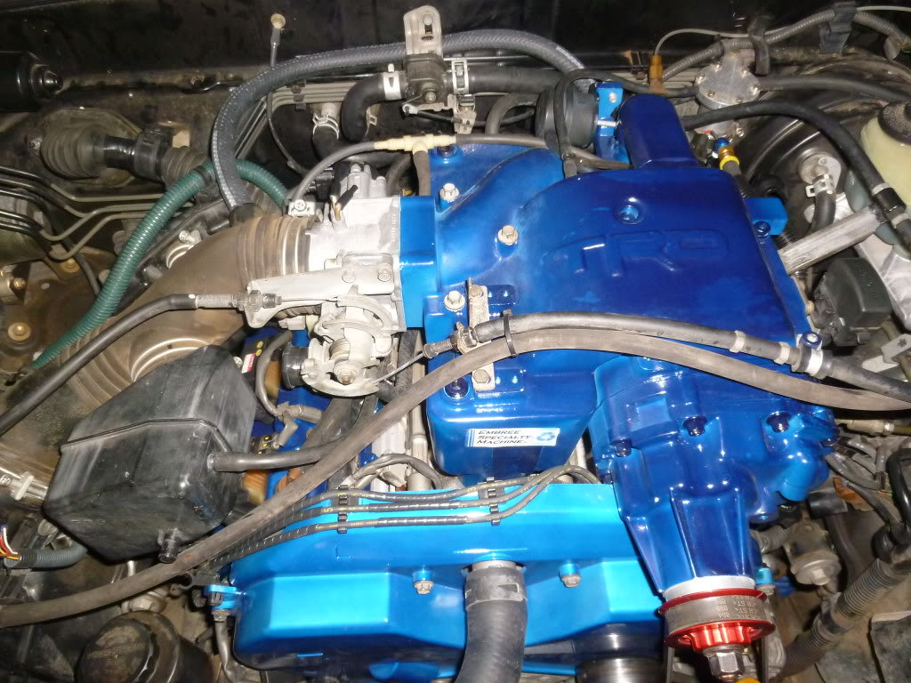

just a quick update. The engine is back from the machine shop and the supercharger is back too. Things are almost bolted back together and the URD 7th injector setup is wired in, with weatherpack connectors in case I ever need to remove the wiring harness again. sonically cleaned and balanced injectors, new belts and hoses, new 2800lbs pressure plate with ceramic friction disk. It feels like the truck is gonna be new from the firewall froward. My mechanic is doing an amazing Job and is totally meticulous. I think it will be back in the truck in the next day or so. I can not wait till it is running again I love driving my F350 crew cab but the mileage is killing me 8-9mpg. I will never complain about my runner again. I will have pics tomorrow.
Well here are the Pics. i have to say that I personally have never driven a 3rd gen that runs this smooth and absolutely powerful. I'm sure they are out there I just haven't had the privilege. Starts on a click and runs good with no ping all the way through the powerband. I am taking it easy on the motor for the first 500 miles till I have the first oil change and the new clutch is fully broken in. Not that pictures do much but I did get a little carried away with the rattle can. My best friend says its "So Ricer", but I like it.
