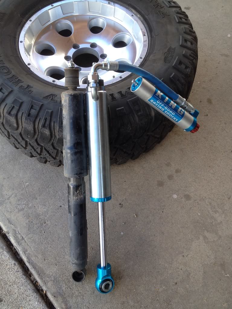

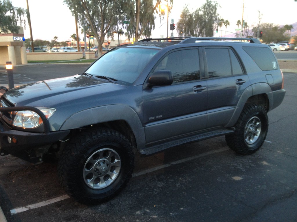

So we put a full Icon vehicle Dynamics front and rear suspension on my wife's 4th gen and man is it wicked nice. So she had to drive smokey for a couple of days while I was getting alignments and such. She decided that I needed better rear shocks and who am I to argue :biggrin2: So I found a set of used king 2.5 remote resi shocks with compression adjusters for a FJ Cruiser. They fit perfect with the 8 wraps. They took a little work to get in and have the remote resi mounted and I will improve on the location in the future. I have to say they ride amazing and I can't wait to put them through their paces.
they are about 1.5" longer than the LC shocks they are replacing.

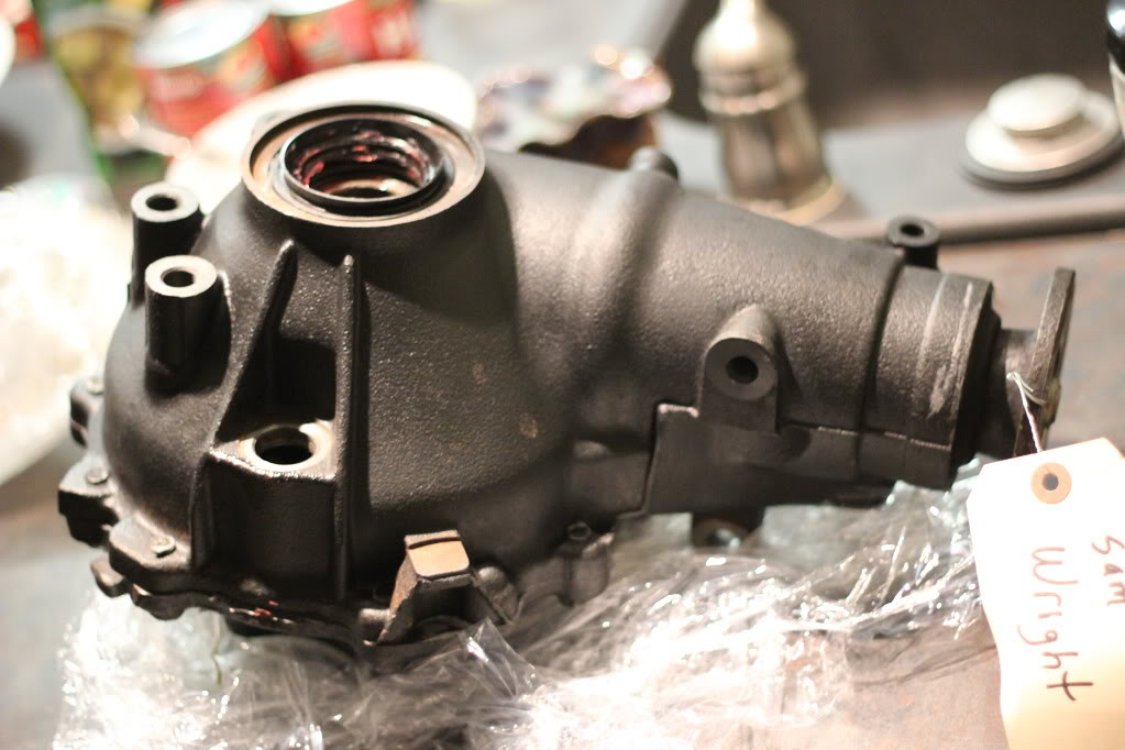

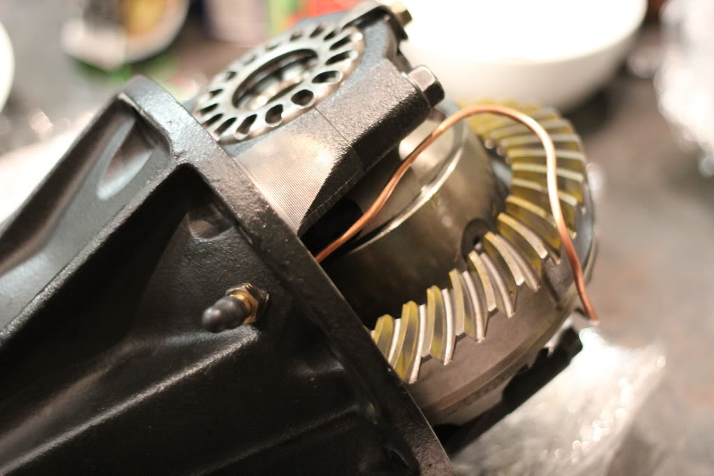

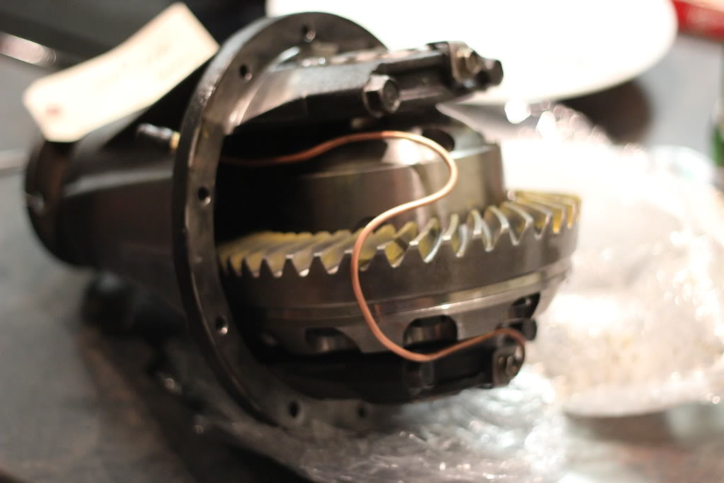

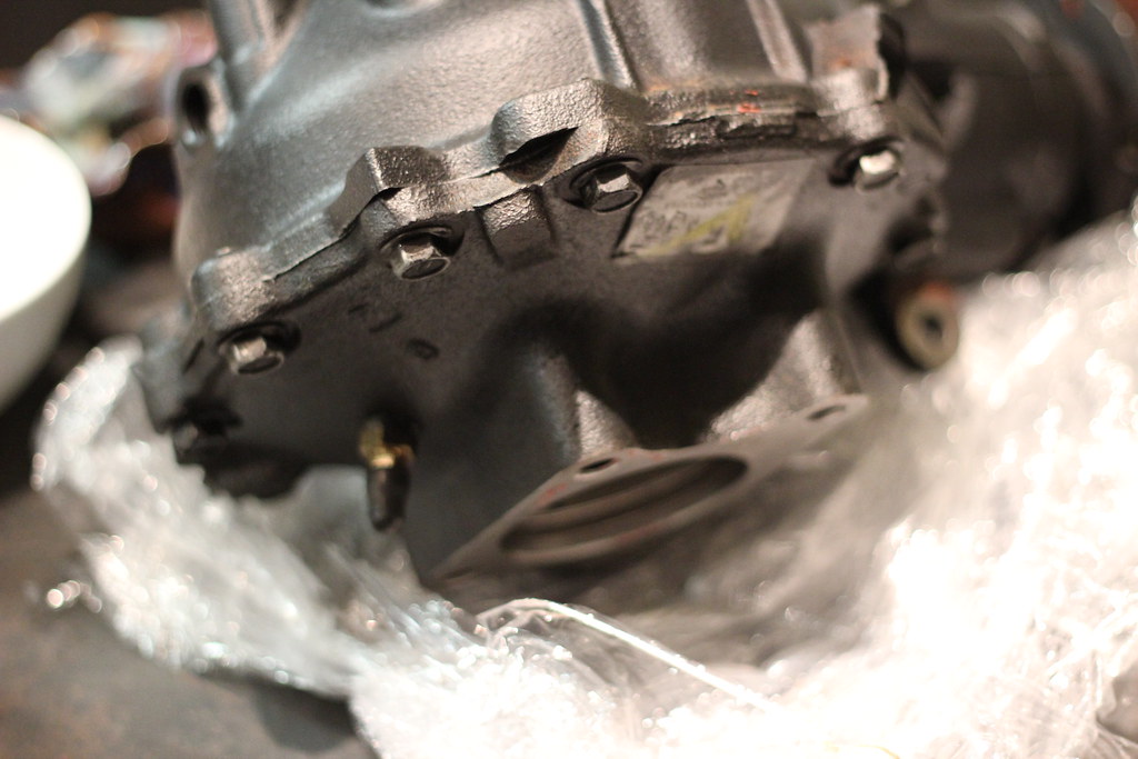

Front and Rear third's loaded with 4.88's and ARB Air lockers. Woo Hoo
These are going to go in together. It is going to be a long day but totally worth it.

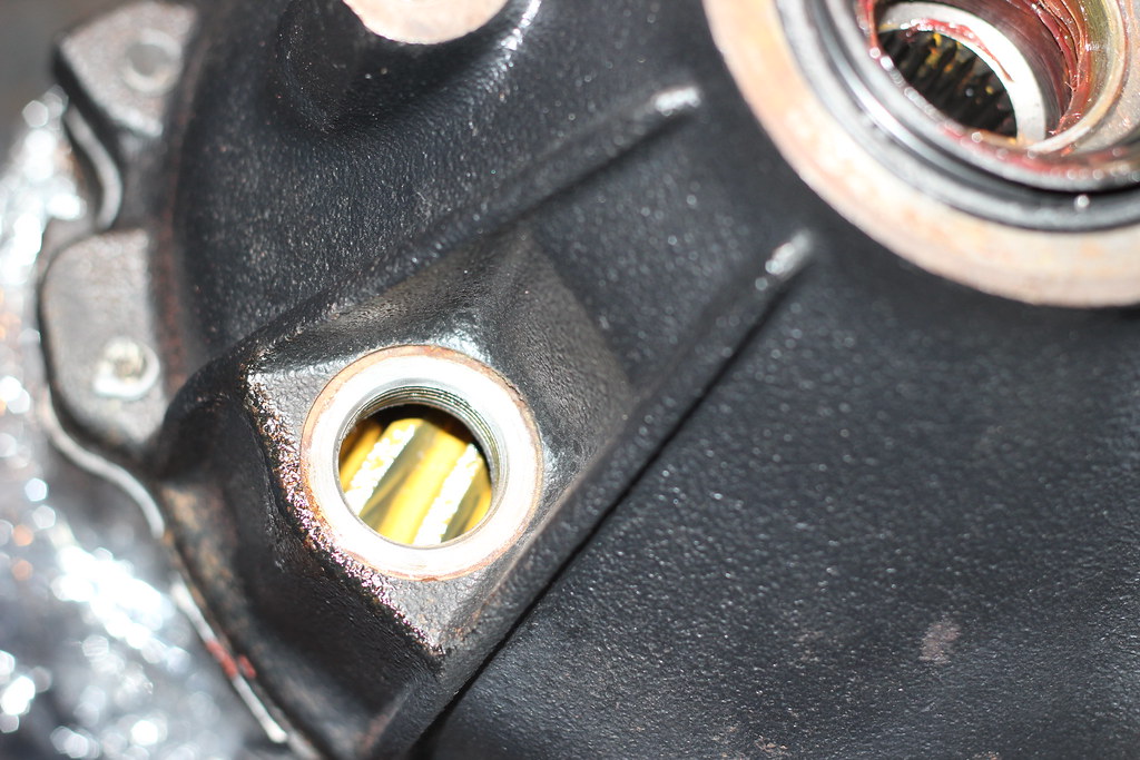

LOL that is exactly what happened. I posted, then opened them and put them on the kitchen counter looked at the gear pattern opened all the little boxes and looked at everything. Took some more pictures of them on the counter. went out and layed under the truck and just looked at it. I came about an inch away from putting the rear third in. Would have been easy too since I can now change the rear diff without having to bleed the brakes. Wicked nice part of the rear disk conversion. My wife kept laughing at me and finally went to bed and left me to play. I laughed when I read the invoice that says I have to send my cores back within 3 weeks. Heck I already have the rear core boxed and ready to go. LOL. NO WAY I could look at these for three weeks, they are going in dang it. :driving:

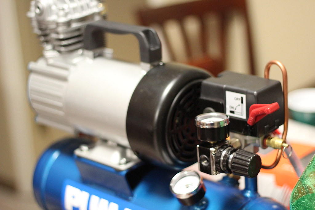

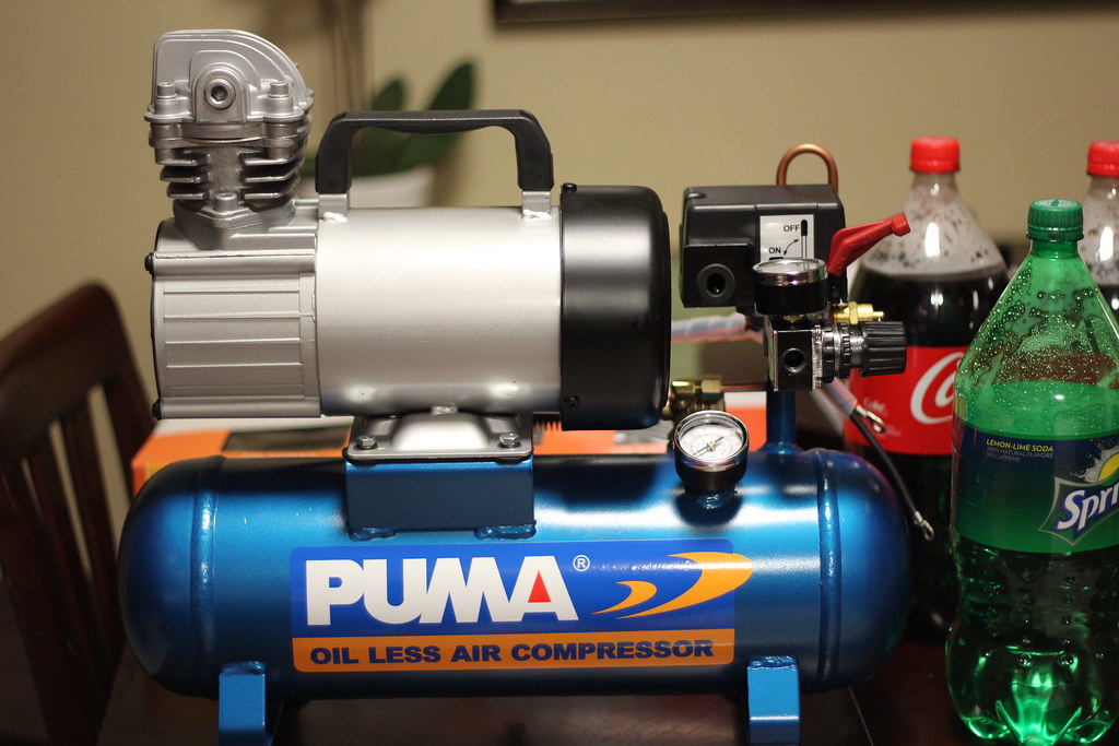

And today my new Puma 12v 1horse portable Air compressor came in. Gotta have air to lock those ARB's.

No kidding, you'd go mad! And not only is that a bad ass compressor, but I am confident that it has on it's surface the "Ultimate Horsepower Adding Sticker", even if it is just one.

I agree. I feel like I've read every thread on OBA and 12v Air compressors I could find on here, Mud, pirate, TTORA you name it. I feel very confident that it will work great. I am going to separate the tank and build a little mount in the back cargo area. A friend recently gave me an old construction Air compressor twin tank set up. I am going to mount the tanks under the rear where the spare was and then plumb from the interior to them to a dryer to the ARB's. Also will put a manifold in and put quick connects front and rear so tires can be filled and even run air tools in need be out on the trial. With a 100% duty cycle it should have no problem with anything I can throw it.
