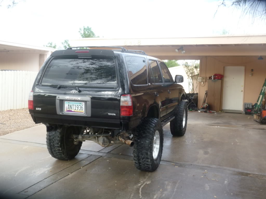

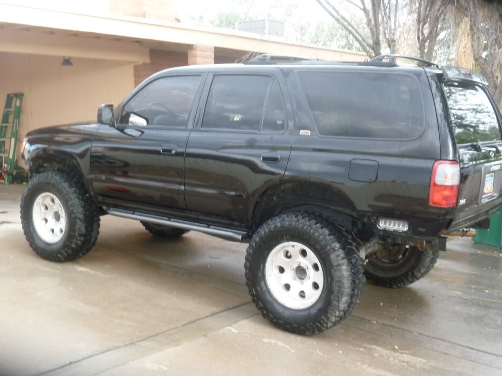

Nice work, it doesn't look too bad, but you should have gone with the NGK spark plug wires that come in blue. You get your lift on yet?
Thanks Guys it's gonna be a great ride
I never thought of the NGK's, Honestly Gadget told me there is really no advantage over the stock wires. Except now I know that Color is one. LOL. Front kings are on still need to get the rear coils and shocks in. then Panhard drop bracket.
Dang. That would be a hard 500 miles! Looks great and sounds like it drives great too!
It's gonna be super hard to be good but I really want this motor to last for a really long time so 500 medium easy miles and 150k + Wide open fun.:thumb3:

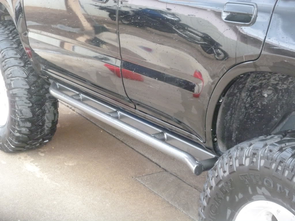

And now some of the sliders. Thanks Scotty for building a great product. Because I don't have flares I cut down the legs to bring the square tube under the pinch weld. I used a thick washer as a spacer and it is just right for clearance to make sure the body doesn't hit the sliders. I have to say that I think they are the best sliders for our 3rd gen runners out there.

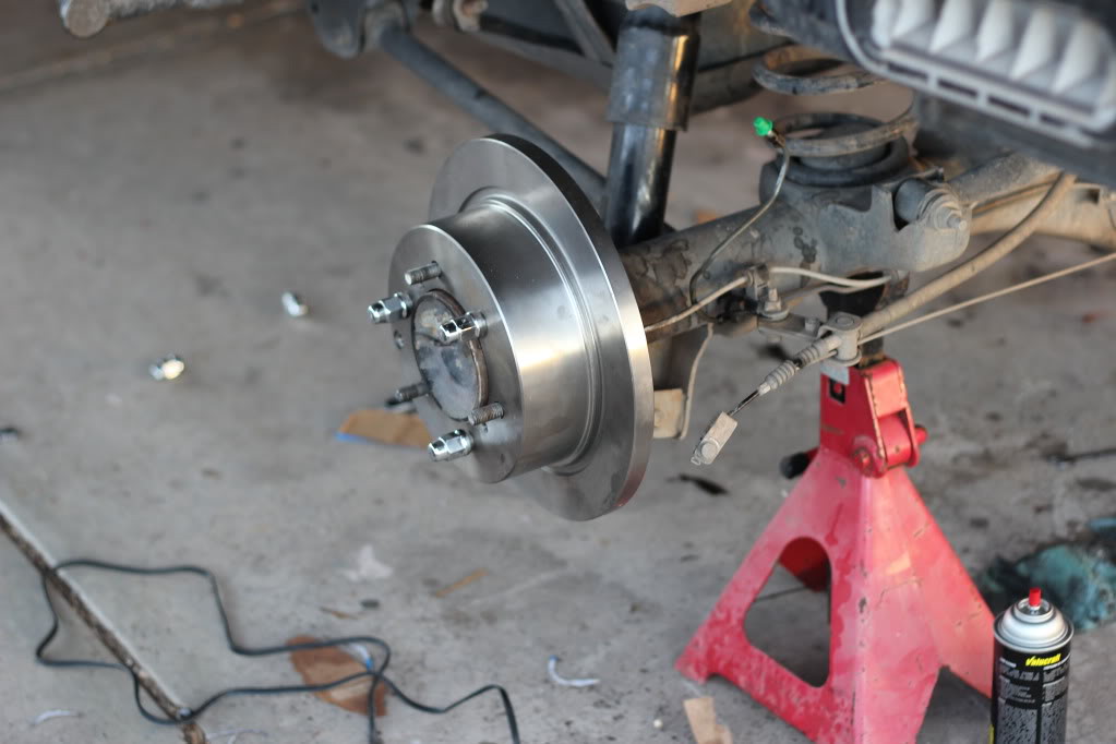

So for the last couple of days I have been working on a project. I have really been going back and forth on what gear ratio to run I have two extra 3rd members one 4.88 and one 5.29 So I decided that I would throw one in and drive around for a while and see if I like it. I have needed to replace my rear axle seals for a while now and so this was a great chance. I also got a wild hair about doing a rear disk conversion. Based on a 1st gen pirate thread I began to do a lot of reading and research and I felt that I had enough info to tackle this on my own. I wish it was that easy but here I went.

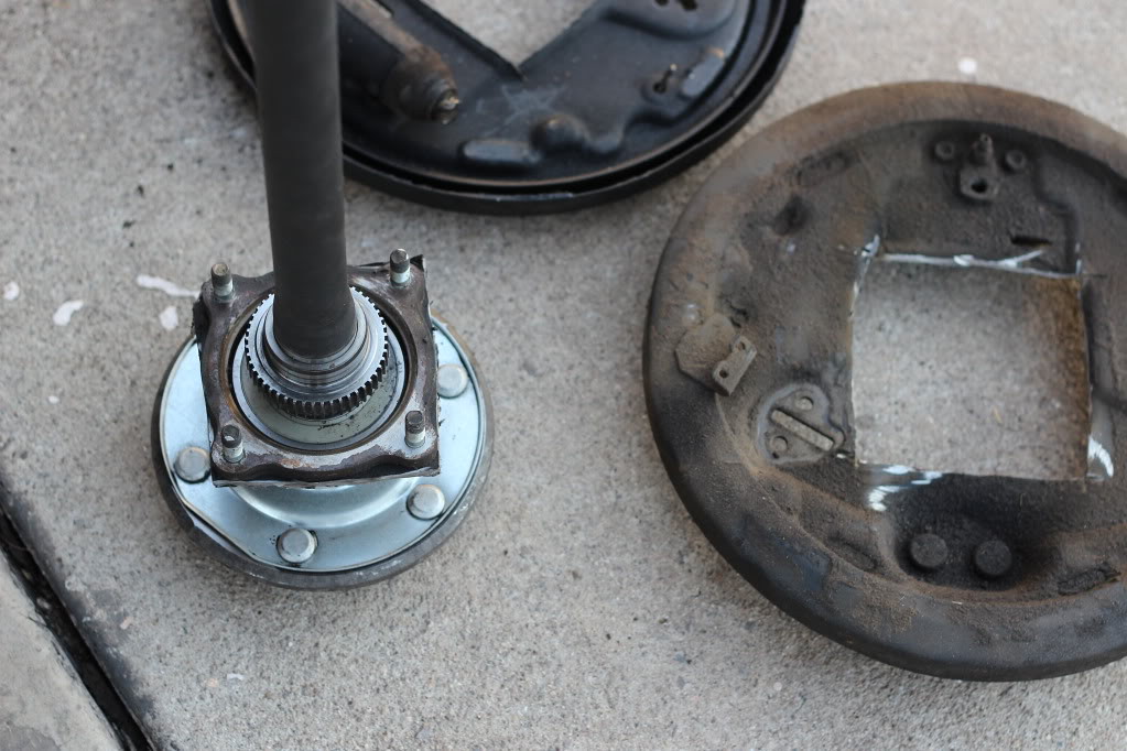

First pull the axle shafts and do axle seals. Done :tongue:
Next use a cutoff wheel or plasma cutter, or torch to cut around the mounting flange taking care not to put too much heat into the bearings and keep a fire extinguisher handy. rear axle oil is flammable.
Rear Disk Brake 1 by Sam Wright, on Flickr

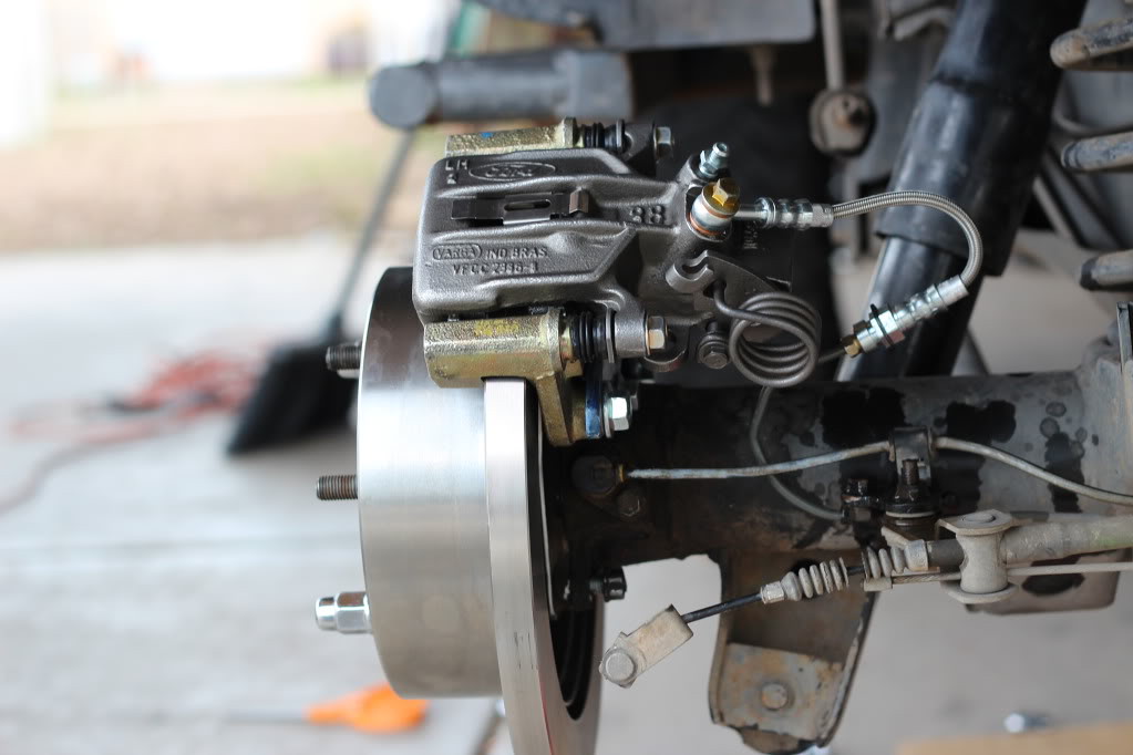

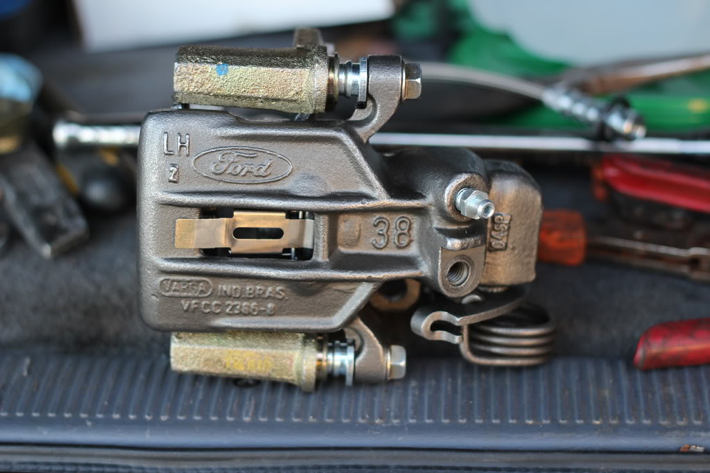

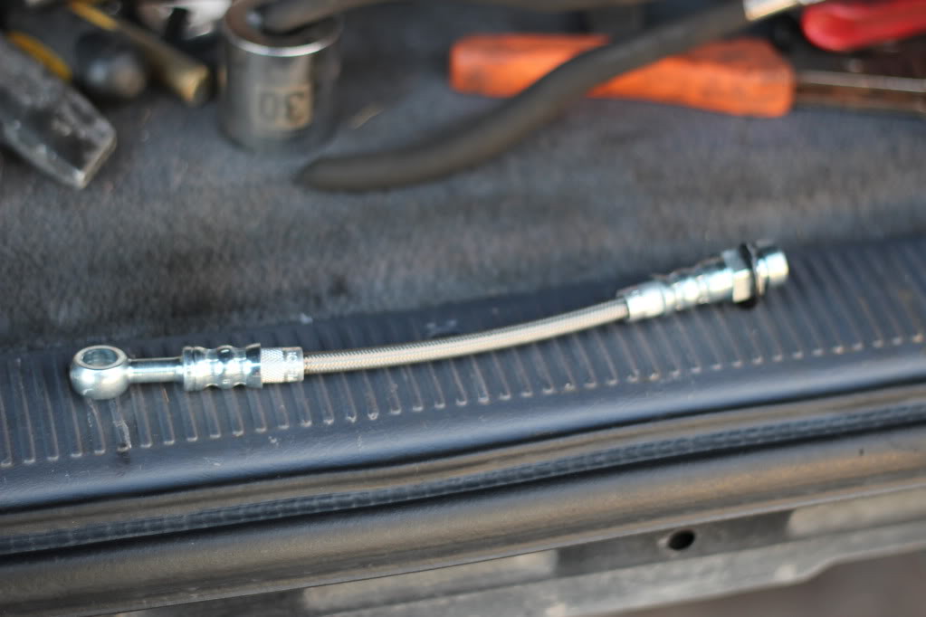

I used the following parts. brake rotor from the rear of a 94 Montero Sport. Rear Caliper from 94-04 Mustang Gt. Custom flex line with banjo connector.

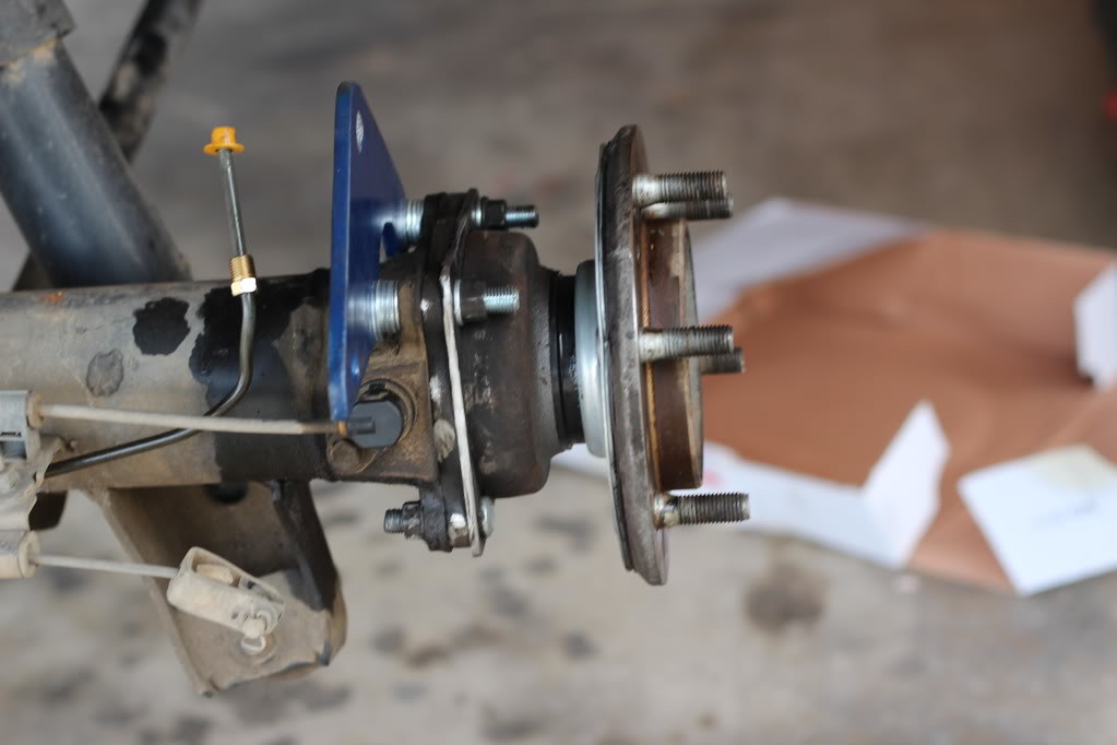

Next you have to remove 2 of the axle bolts. We used a air hammer, but it is possible to install the axle shafts and only bolt in the bottom 2 and then drive out the top 2. These will be replaced later.

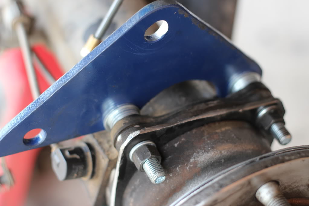

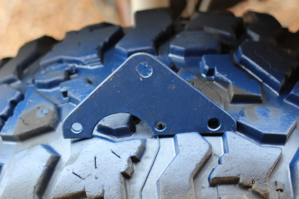

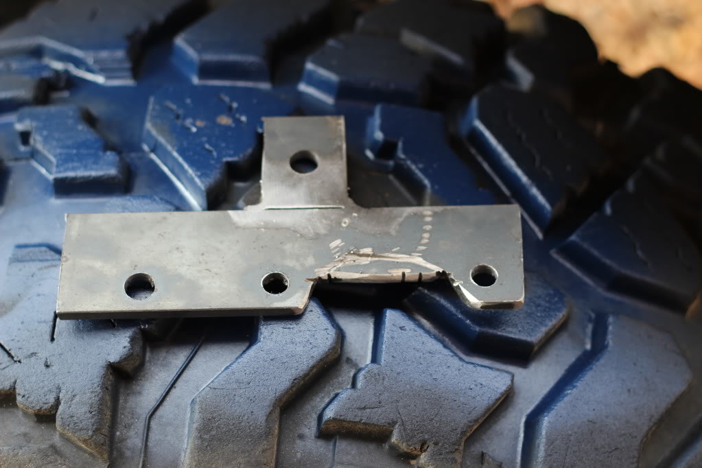

Then you have to build a bracket to hold the caliper.

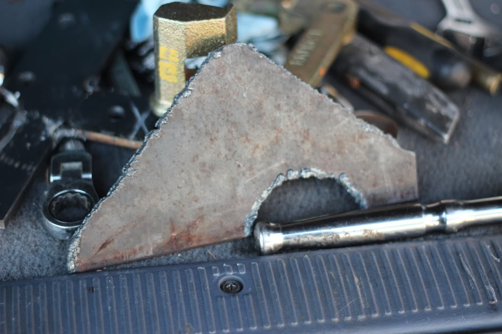

Here is my prototype
Rear Disk Brake 20 by Sam Wright, on Flickr
Here is the torched bracket made of 1/4" plate
Rear Disk Brake 4 by Sam Wright, on Flickr
cleaned up and drilled and painted
Rear Disk Brake 11 by Sam Wright, on Flickr
Now you have to shim the caliper bracket so the Caliper is centered on the rotor.

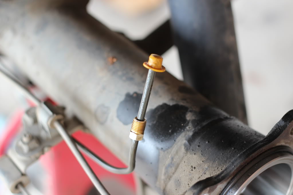

I cut and reflared the hard line to create a better angle for the flex line.
Rear Disk Brake 9 by Sam Wright, on Flickr

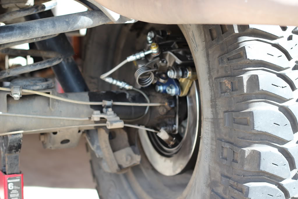

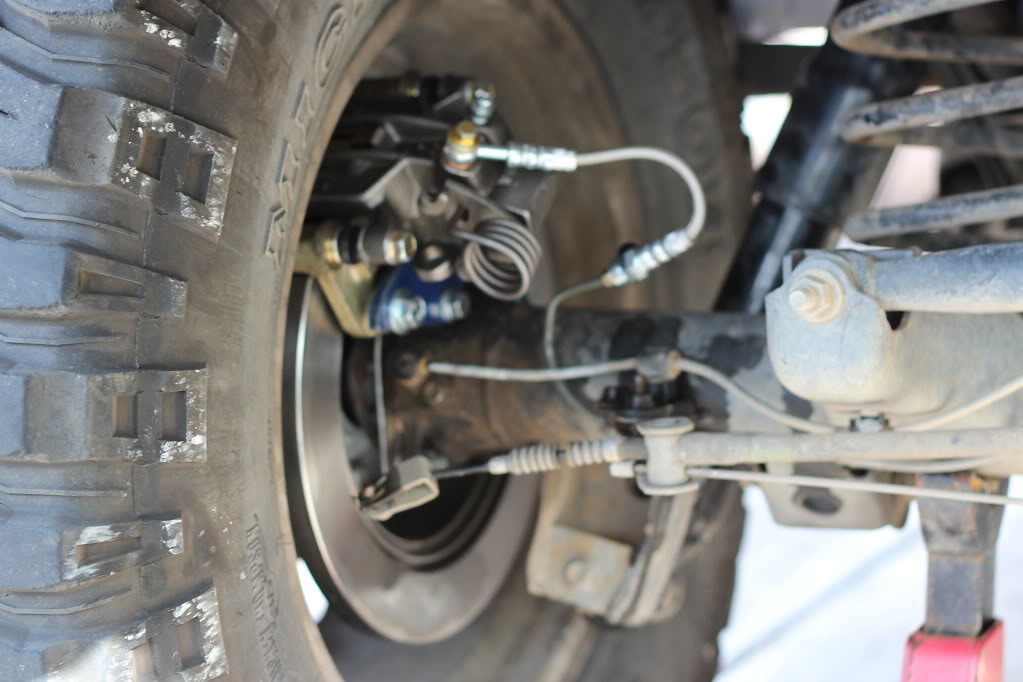

Bolt it all together, bleed the brakes and there you go.
Rear Disk Brake 10 by Sam Wright, on Flickr
Reinstall the tire and enjoy extra stopping power, Brakes that don't cake up in mud and snow, and you can work on the rear end with out cracking open the brake system.
Rear Disk Brake 16 by Sam Wright, on FlickrRear Disk Brake 15 by Sam Wright, on Flickr
I specifically chose the calipers because they have been around forever and I should have easy access to parts. Also the mustang weighs a little over 3000 lbs and so I thought that they would be a good balance for the front 13WL's. And they have a mechanical parking brake.
