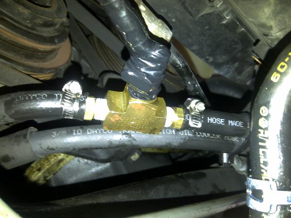

Did this awhile ago..
This is something I feel is essential, if you tow and you've by-passed the rad tranny cooler. I found I needed to increase my cooling capacity after the first season and without a temp gauge I wouldn't have known---- and overheated my tranny!

I just went with the Dakota Digital Block which made for an easy and clean installation. I also like it over the Autometer Block because this allows me to add a ground wire. FYI, the reason why I mounted it upside down is because this prevents air pockets forming around the sensor which can give you an inaccurate reading.

Mounting it upside down seems like a good idea. Although, since the line is under pressure, I doubt it would ever have an air pocket in it but it doesn't hurt.
Autometer also makes a block like the Dakota Digital one. The directions state to mount the sensor downwards. When I actually called Autometer, they said it was for a more accurate reading because of air pockets.
