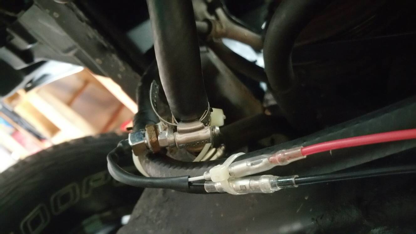

I just went with the Dakota Digital Block which made for an easy and clean installation. I also like it over the Autometer Block because this allows me to add a ground wire. FYI, the reason why I mounted it upside down is because this prevents air pockets forming around the sensor which can give you an inaccurate reading.
Sorry but, never seen this block thing before your post. What is the benefit to that? My setup doesn't have one with my sensor.
I ended up using a combination of T's and fitting for the sensor. Actually, I have a dual sensor setup so I can see temps from pre & post tranny cooler on the same gauge.

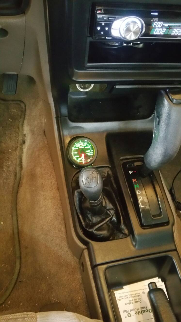

I have a few pics here http://www.toyota-4runner.org/3rd-g...ou-do-your-3rd-gen-today-687.html#post1984964 , and here's a night shot of my AutoMeter Gauge.
How do you differentiate pre and post cooling with 1 gauge? Am I missing something from the pic? :P
Here it is in all its glory. Wasn't hard at all to install.
I like the clean setup of the block and best of all it has a screw for a ground which you need for an Autometer. Our setup is unique since we are not attaching the sensor to metal hoses which would have a sufficient ground.
He has two sensors, one for intake and another for output. He probably has a 3 way switch so he can monitor the different temps with one meter. Pretty ingenious if you ask me.
I have a 98 which does not have a factory sensor. This block allows for an inline manifold for a temp sensor that comes with the Autometer. The sensor needs a ground which the block provides. This makes for a clean and easy install.
