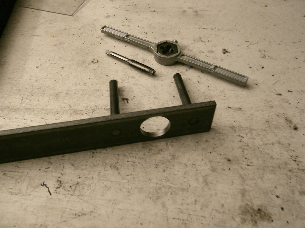

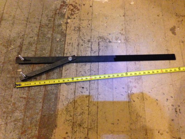

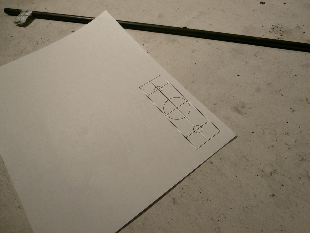

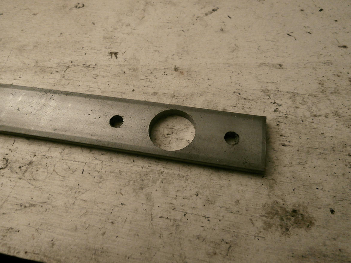

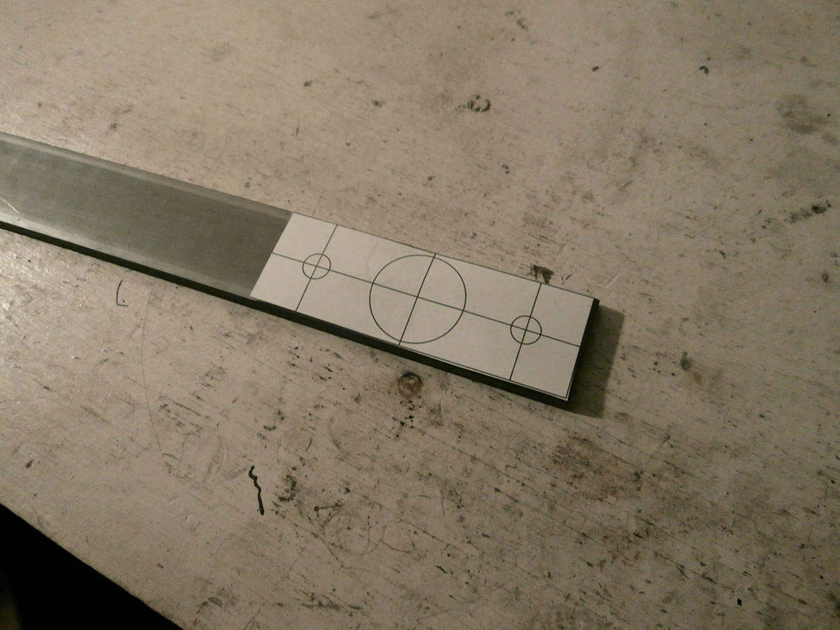

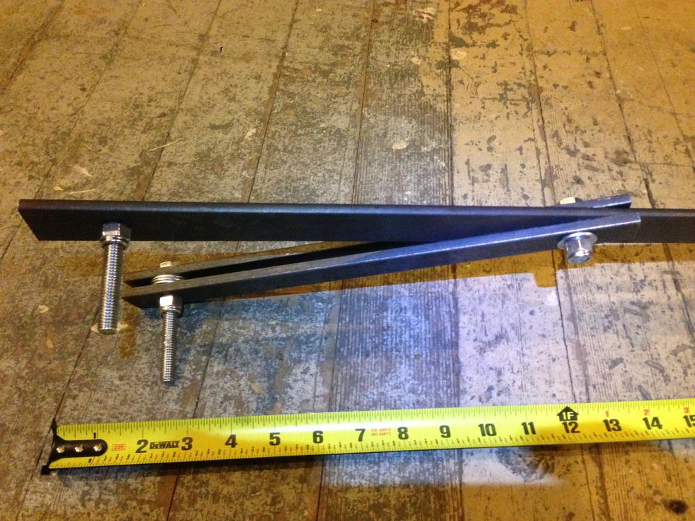

For my crank pulley tool, I measured and made a template to print out for my home-made SST. I got a 4' long piece of steel from Lowes or somewhere. Printed a template and bonded it to the steel. Cut pilot holes, then cut full sized holes. Tapped the holes and threaded corresponding steel bar to thread in. This is where I would use hardened bolts as opposed to soft steel. For a one-time deal, they worked great. To use it again, I'll need bolts or something a bit more stiff.
It worked very well. The only modification I would make to it is to use hardened bolts instead of soft metal, as they bent a bit when the torque got up into the 200s.
