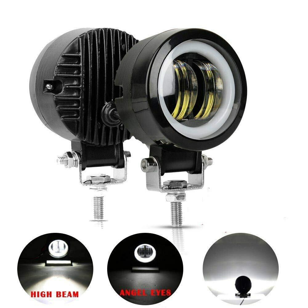

I decided to use the two inner most holes for road fog lights, activated on the steering column tree.
These are less than 2" front to back, so will fit in the space in front of the winch. At 30 bucks, I'm not expecting Baja Designs quality, but we'll see...
