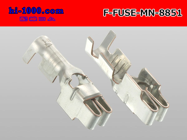

Finding them domestically doesn't look so easy. Think this would work for a single?
https://global.rakuten.com/en/store/auc-hi-1000/item/f-fuse-mn-8851/
Tony, I'm pretty sure these won't work. The back is different, and it won't properly snap in place in the fuse box.
