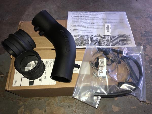

This showed-up a couple weeks ago:
Still need to figure-out what I'll do in the rear...
Also got this:

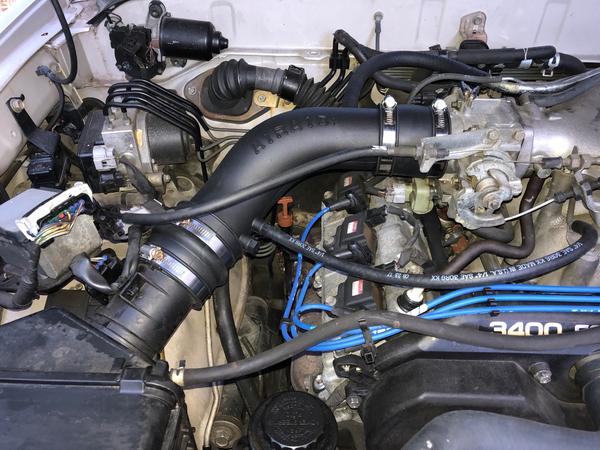

And since the install is easy/fast...
I didn't do this for any possible performance gains or even throttle response improvements. I like to pull spark plugs periodically for inspection, and this will make that faster. For me, it's worth it. Aesthetically, I do prefer the less cluttered engine bay too... Sound-wise, I have not detected any difference, at least with normal driving.

Where you get the airaid from, I didn't know you could get it without the filter
Slobo, yes, sold, tube only. I just checked, and it was from Low Range Off-Road. On some discount for about 100 bucks...

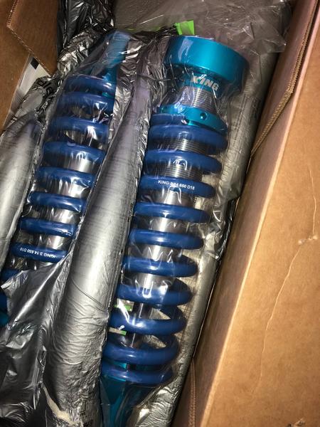

This came yesterday.
Need to finish the winch install (electrical connections), the attic rack and then get back the install of those various Baja Designs lights and the switch box below the driver's seat...
