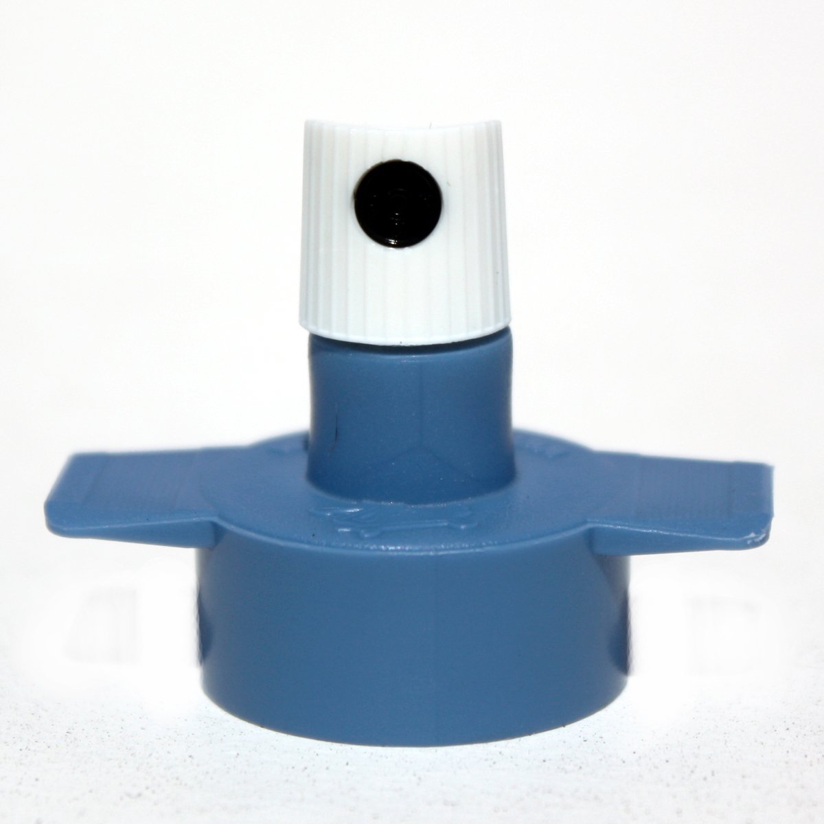

Anyone know what brands of spray paints still use the old style male nozzles, like this?
I'd like to keep using these Eastwood wands and nozzles with other paints...
EDIT/ADD: Called a few local stores and none sell spray paint with those old style male nozzles, just the newer female ones (can has male end). So, I have some of these coming on Friday.
While I'm sure the Eastwood internal frame coating is great stuff, this allows me to spray other paints and coverings too...
So, I got those spray paint nozzle adaptors, and they were exactly what I hoped. I was able to use the Eastwood wand with the usual Rustoleum flat black spray paint I've been using...
